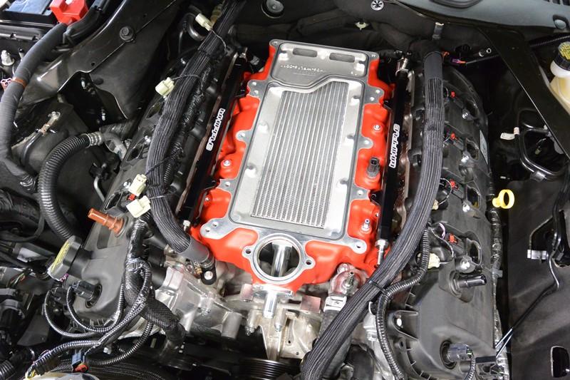

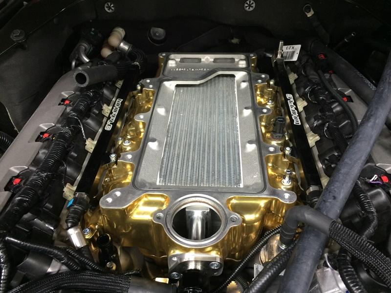

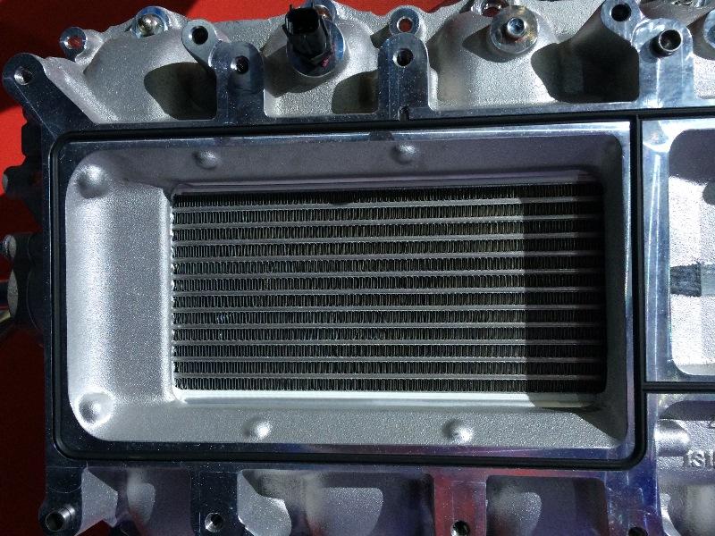

Just another fun fact....
Intercooler core open to the airflow above the intercooler core
Roush 40.9"
Whipple 71.4"
Surface area is king in intercooler effectiveness.....
