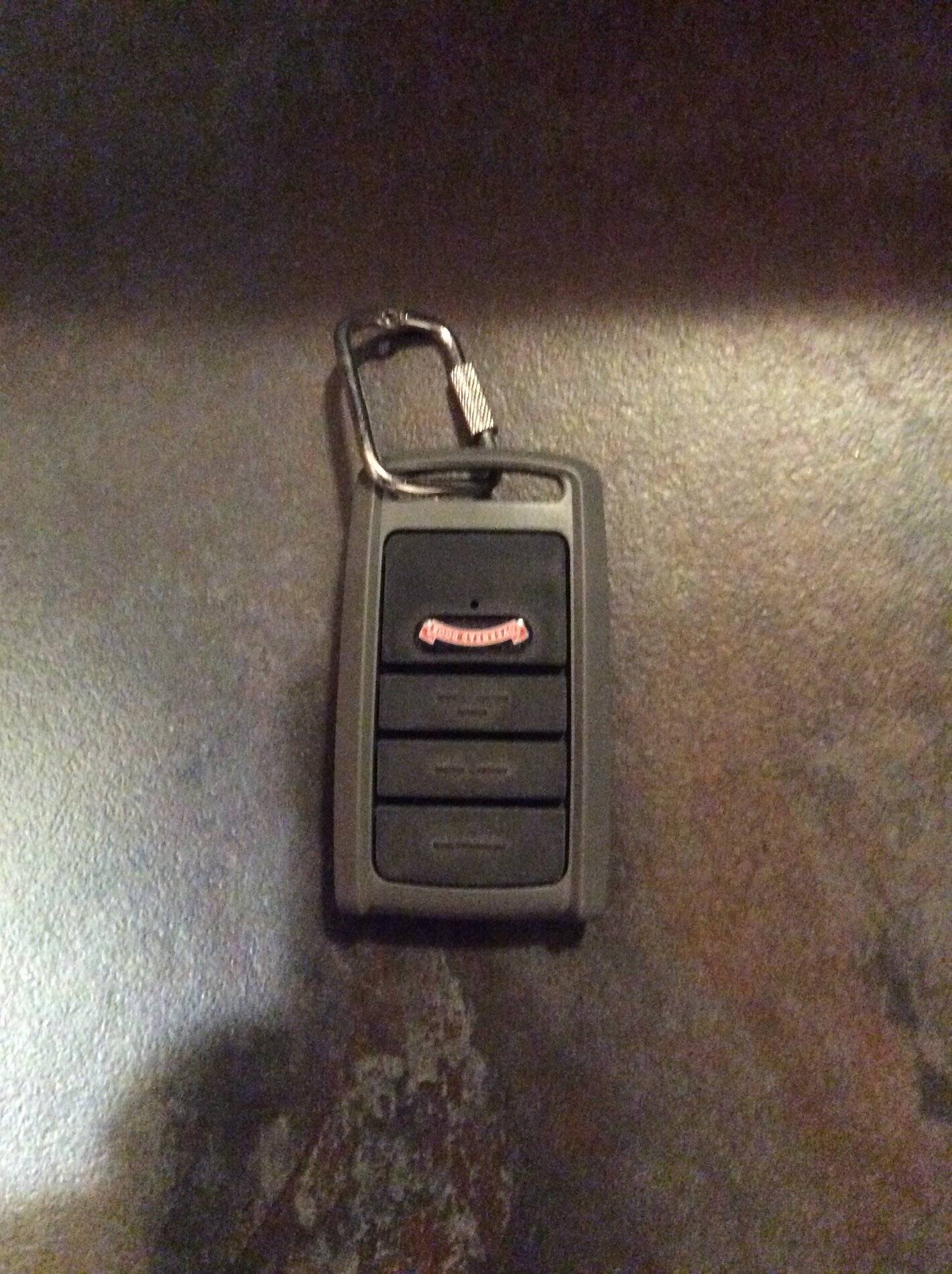

You can get a keychain fob that will work with your opener. Cheaper than $277. Just have to program it. My opener came with two of them but I’m sure you could buy them from eBay or Amazon.

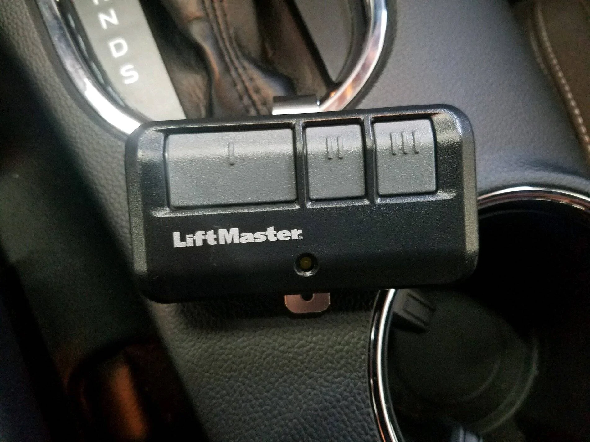

my GT has that option... i still have a separate remote for it... never used/paired the visor one lol
and the F150 the same, the only difference is the mustang remote is on the center console and the f150 is hanging on the visor...
