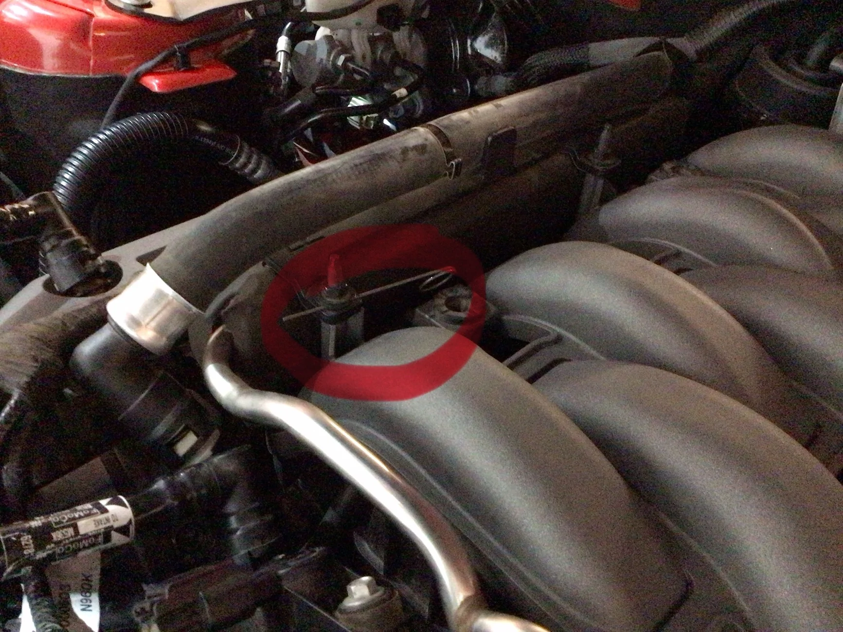

this part under the engine vanity cover I can’t seem to identify it’s use? Can anyone tell me what it’s for ?
it’s a piece of wire with a loop in it ?

Not sure about that wire. It looks captured under the stud which the engine cover plastic mounts to. I dont remember ever seeing that on my ‘16. No idea, but doesnt seem important.

but it sure looks like an elongated grenade pin to me, and I’ve pilled my share of them as a combat engineer đŸ’„

No idea on the grenade pin, wonder what that blows up??

Regarding the pin, IDK. These engines, they're used in several different vehicles. While the pin appears to not be serving any purpose in your car, it might in another vehicle. Like acting as a tie-down or waypoint for a wire or vacuum line.
Oh now that is a good point Skye, the coyote F150 might use it in that vehicle.

As far as the "wire" goes it MIGHT be a locking mechanism for the bolt/nut. I've seen these arrangements on aircraft. It's a form of "lock nut" with a visible locking system. No idea why this would be installed on your 'stang but maybe it was done as a safety mechanism to prevent the bolt/nut from loosening from vibrations. Just a thought.
