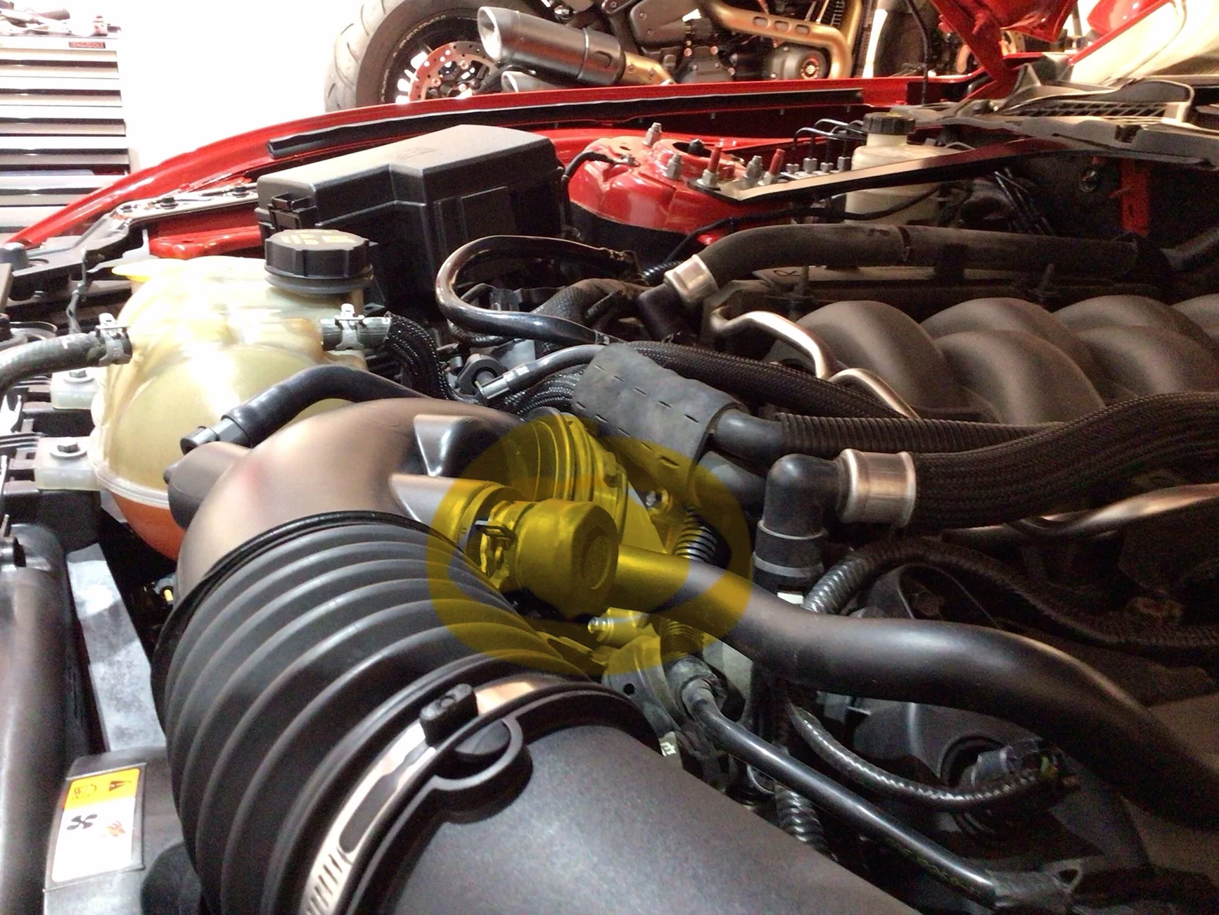

Guys I also removed the big pipe that pumps air noise into the car, I sealed off on the intake and plugged the firewall im trying to clean up on a budget the engine bay a bit - considering adding a Nitrouse kit 😐 at this stage a super charger in SA is almost more than the value of the car 😕any constructive thoughts on this
I’m not a big fan of running a dry kit, but if you run a wet kit and you upgrade your fuel pump you should be fine but keep your shot around 150 if you wanna run a big nitrous kit you’re gonna have to make some modifications by the time you’re done it cost as much as a supercharger so keep it down around 150 change your pump use a wet kit you’ll be all right oh and make sure you change your plugs and if you know you’re running nitrous that day, put some octane booster in it or get a E85 tune extra octane is gonna help you not pull so much timing
