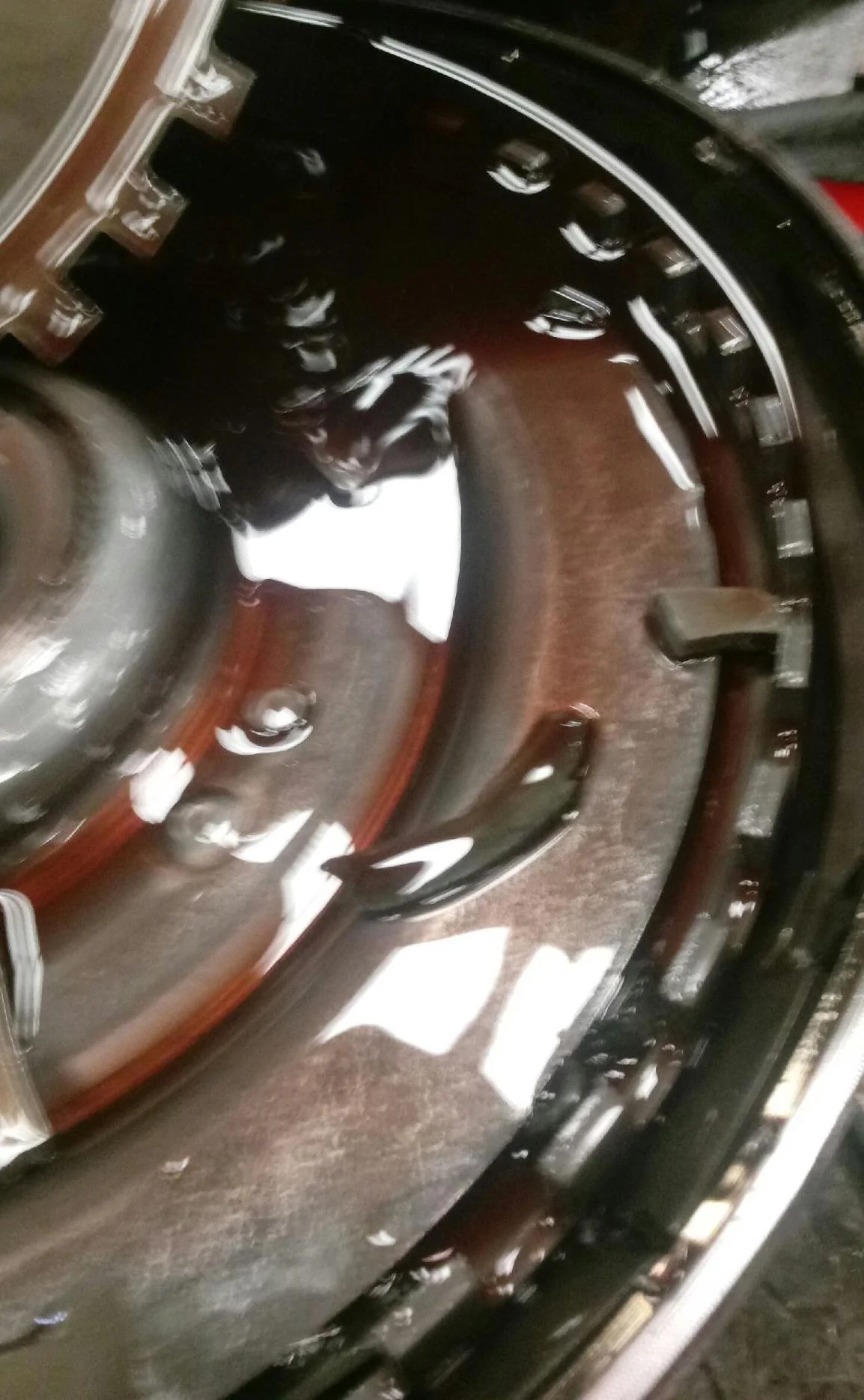

Took the Converter to my local place that cuts them open, just got a call and they said that the converter is trash, broke the clutch plate loose.
Can't wait to see the pictures. Did you car make noise while in Park too? Mine only does it when in gear.

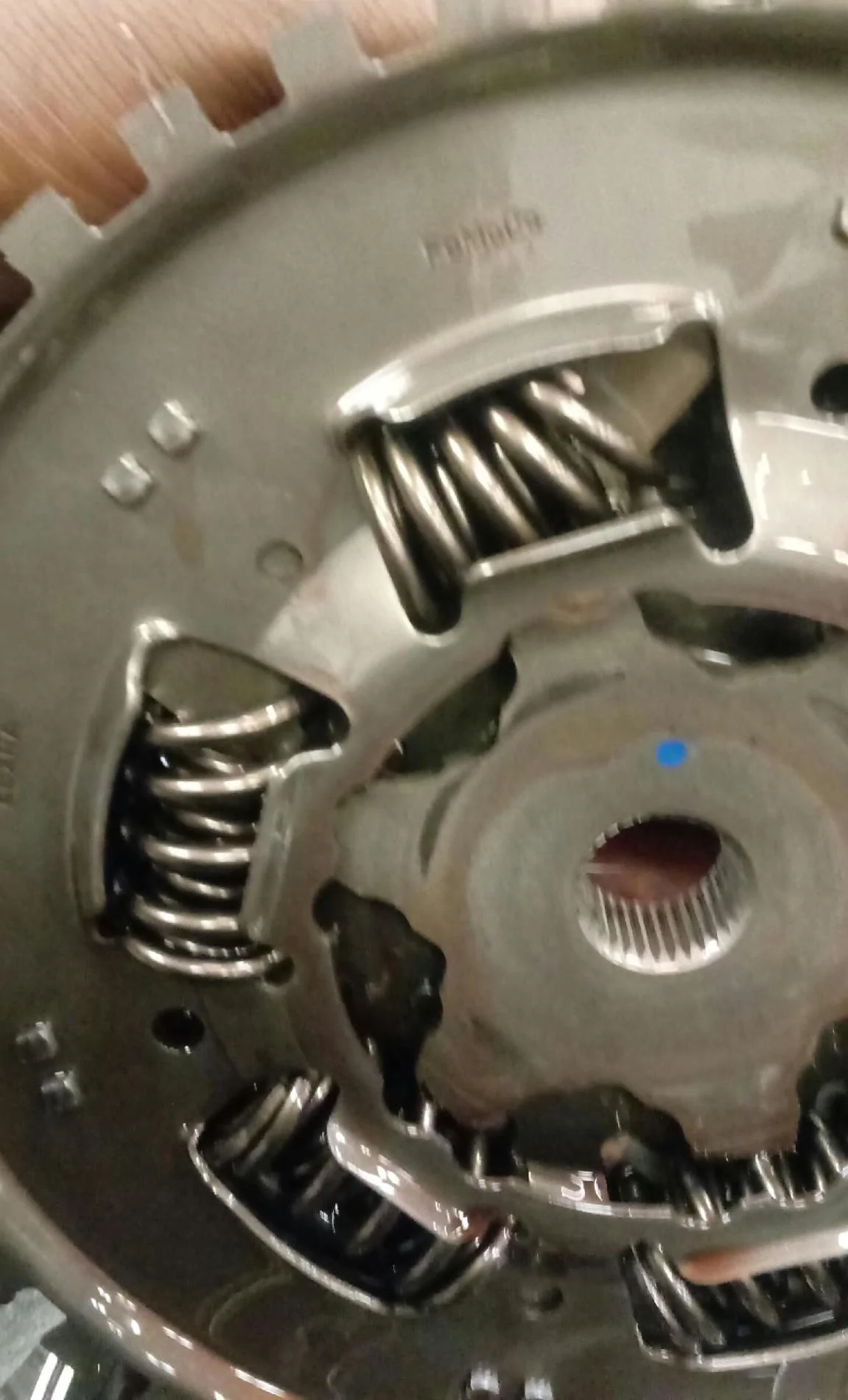

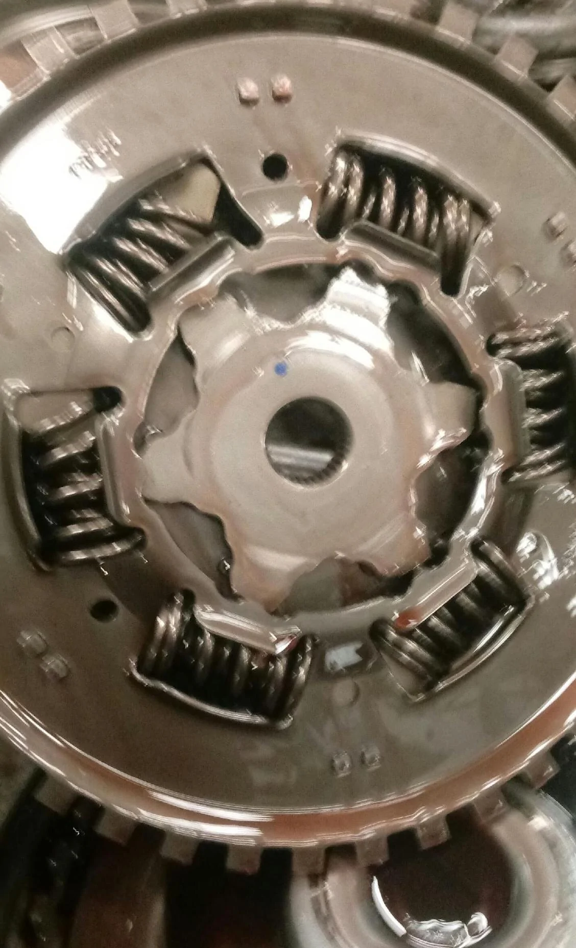

Shop guys camera not that great here's pics
