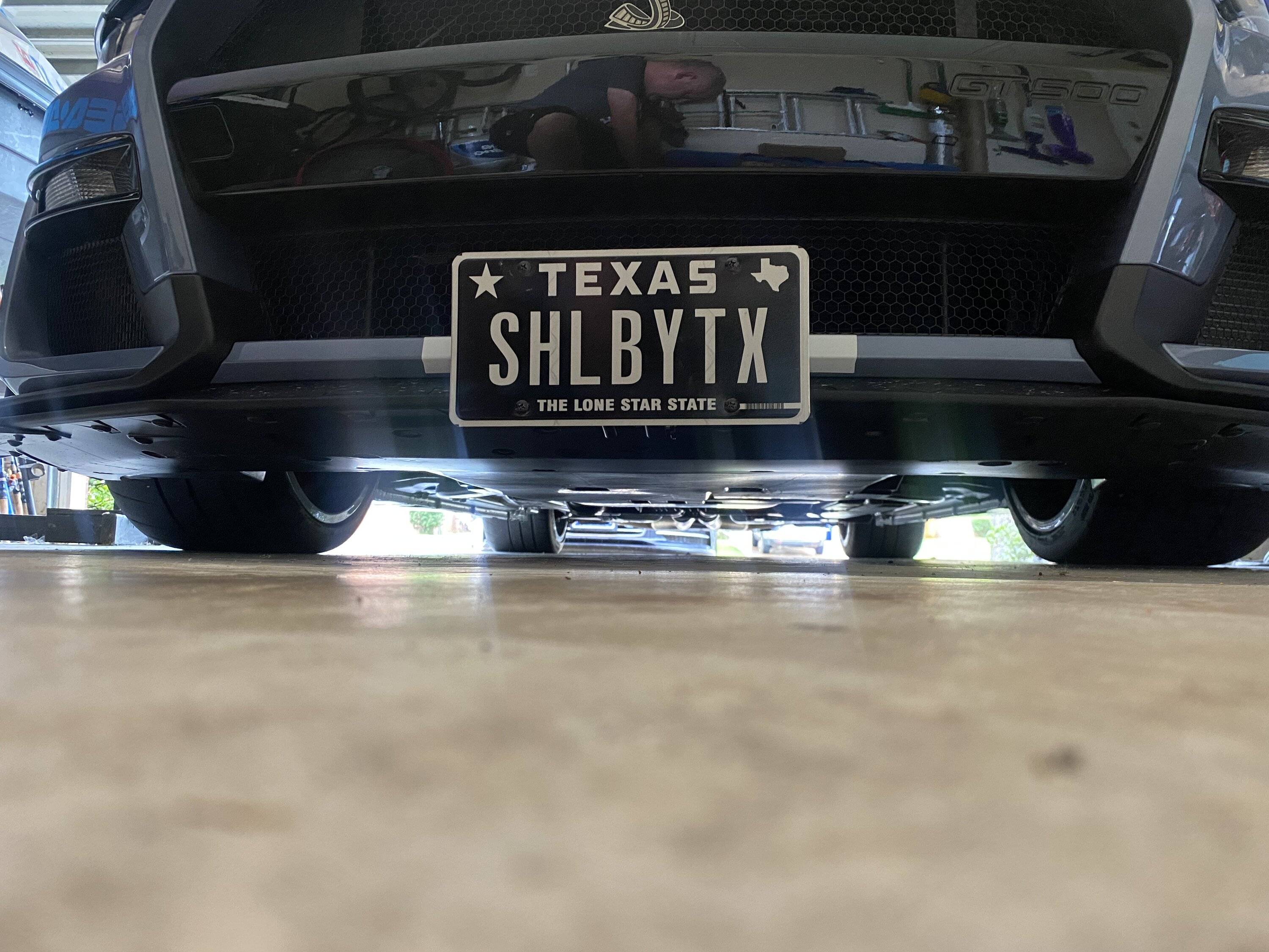

It will be the first thing to hit on a front splitter scrape. Not sure I like it.

Unless you plan on hitting some extra high curbing head on you'll be fine.

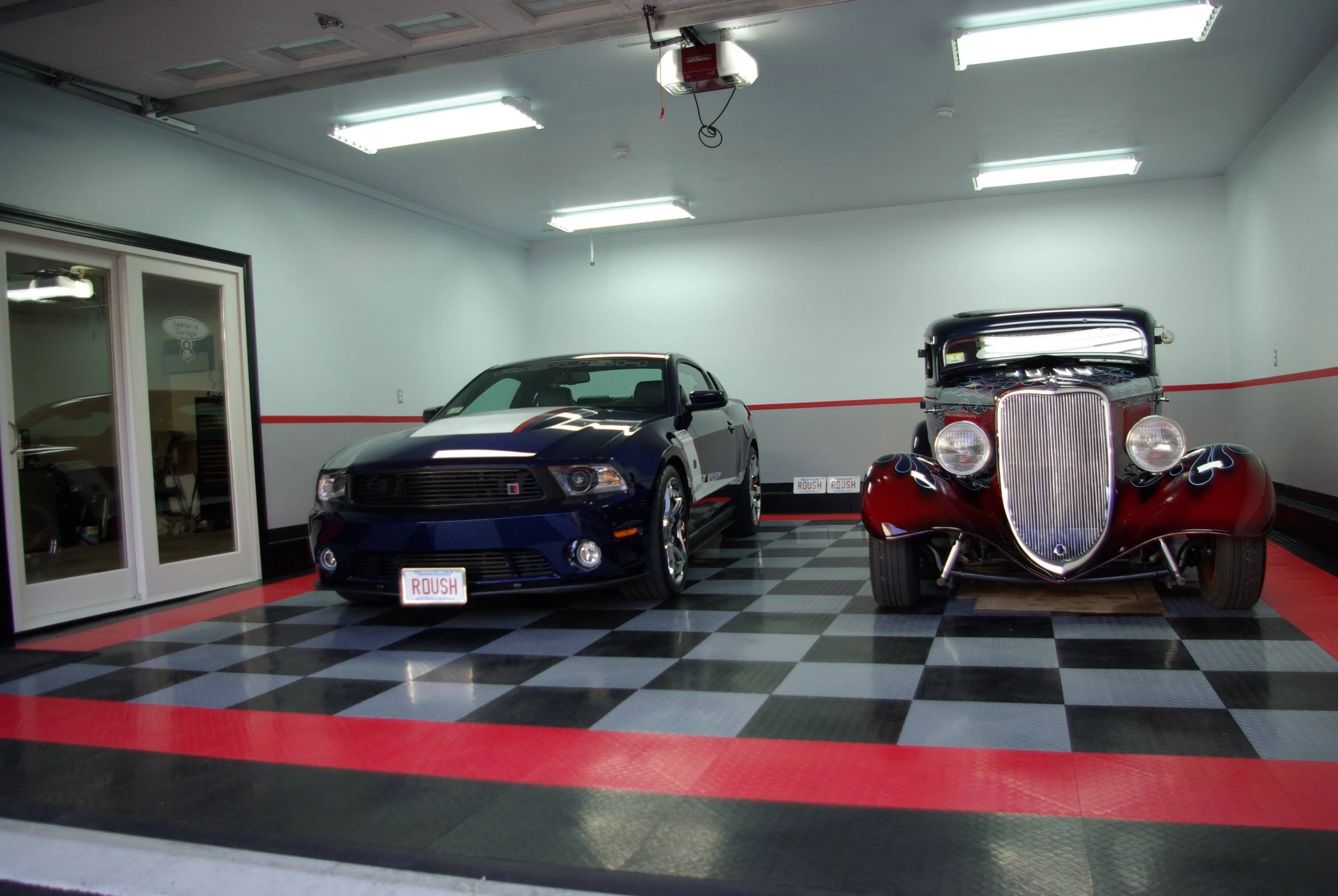

The Roush has a Sto & Go. I’ve scraped it twice and broke the push pin that holds the license plate bracket in place.
Didn’t touch the front splitter at all. The Shelby has the Craig’s bracket which I like much better. Almost looks stock. I have to stop procrastinating and get a Craig’s bracket for the Roush.

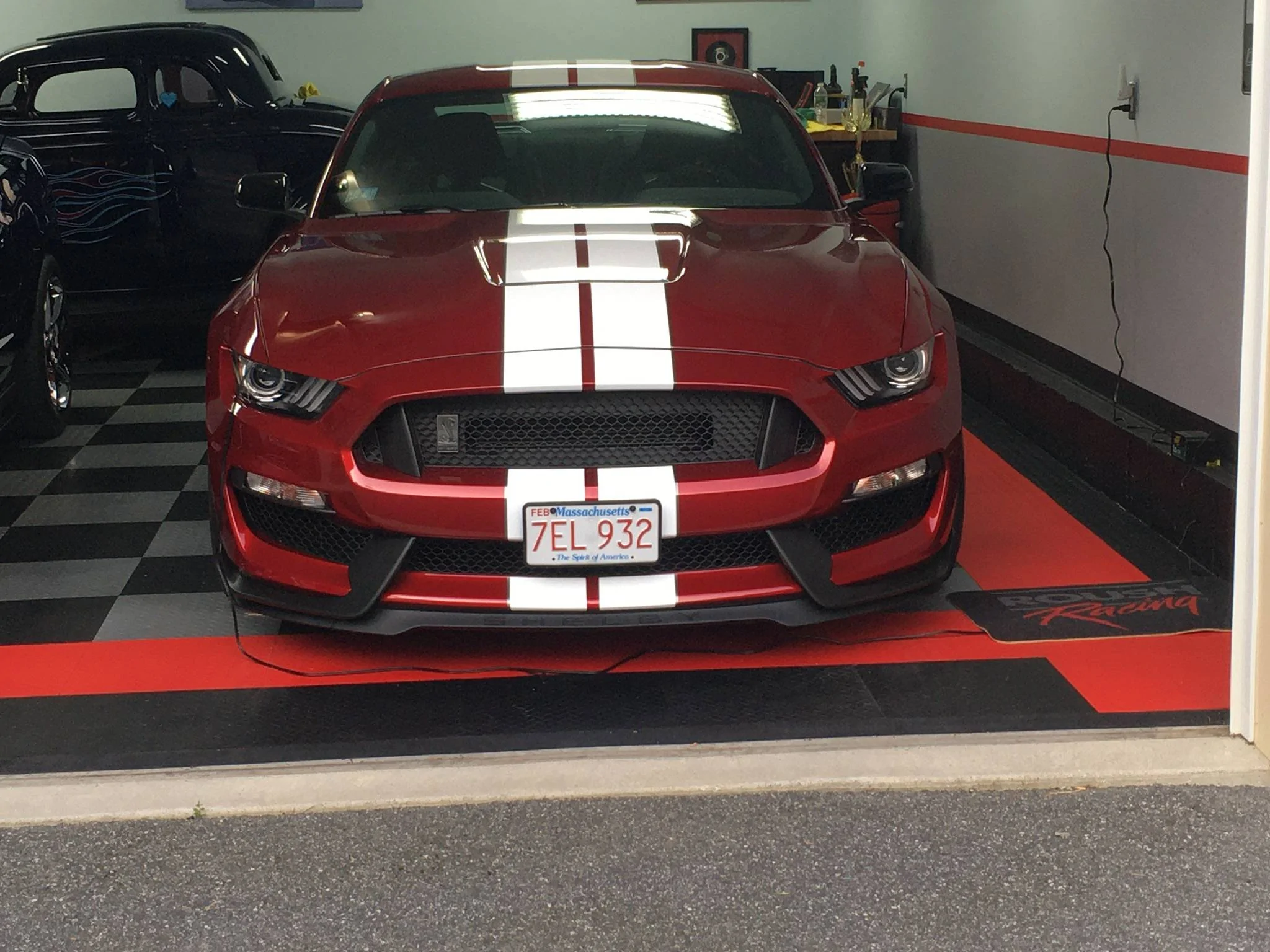

I have been using the Craig’s bracket on all my S550’s with complete success. Best one on the market in my experience.
The Stow and Show is a good product, just too low for my liking.

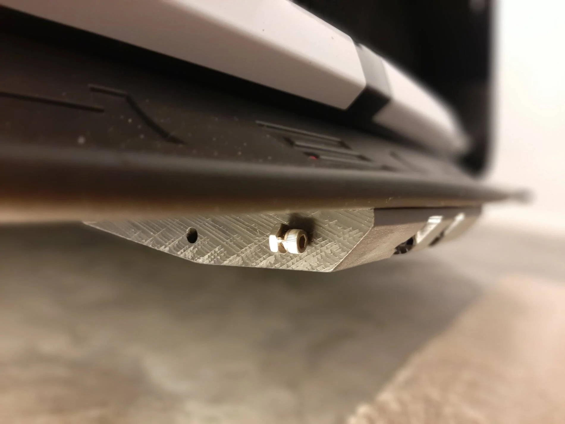

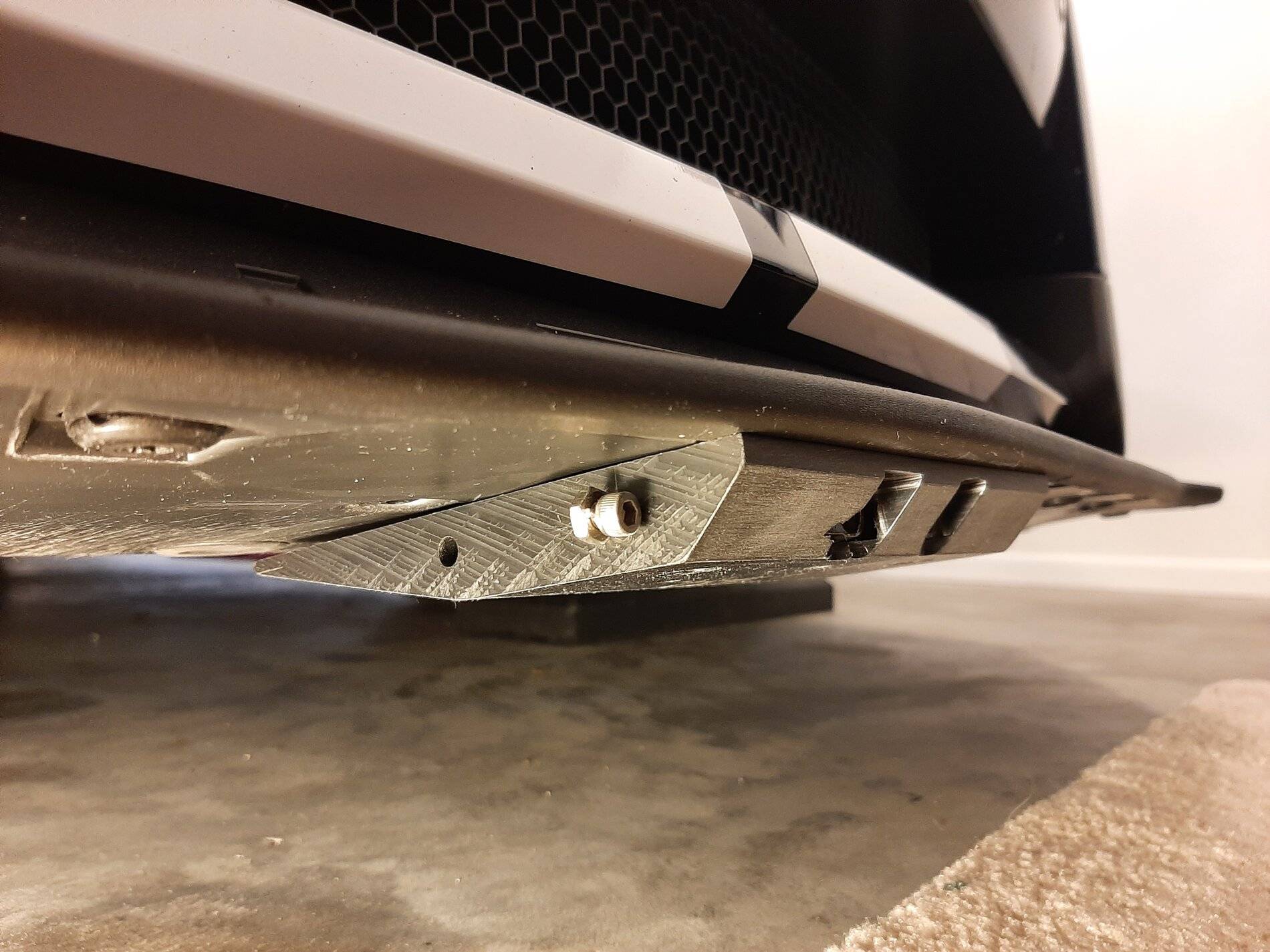

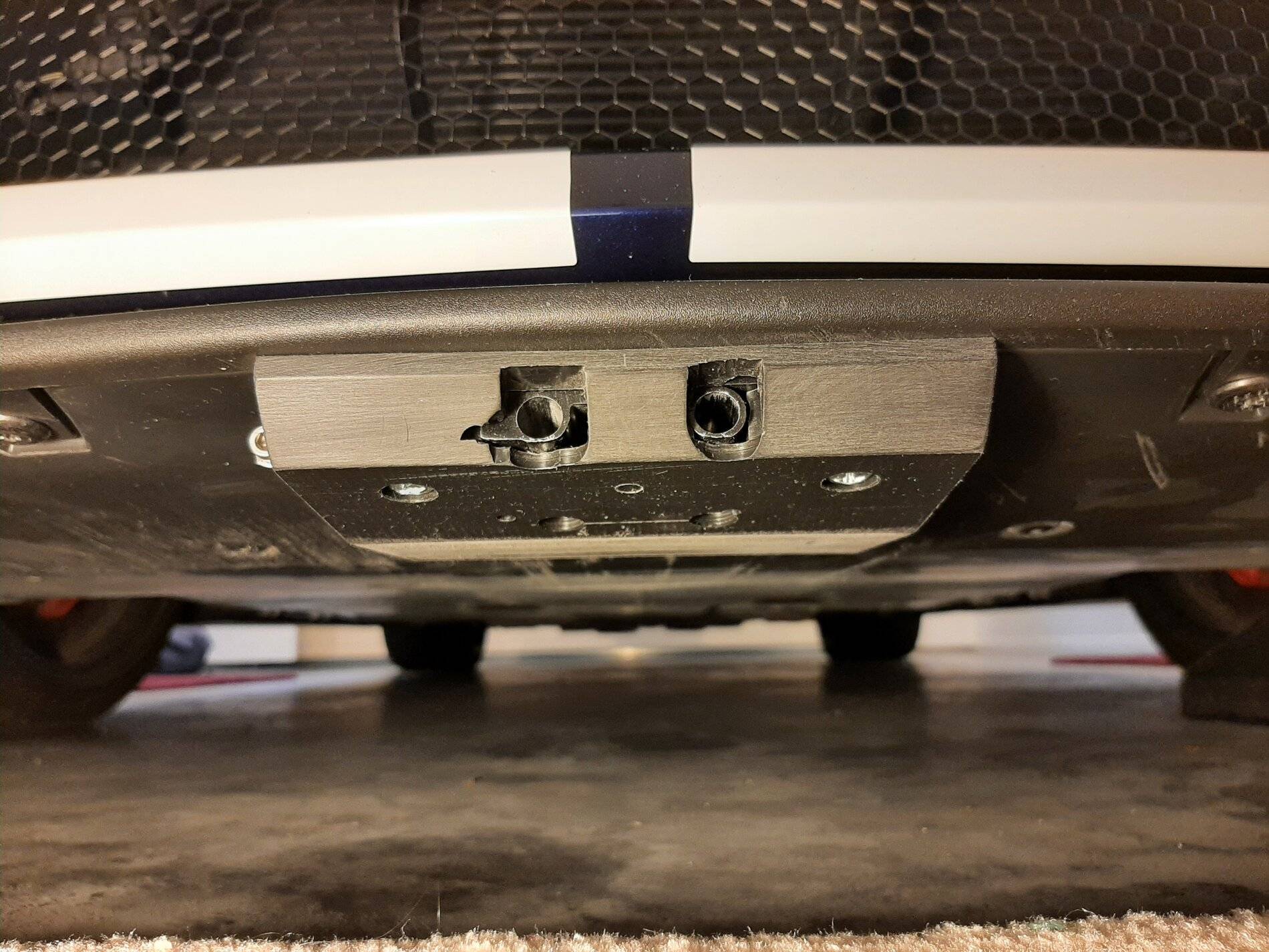

I added an abs skid plate to protect my sho n sto plate bracket. Made out of a 6x6x3/4" abs block. Its sort of like a super slip low and is held on by the 2 splitter bolts. It takes lots of abuse.

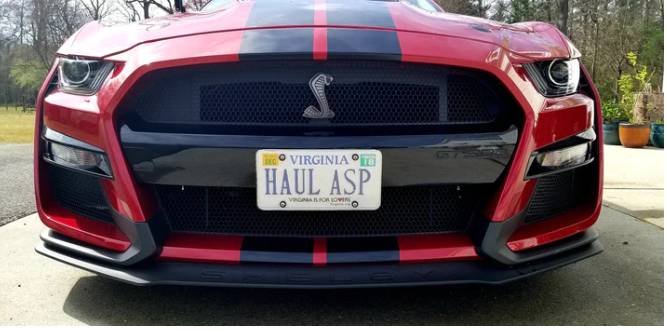

This is why a lot of folks use Craig’s bracket
https://ccmustangbrackets.com/
How does it attach to the car?
That looks pretty slick. How did you shape it or is it 3d printed?
EDIT: I found a pic of how it mounts. Looks like some double sided tape.
I removed my Sto and Sho. 1 I don't use a front plate. 2 I was afraid that bracket may catch and do more damage than a slight scrape on a low item. Like rip the splitter or the pan.
