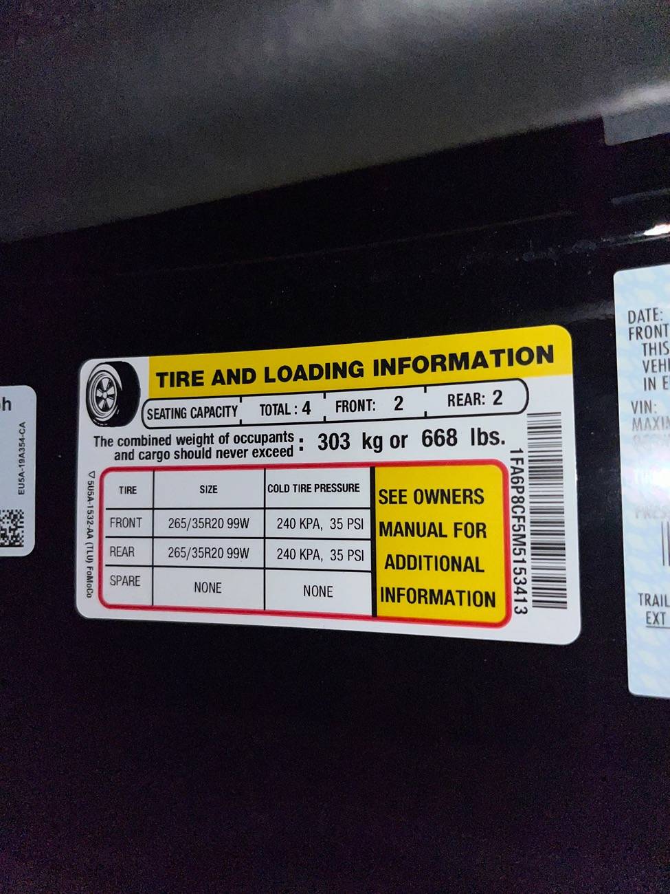

manual calls for 32psi donnit? Most cars i push the PSI up a bit for crisper steering but i've noticed with my Mustang if i go past 33-34 PSI the traction gets pretty squirrely especially in the winter

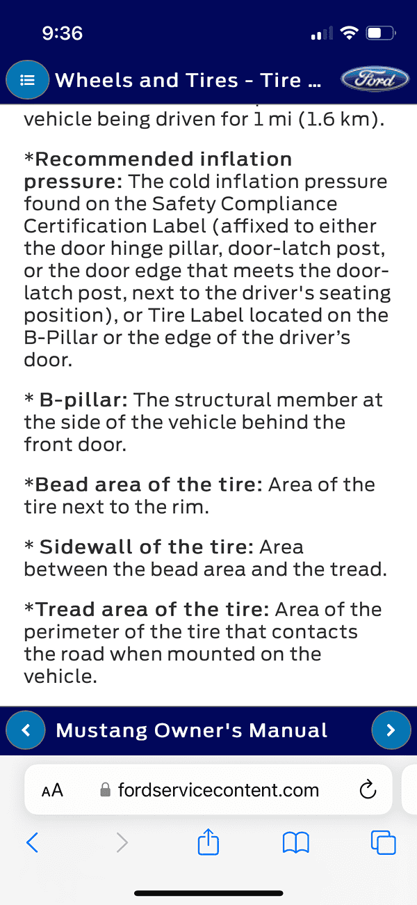

I had to check. The manual references the sticker in the door jamb, see below…

You’re misinterpreting my post. Guy asked what the factory recommended tire pressure is in the manual (he said 32), I’m merely showing what it says.
I get that there are different optimal pressures for different tires. But at the end of the day, you have to start somewhere, and I chose the factory recommendation. It’s a street car, a pound or two difference on these roads, at these speeds, won’t matter too much. I’m not pushing the car 9/10ths.

Yeah sorry about that, i didn't think of them spec'ing different pressures for different tires. My car came with the 255/40r19s and the door says 32.
