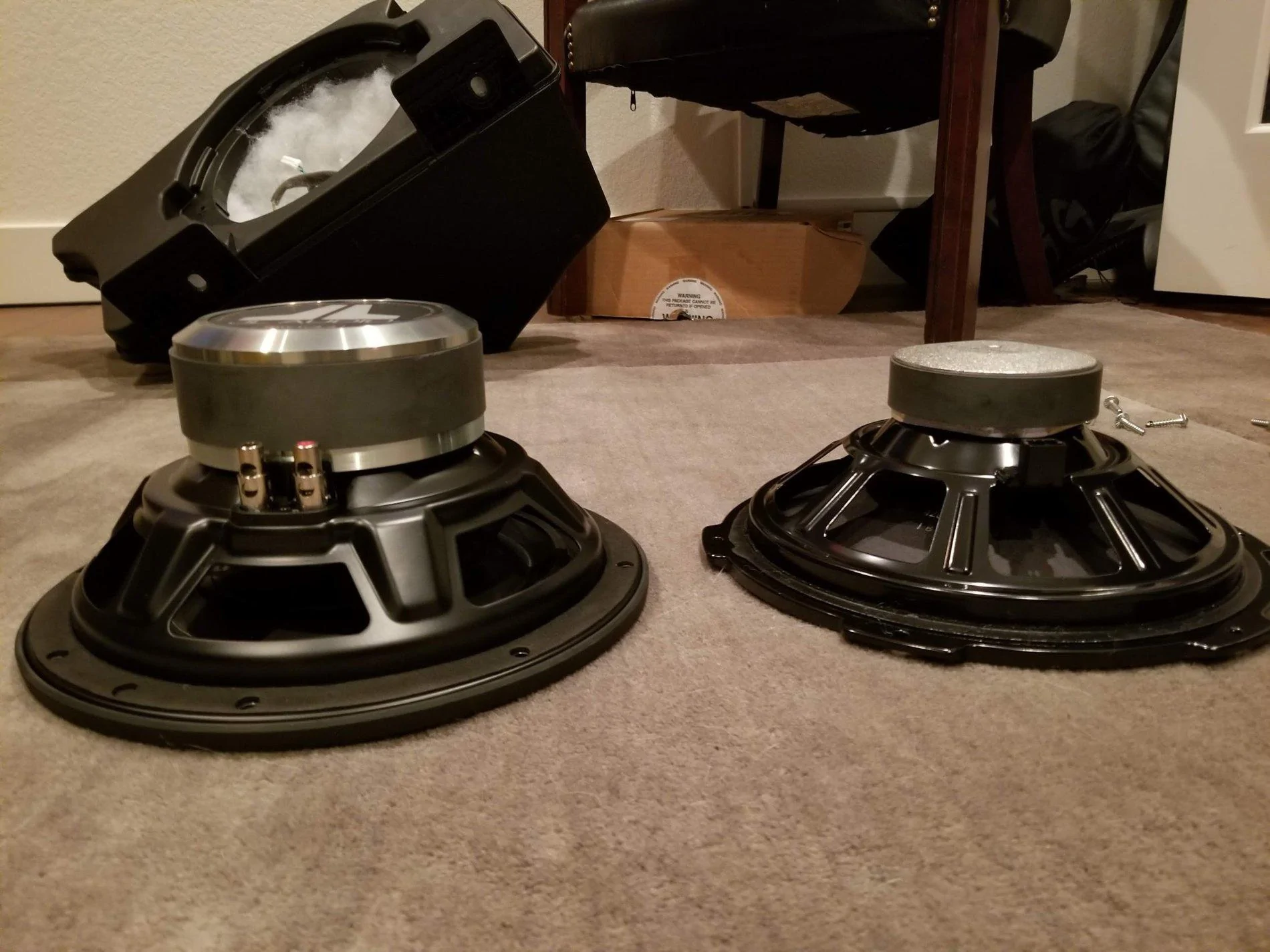

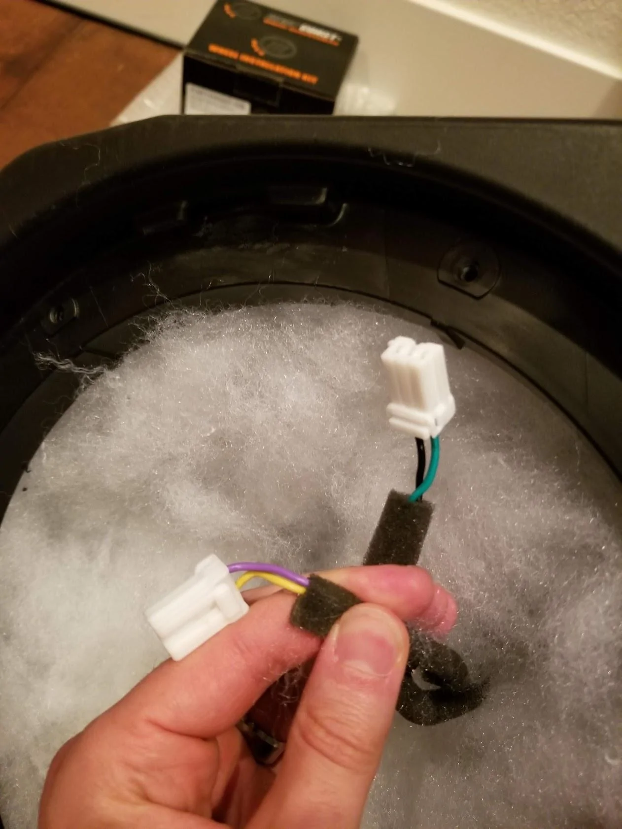

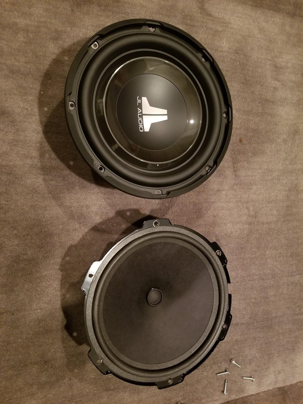

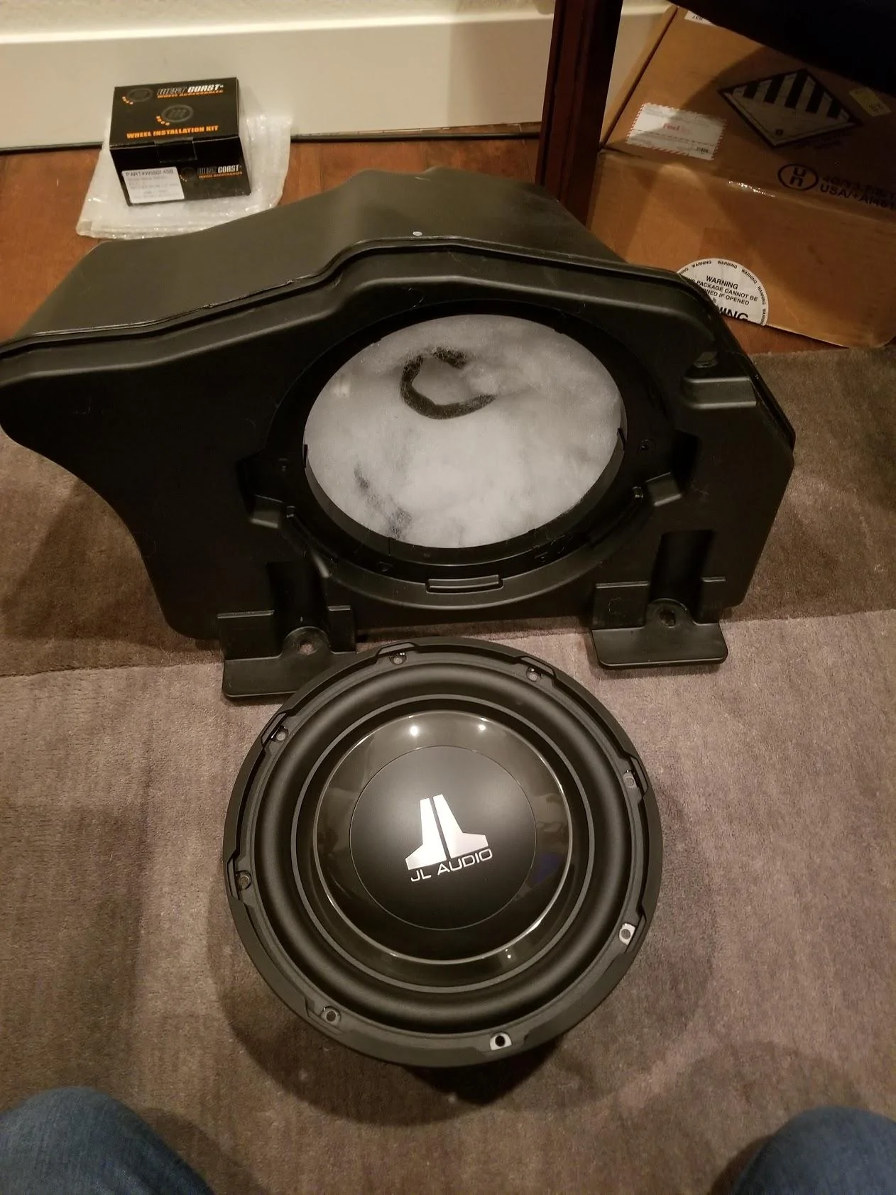

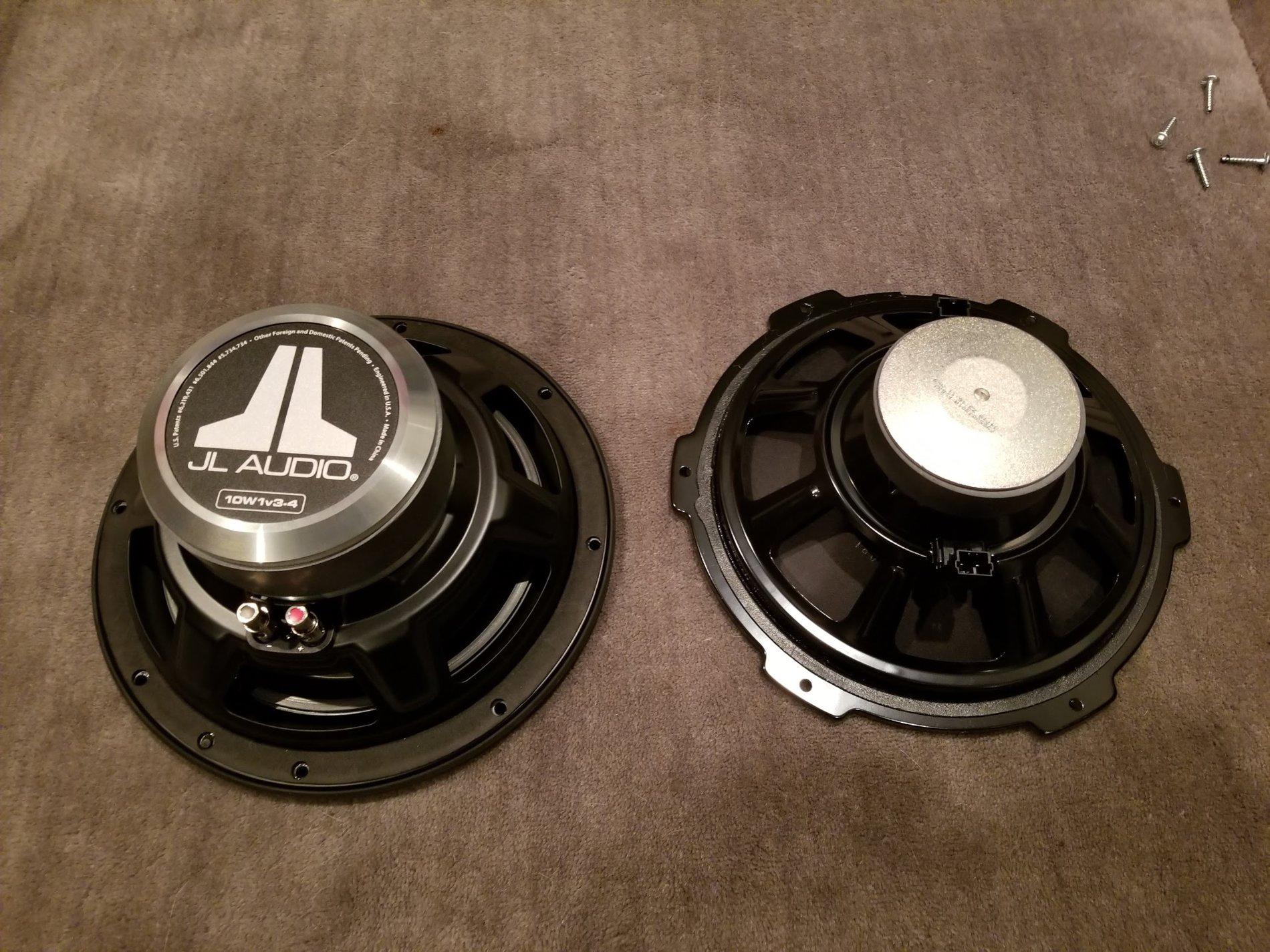

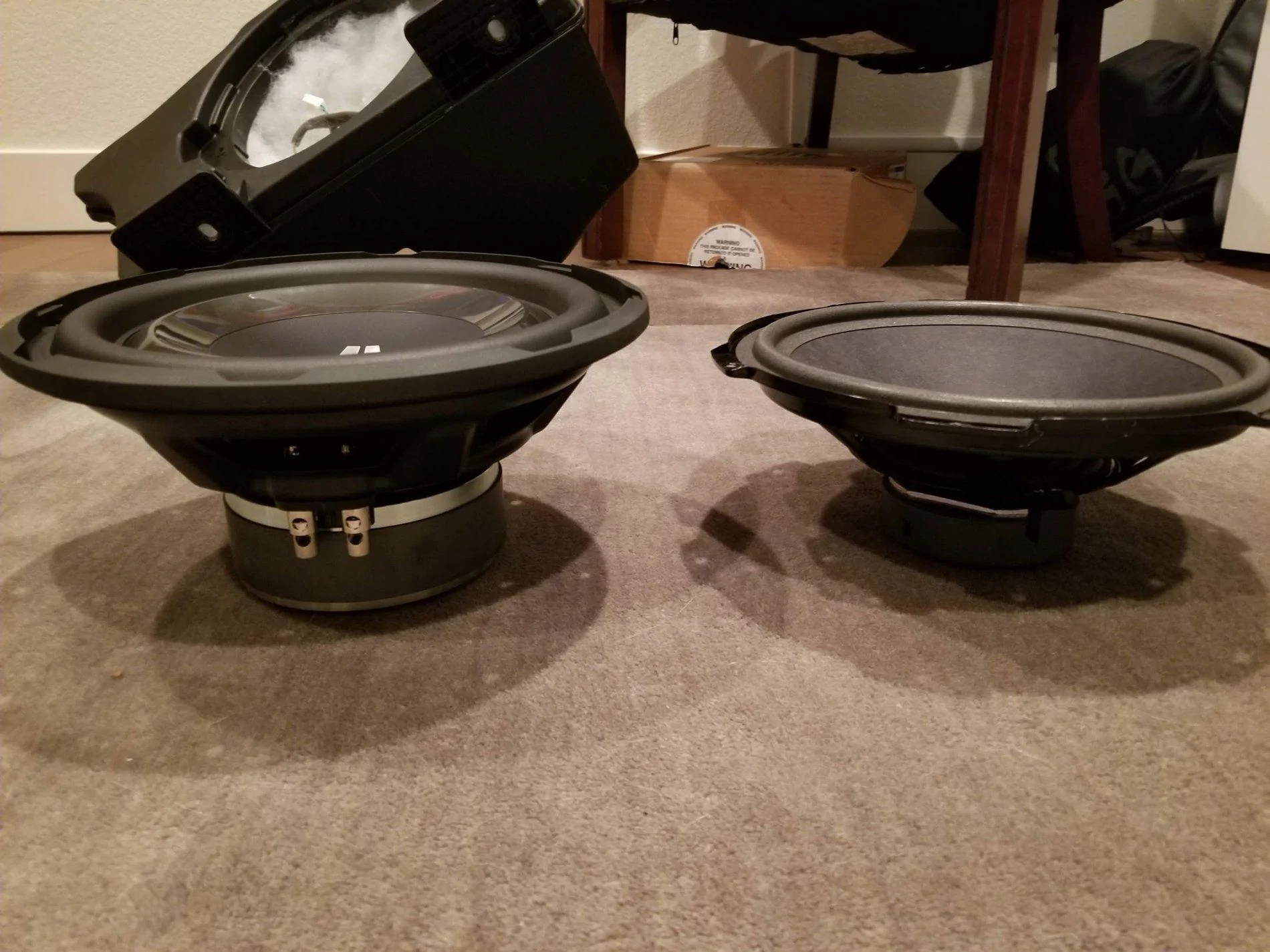

Hey guys,
I tried searching and posting in the Audio Section, but haven't heard anyone chime in yet.
Can someone tell me how to wire these stock subwoofer wires up to my new JL Subwoofer?
Which wires do I combine for Positive and Negative Inputs to connect to the new JL Sub?
Wires are GREEN+BLACK from one side, and PURPLE +YELLOW from the other. SEE PICS BELOW.
Got a 2019 GT with 401A B&O system.
I Bought a JL 10W1v3-4 Subwoofer Driver 4 ohm 300w
Question I have is about wiring the stock connectors to the Positive and Negative input on the JL sub.
Pics below of enclosure, stock sub and JL sub comparison and connectors.
Thanks![
