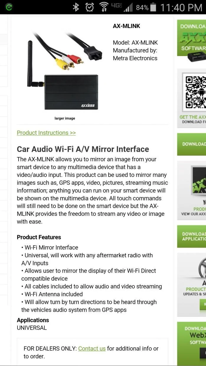

Geeze... I just want someone that will have a screen display exactly whats on my iphone screen. Thats ALL I want. Carplay lmao..
that said I have sync 3 and may/may not ever get carplay but its still "possible" atm.
You could do that with AV in on the MFT. Won't be able to control your iPhone but you will be able to display video/mirror from it.
