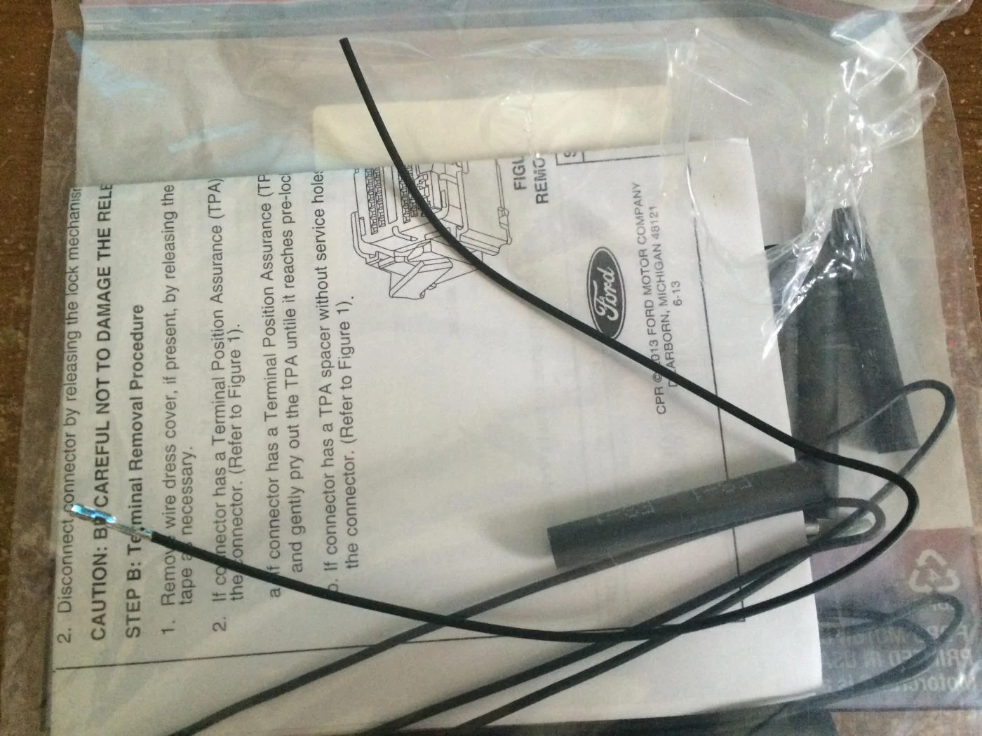

Zach. Where did you find the pins that work for the apim?

Awesome work!! Once all is said and done, if everything works out, any chance of an idiots guide to doing this? Parts needed, where to buy, where or who to get programming done, etc? OR thinking of making some kits to sell with all the necessary parts and programming completed?
I do plan to do a write up once I get mine installed!
It is a ford part number that I got.
wt-1000
Comes with 5 per pack. They are a bit overpriced though so if we can find a aftermarket pin that works that will be better.
wt-1000
I will see what i can find. Im sure they will ship the same pin from china for way less
