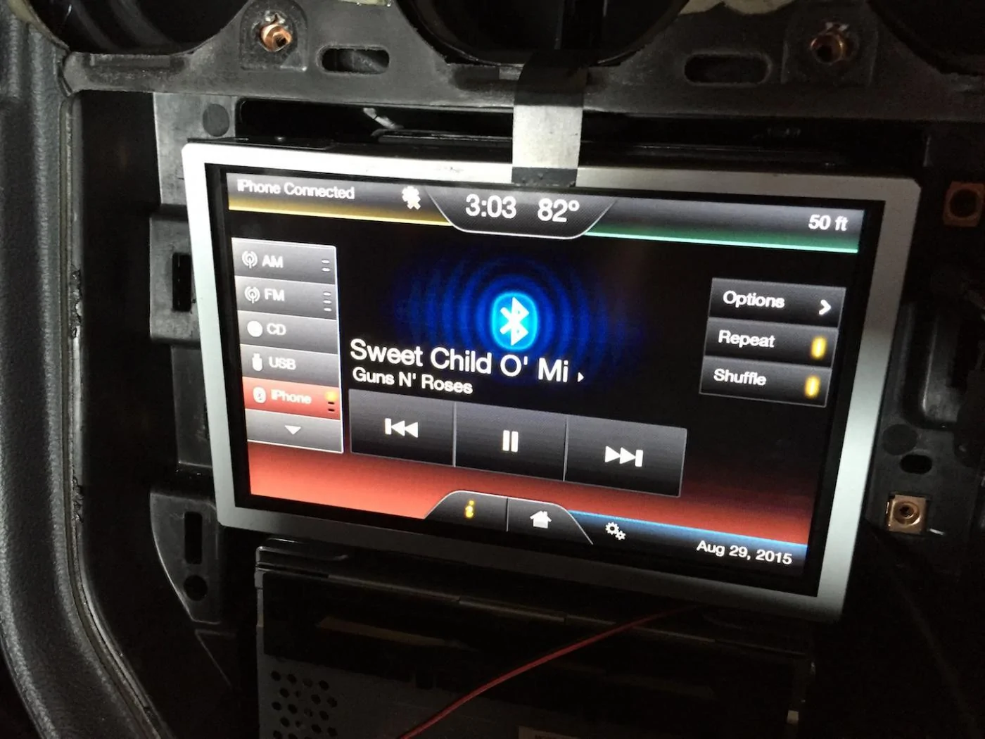

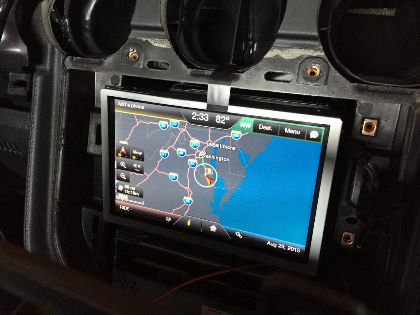

Is there anything else needed besides a screen, a reprogram, and moving around a couple of pins? What does adding nav involve?
We still don't know the full extent of what will be needed. As it stands currently your list is correct.
Adding nav requires the multimedia module. This module is what has the sd card reader. Base model vehicles simply do not have this module or any wiring for it. So all of the wiring for this module will have to be added and run to the center console. There are about 10 wires that will be added for the module.

So If I wasn't worried about nav . . . Just a screen, a reprogram and your bezel. Is there a way to tell if the screen has nav or not based on the part number or does it even matter if it is going to be reprogrammed anyway?

So does the motion activated stuff work now?
zackmd1
Oct 1, 2013
140
5,298
3,504
Maryland
Zack
1970 Mustang, 1965 AC Cobra, 2023 Ford Bronco 2Dr
[ame]
aggieStang
Jan 6, 2015
752
197
Refugio, TX
2015 Mustang GT, 1965 Mustang Coupe
Well i guess i should get to work on flashing mine with some mustang data then. Too bad my laptop got delayed and wont be here til monday
zackmd1
Oct 1, 2013
140
5,298
3,504
Maryland
Zack
Sorry about that aggieStang! Yes everything works with the exception of one thing. I currently have no audio during a phone call and no audio for sync voice prompts. Jmr believes he as already located the issue though. The base ACM programming needs to be modified slightly to get this working. Other then that everything works!
