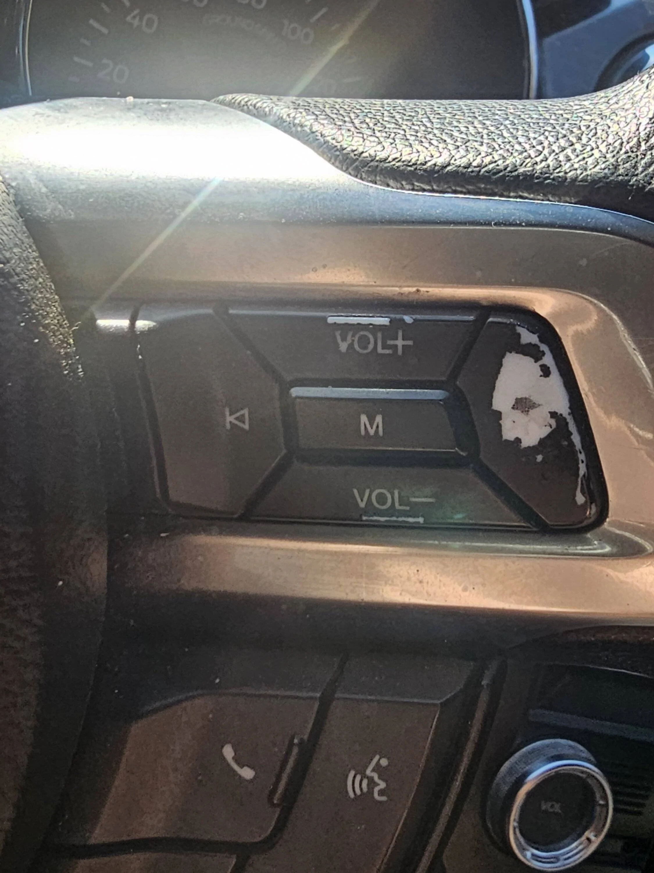

What's the general consensus on fixing/replacing worn out buttons on the steering wheel? This is making the whole car feel worn out since its right in front of you.

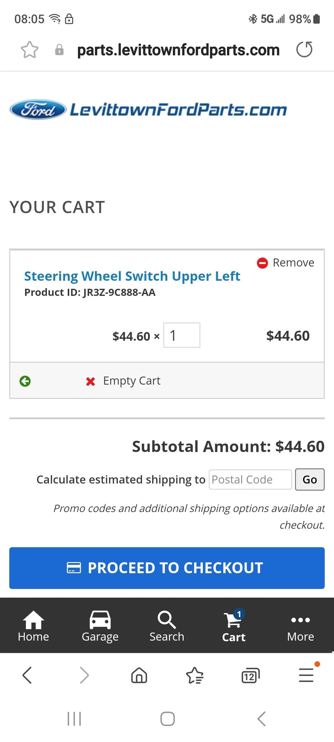

Odd this topic came up. I've had this hanging out in my browser for a while now. Just haven't pulled the trigger since mine really isn't that bad.
Have your VIN handy if you call them. Otherwise know that there's a difference '17 to '18, the functions switch sides, and there may be some other changes between models.

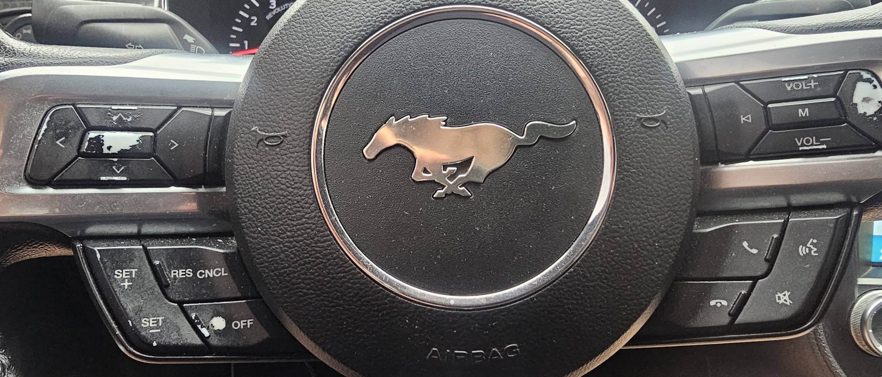

After looking, might think of replacing all of them

Yeah my OCD would kick in if only some of them were new. Might as well do them all since you’ll have the wheel off anyway

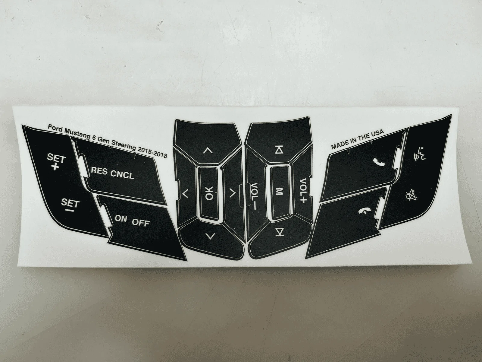

Hey OP you can always try something like this.
I've seen these overlay stickers work well on other cars before, just never on a newer mustang. It has cutouts for the button ridges and supposedly they allow the lighting to pass through when the headlight switch is on. If you google this style of sticker overlay, or check amazon, you can find reviews and see that these usually work well on other cars. They are also a cheap option for worn head unit and AC controls
You're going to want to clean and use a paint pen or something better than a sharpie to paint most of the button back to black first.
I was originally going to go this route, but I have all new switches and trim parts coming in from levittown ford this weekend.
