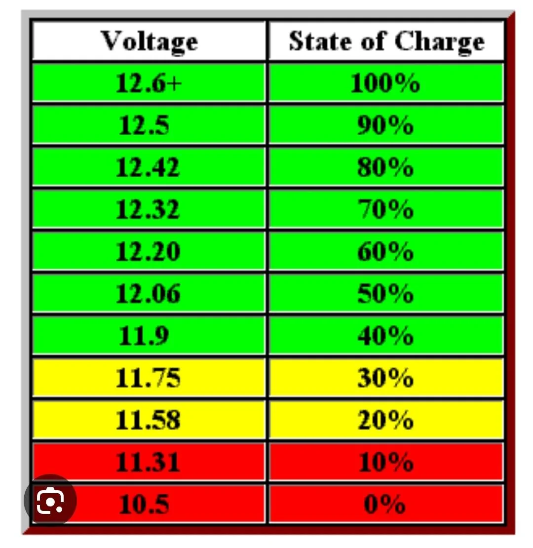

The battery voltage is not 14.4V. That is the alternator output voltage.
Turn the car off, flip the headlights on for 10 to 15 seconds, turn the lights off and THEN measure voltage across the battery and compare it to the following chart. That will give you a decent guess at the battery's true condition.
