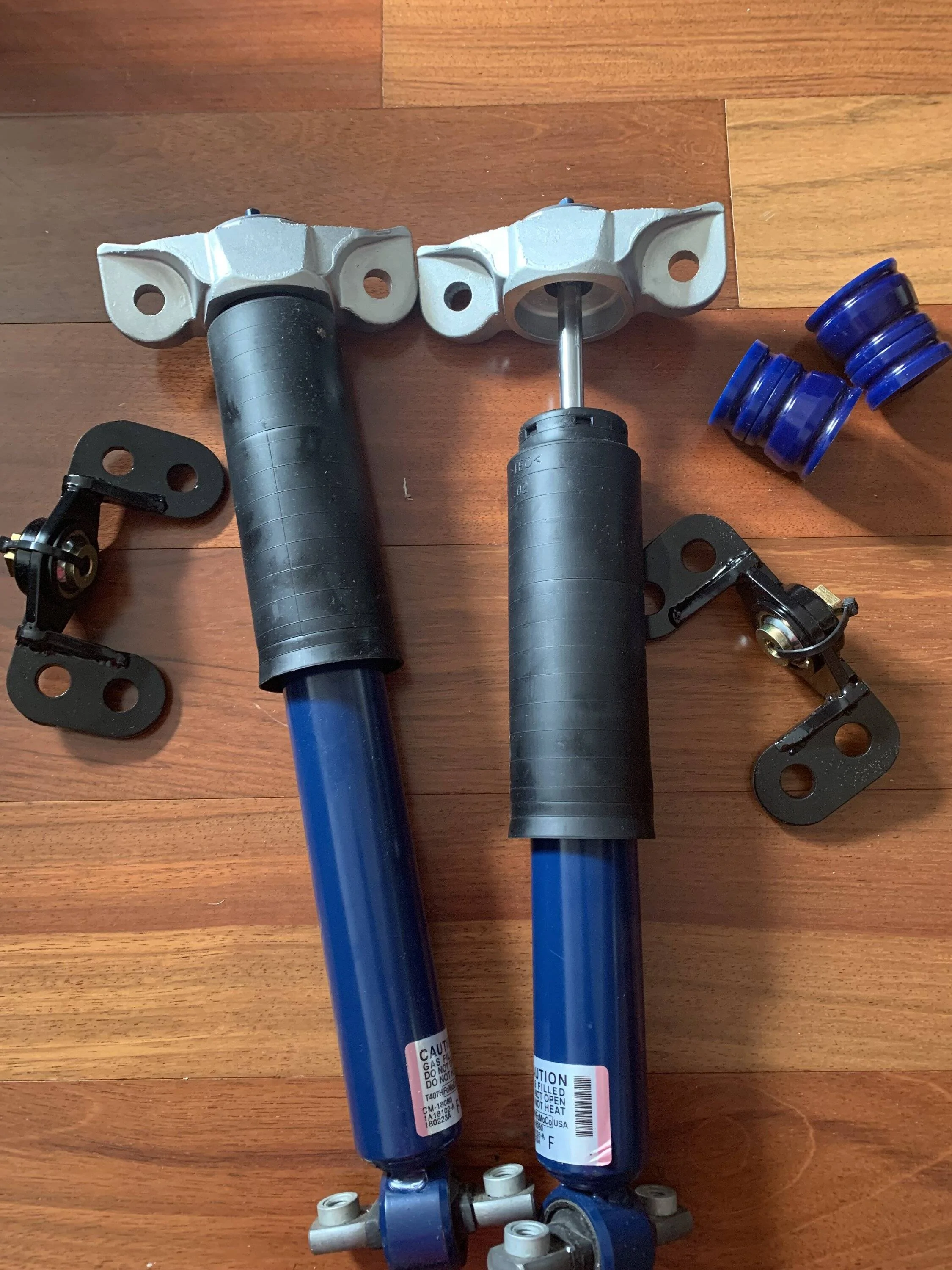

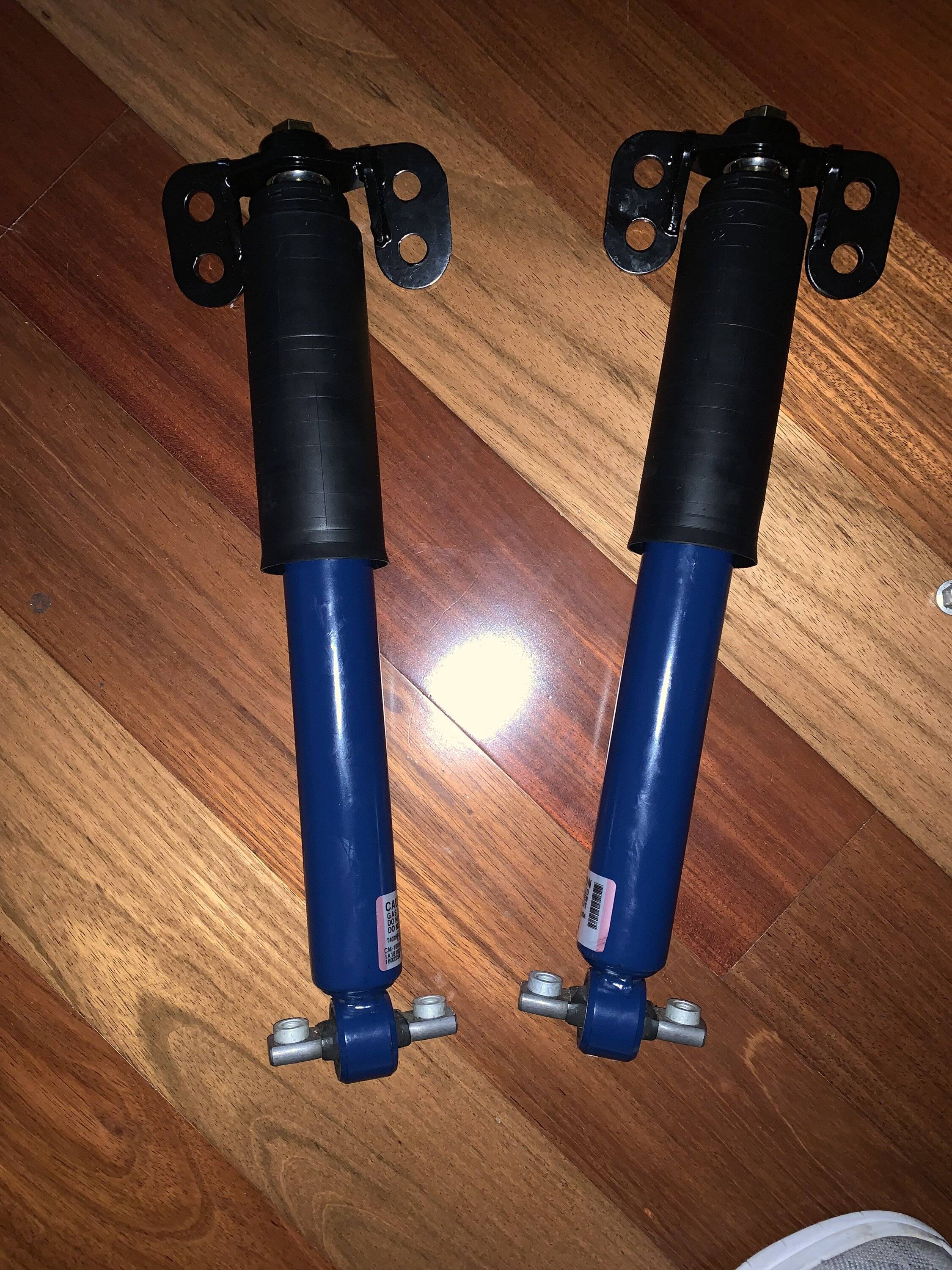

In my humble opinion, Vorshlag makes the best rear shock mounts. The design give you rear shock travel back and doesn’t require another brace to work like the BMR units.
I was fortunate to get them at intro pricing back in 2019. After several track miles and patchy DC and Baltimore roads, everything has held up great.
This is the route I'd go too. I wish I could have got in on that pricing though!
Yea. It was while they were still in the production phase. I think I waited like 3 months or so after ordering. It was $200, but looking at the prices of other options, that $330 doesn’t seem too bad. Really only see them on coilover applications so I like they made a stock set up option
