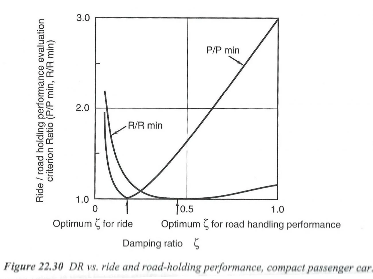

what does this say about the suspension combo? that there's a point where there is too much dampening for this spring?
This isn't a pass/fail kind of thing. On any car, every spring will have a point where ride quality is optimized, and a point (with greater damping) where road handling is optimized. There is a point where the suspension could jack itself down, particularly with too much rebound damping combined with not enough damping on the 'bump' side. The following is a general plot of ride and road handling vs relative amounts of damping, not specific to any particular car but good enough for illustrating concepts. Best performance wants something like 2 or 3 times as much damping as best ride (same springs).
Also, what should I be using for the track and is increasing the rebound going to benefit me with these springs? Or is that more for controlling more aggressive springs like the dual rate?
Both.
With adjustables you can find a decent setting for ride quality, but it won't be providing firm enough damping for when maximum grip is desired. This is something that can be felt from the driver's seat if you're driving the corners hard enough and are sensitive enough to differences in "feel" while you're driving like that. Stiffer springs need more damping than softer springs, particularly rebound damping.
