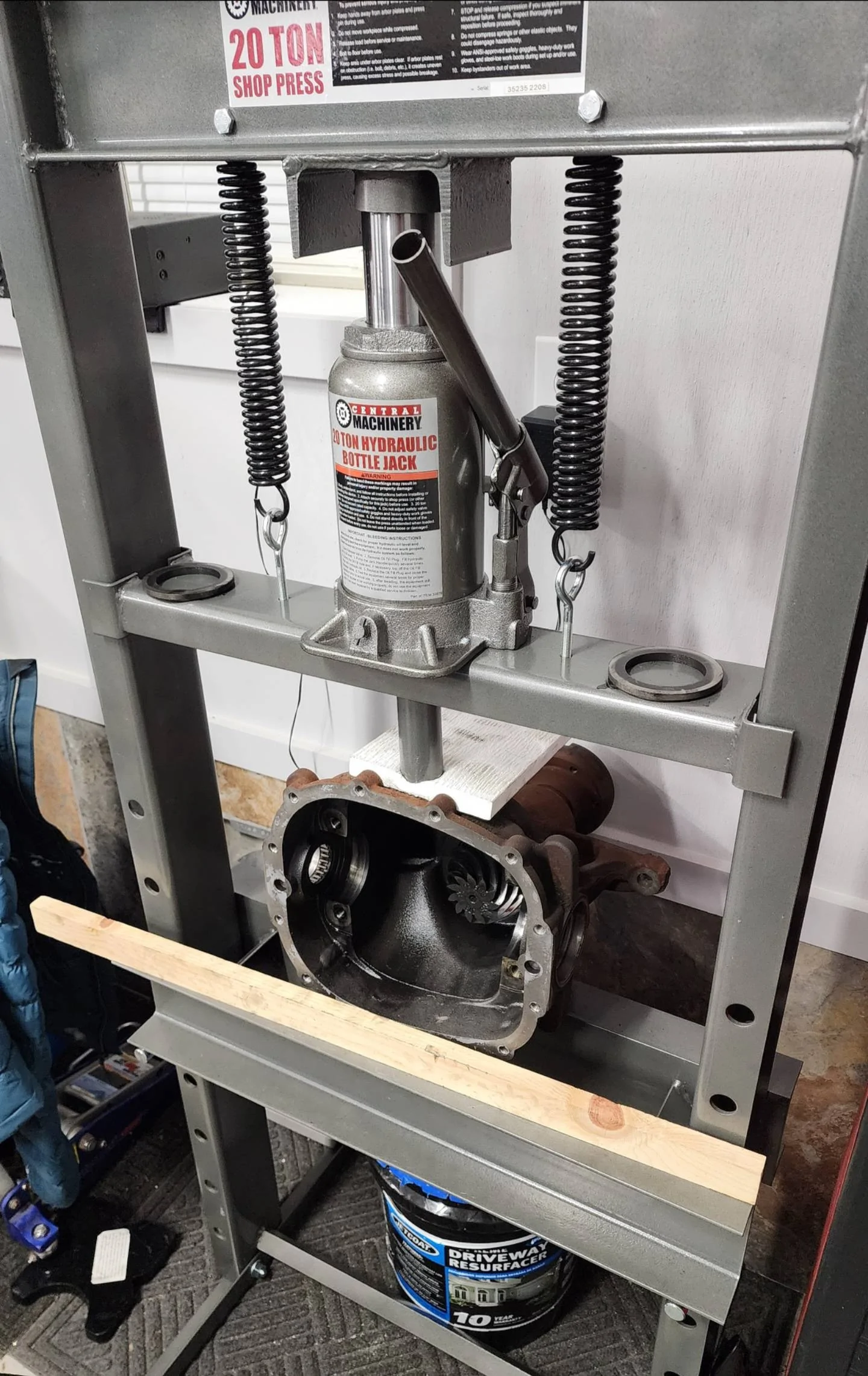

Not sure what the guy above is talking about, but if you don't use a case spreader your going to have one hell of a time getting the diff out. The Ford manual explains how to use the case spreader. You place a dial gauge on the pumpkin and only spread within a certain spec and then you can lift the diff out. It's not real complicated. I rebuilt mine, changed all the bearings and seals and put in 3:31 gears. I reused the factory shims and everything was within spec.
Also, mine only had two thick shims. One on each side. You can see them in the picture laying on the jack crosbeam.
I have all the shims that came in the Ford rebuild kit if you want them.
My simple "case spreader"

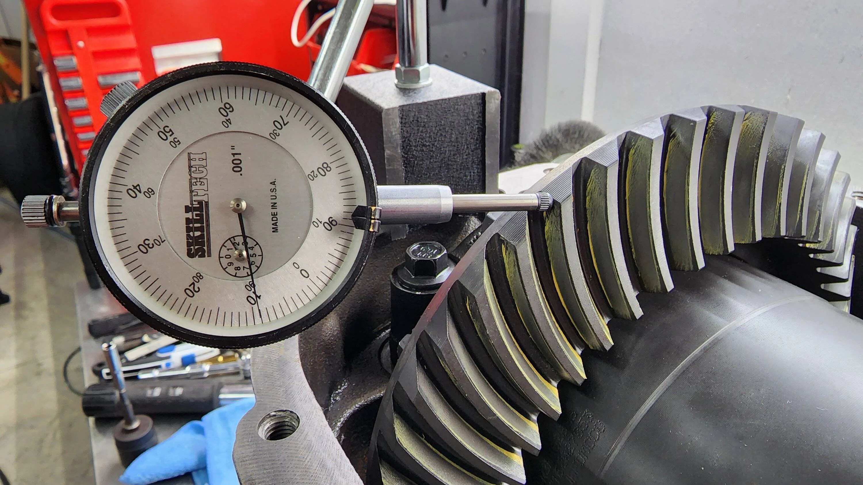

This is how I checked the backlash.
