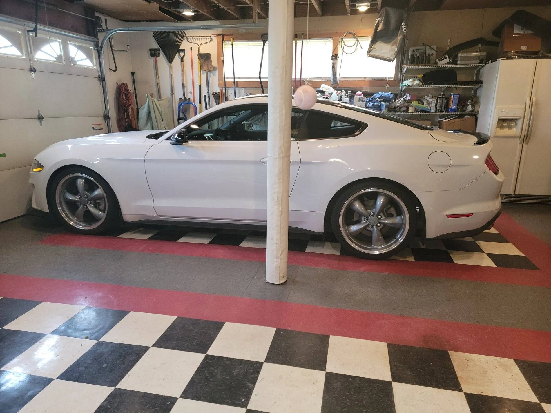

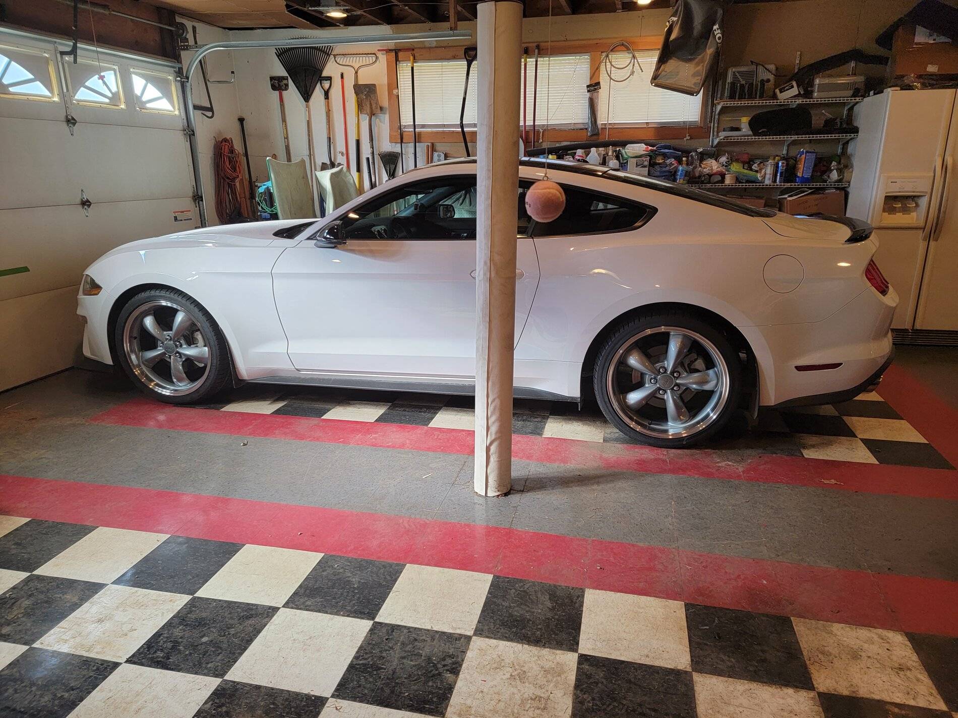

So I ended up ordering the springs and I installed them today. Took about 3 hours working by myself and taking breaks whenever I felt like it. The rears were a breeze after dealing with the fronts. So far it seems that I have roughly 1/2" drop in front and about 3/4" in rear. Waiting to see if any settling occurs. The car looks way better than before but a bit more drop would be nice. The ride so far is damn close to factory. I haven't driven my normal route to work yet but we shall see. Overall I am pleased. Let me post pictures before an after. In a few

So here are some crappy pics from in the garage.
Before
After
Still hoping for a little more drop. Do the springs settle more as miles are driven?
