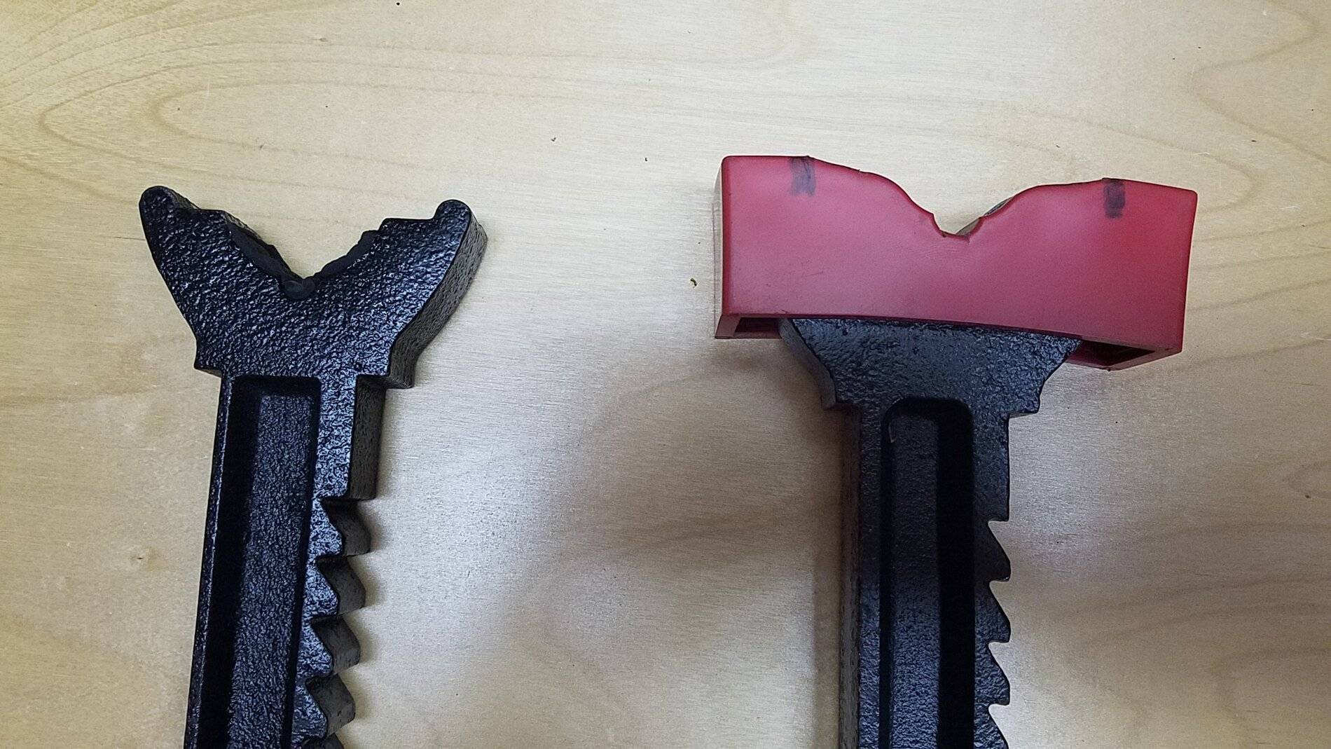

I have the exact same setup as OP. I use HF stands, and they have the deep U. (Some models were flatter.) But I also use their special rubber pads on top. I used a marker to draw a line where each lip at the end of the top is located. This helps me to position the stand laterally so that it aligns like the After photo in OP's post.

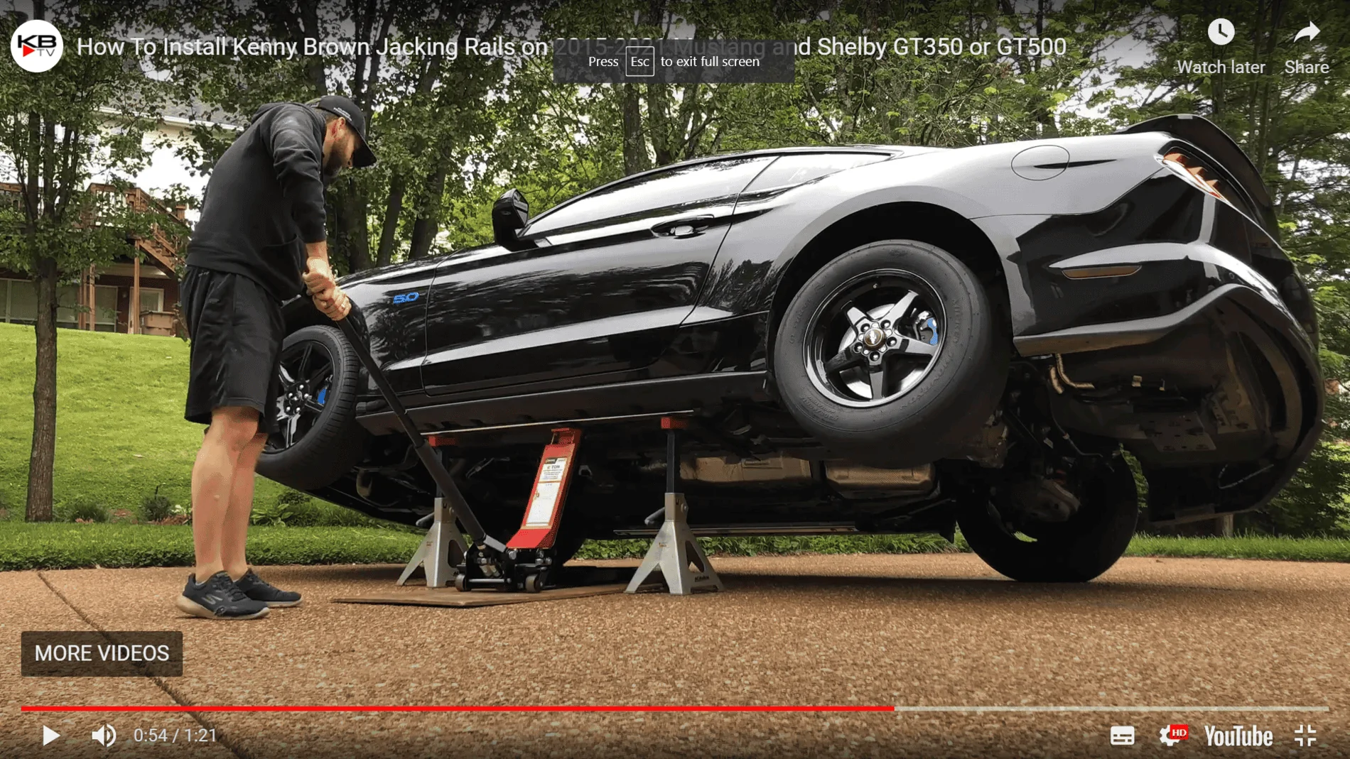

I'm surprised I've never seen anyone mention Kenny Brown Jacking rails. They are angled so they are parallel with the ground.
I could see why, first i like, them seeing them. Had I known about those, they would be on the car.
So to answer the question, 2 reason come to mind.
1 who knew I did not
2 the wallet
They are worth the 150, from where I stand. Being a firm believer in one gets what they pay for. These are the perfect example of that statement, purpose built.

I get the angled thing if you are using quick jacks all the time :sunglasses: But for other situations, wouldn't the angle actually work against you ?
Based on this scenario from the promotional video :
The angled rail is working against you and providing a more angled jacking surface than a flat rail when the car is in the most elevated / most unstable position ? (Flat rail is lower on the outer edge so it becomes more parallel to the ground as the car is lifted)

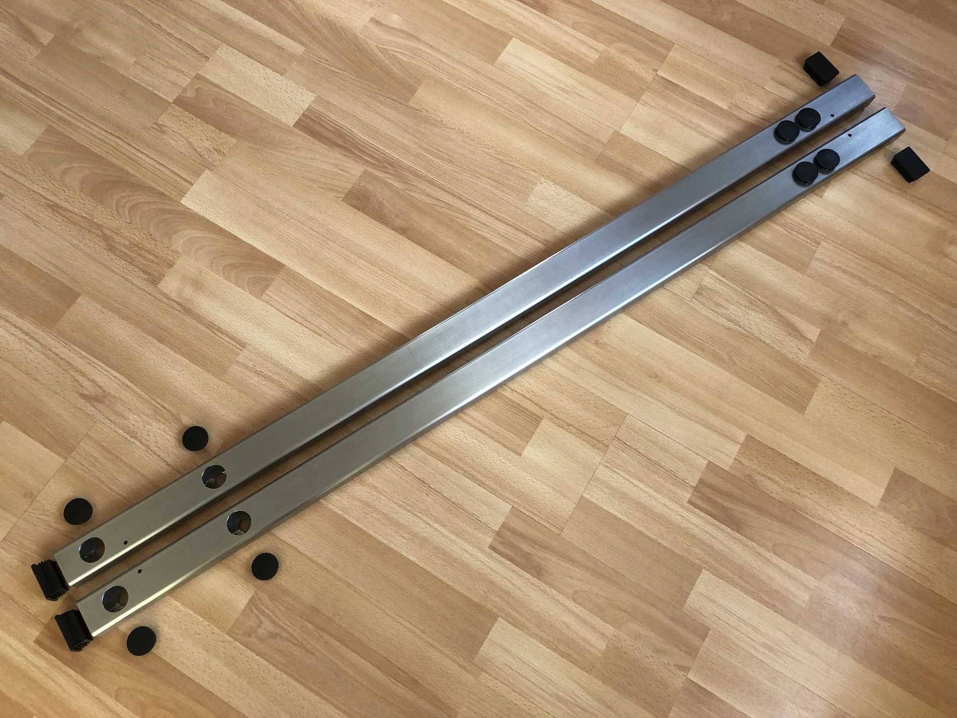

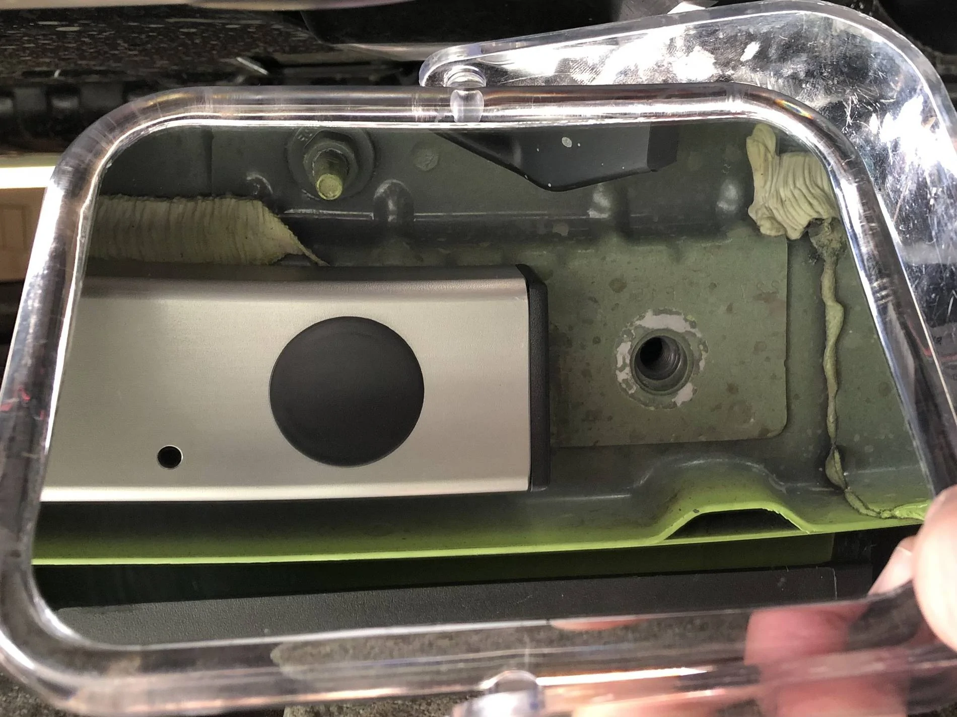

Funny & timely, wondered the same. Looking at the web page figuring it out. It looks like the answer is no they will not interfere.
The holes of course are in the same location, and the material. Beyond them also seems to be the same as the Steeda's.
All characteristics visually the same: Here is the answer and I say no. The KB rails will fit fine, pictured are Steeda's.
A little bird has just told me, there could be some Steeda rails for sale shortly ..
What I like about the KB, being flat bottomed installed, is the contact pattern of the blocks.
To nitpick, the results a RCH more of ground clearance.
Just tread carefully and check before comitting the $'s :like:

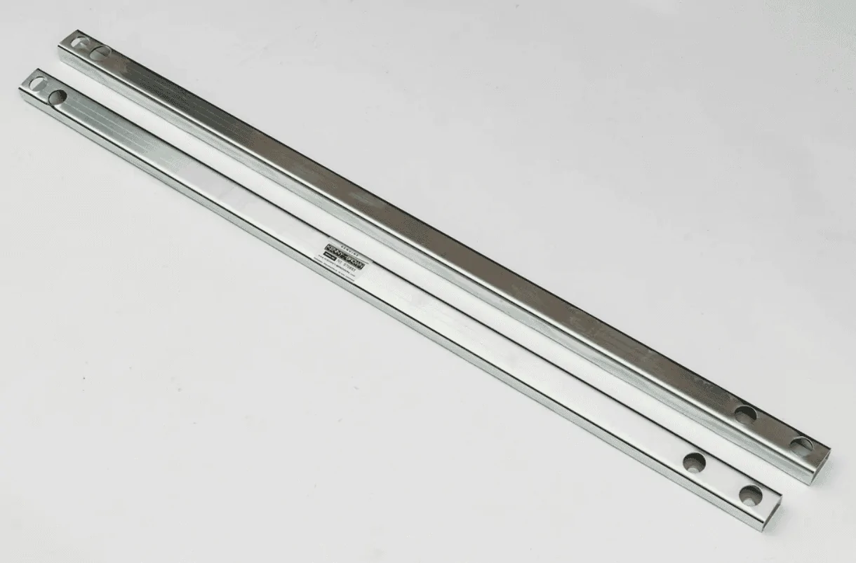

The KB rails :
Front is upper left and rear is bottom right.
Check out the rear spacing of rails that work with the Steeda braces (rear holes bottom left) :
I reckon the KB rails are one (or maybe even two) chassis holes to far back ?
Here is the rearmost hole of the stainless rails and the front most hole used by the Steeda braces :

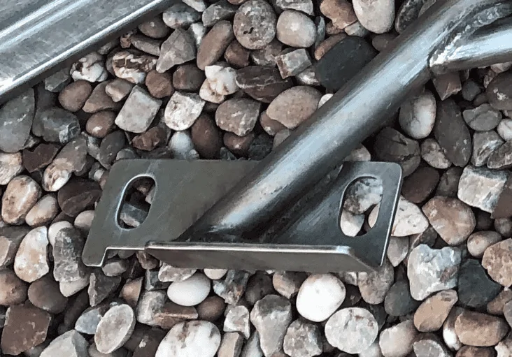

And the Steeda brace with the notch to fit the frame pressing shape :
Hope that helps :like:

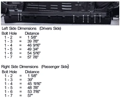

If it helps and if they will share dimensions with you, compare them to this which I collected from this site when I was checking out the details for making mine :
The Steeda braces use holes 5 & 6 (hole 7 is left empty behind the Steeda brace) :
