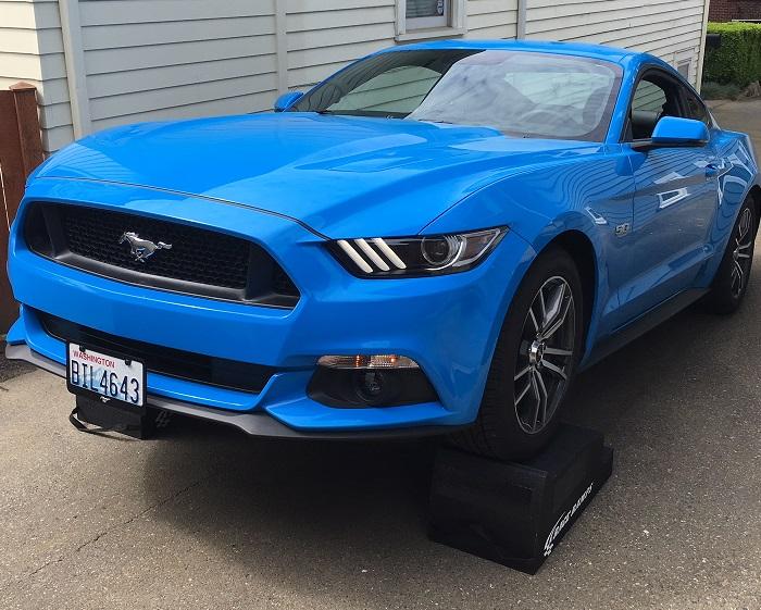

If you point the rails with the short bracket fwd and the bracket lip to the inside they can only be oriented one way. This part IS in the instructions. Doesn't matter if they're different lengths. The bolt holes will simply line up. If you don't orient them correctly the holes won't line up. It's that simple...
First, get a decent set of ramps. Don't do this by feel or with a hand mirror. You really don't need that if you have a decent set of ramps, and having ramps for things like oil changes, and other simple stuff where you'd rather not lift the car is a must with these cars being so low to the ground. And if you're planning on working on this car for other stuff a good set of ramps is something you'll need in your garage.
Another reason to get ramps (and this is the non-erector set part of the install) you have to trim the seam seal in the fronts. It's thick, in the way, and will prevent your bracket from sitting flush against the body and pinch weld, and you won't be able to cut/scrape that away looking at a reflection or "by feel". I trimmed mine with a razor blade, so instead of cutting my damn fingers off I put the front of the car on ramps so I could see what I was doing.
Second, there's no reason why you can't use the hardware included in the kit. The hardware in the kit are grade-8. Bonus for strength. Use them.
Finally, use some threadlocker blue on the bolts. The factory bolts had thread locker added, and whenever I see that I usually think to myself "that's done for a reason" and do what they do.
So I put the car up on the ramps, "dry fit" both rails with all four bolts after I trimmed the seam seal out of the way, then went one bolt at a time, added some threadlocker blue, and torqued to 45 ft/lbs. Drove off the ramps. Done. It took me about 45 minutes, and that included me teaching my 10-year-old son at the same time.
