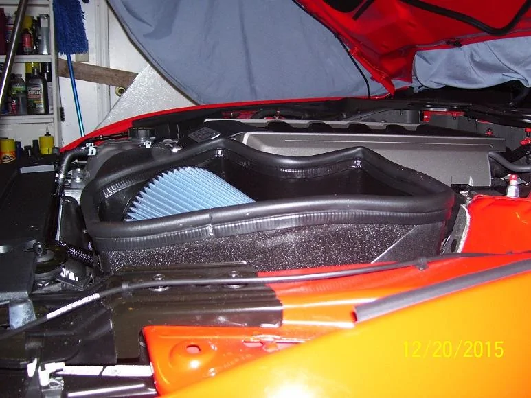

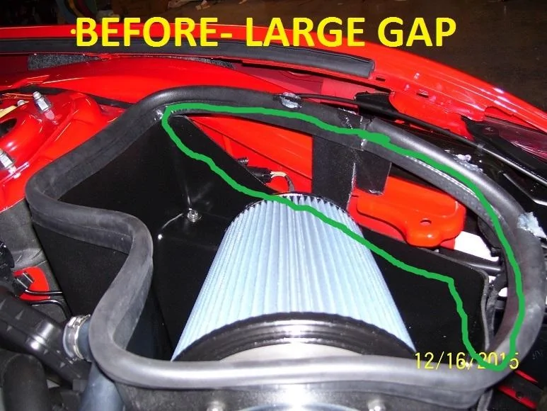

Also, the part about the gt350 cai being open. I would assume it has a much better seal against the hood, than the steeda. On mine, only about 4" section makes contact with the hood.
Here is a before and after pic to seal the Steeda up to hood. But it was a lot of work.:headbonk:

I have bad news for you. Completely sealing that intake to the hood will result in high cht's due to engine bay not cooling enough with only one hood heat extractor. I also tried to seal the intake to the hood with some insulation foam but end up with high cht's instead. Those hood heat extractors are pretty functional. The gt350 hood has the heat extractor located towards the front center area and the cai only seals itself to the hood. It is not the same concept.

The bottom line is the Steeda CAI dissipates heat faster than the production intake, flows much more air than the production intake and runs the same ambient spread if not better than the production intake. Sasuketr is absolutely right, cutting off the extractor will create higher under hood temperatures - with the extractor open it enables the Steeda CAI to dissipate the heat much faster than the closed-box-design CAI’s on the market.=
