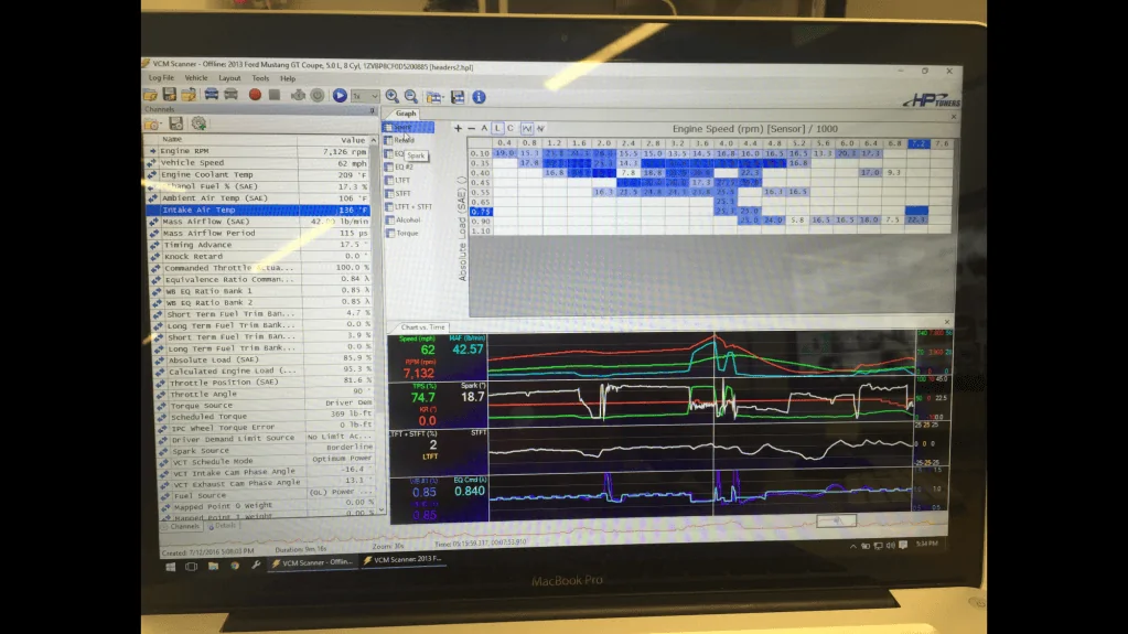

Data log from my friends 2014 5.0 with a open intake in Texas from a few days ago. First run around 90* iats second run close to 140*. Car is on E-30 blend. 10* of timing difference which is a lot. Car has a FF tune, CJ intake mani with a JLT intake, LTs, axle back, etc.

I hope they put an E-85 pump here soon. I do my own tuning so it's nothing for me I just enable flex fuel logic in my tune and add spark and disable or reduce IAT retard in my tune.

WOW...That is a lot of timing being pulled when looking at those 2 pictures.
I would love to be able to tune my own car at somepoint down the road or at least be able to look at the information you have above and be able to decipher all of it and just not 20% of it :)
I am very lucky where I live in GA. There are literally 10 stations that carry E85 within 15 minutes of my house. The closest being 5 minutes away and that one has been testing out at 82-85% @$1.60/gallon, too:D
And if you look there is zero timing pulled due to the knock sensors it's all due to iats. Knock retard (KR on the scanner) is 0.0 in both cases.
