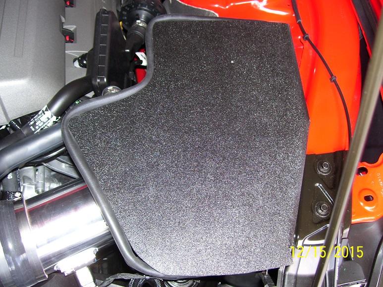

Good luck , I made a few different lids it will help. But I finally sold mine, going with a closed box.

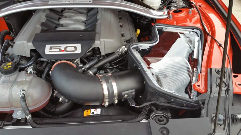

Yesterday cruising around, I was consistently within 5-6° of ambient.
I'm more and more happy with the results.

[MENTION=10893]David@Steeda[/MENTION] check this out.
We need you to chat with the engineering team and get them to work on a cover for your CAI ASAP. These drop in IAT temps are awesome.
Great job, armykyle :first::thumbsup:

Thank you! I'm really happy with the results. It's much quiter too. I didn't realize how noisy the open filter was.

Very nice work on the fabrication... but if you wanted a covered setup, why not just sell the Steeda and get the Injen or Airraid that was actually built that way? Seems like a hassle to ultimately build something that isn't going to be as good as one that was built that way.

buy a $7 Rubber Maid black trash can at Lowes.... 2 big sides to cut out from.
Works great, I have cut them up for several home-made ram air intakes etc.
just my 2 cents. YOU don't really need a clear lid on the airbox, as it will get scratched and dirty.
...OR, maybe just put the backing tape the whole way around it "under" so it looks solid/uniform.
they do help IATs.
