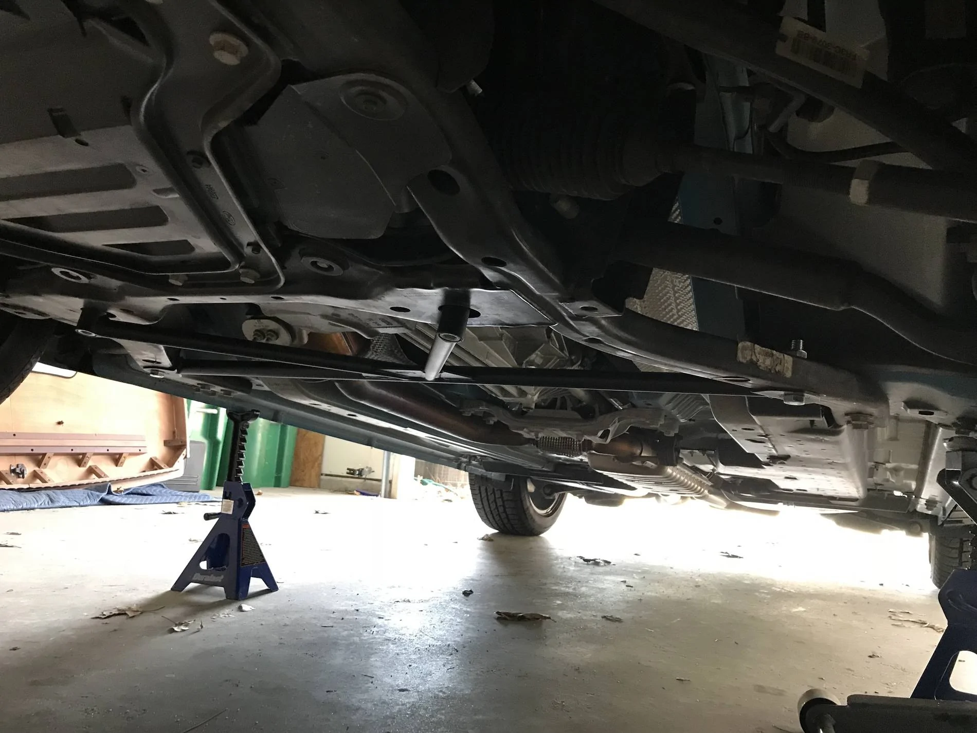

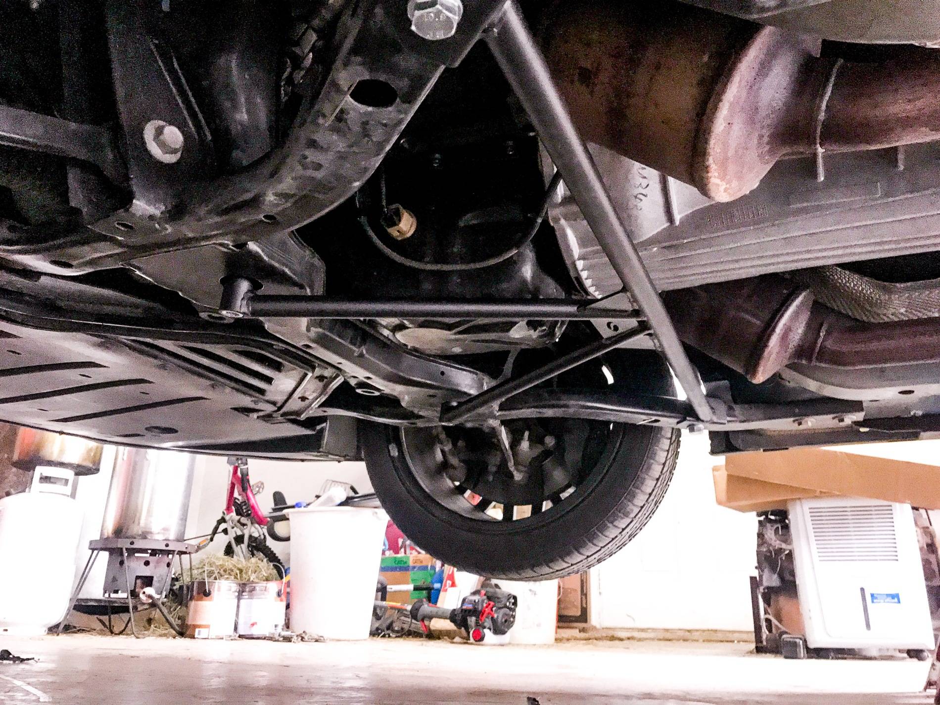

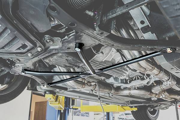

Do you know where I could find a picture of this mounted on the car? I would like to see how this supports things compared to the Steeda one. Steeda has a photo of it mounted. But, BMR does not.
