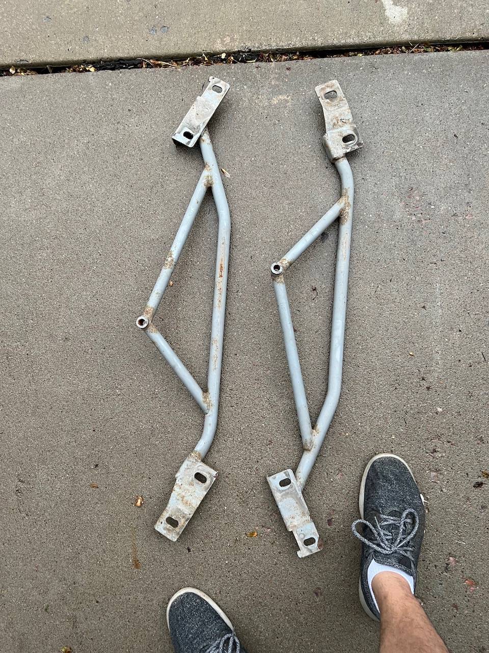

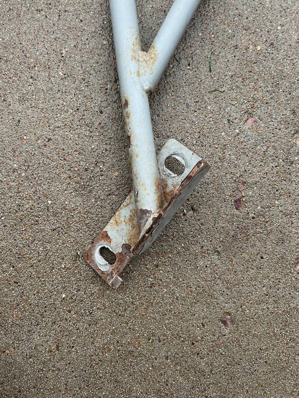

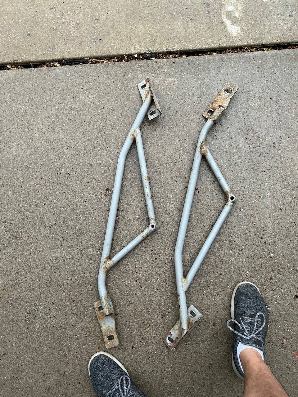

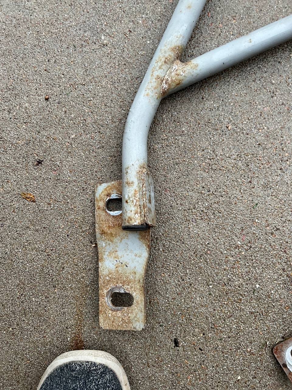

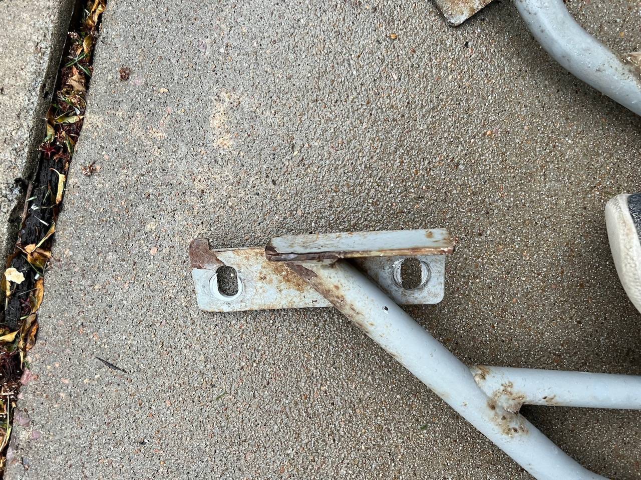

I was working under the car today and pulled off my Steeda IRS braces after seeing the condition they were in. They were installed on the car in Nov 2018, and this is the state they are in after three years. The paint has failed completely and the steel underneath has a thick layer of rust. The brown that you see all over is rust coming to the surface and not dirt.
On the other hand, the BMR front subframe brace and jacking rails that were installed at the same time are in perfect shape.

Yeah that's why I took them off. But it's BS that I should have to do that so quickly especially since the BMR stuff is holding up just fine.

Yes, you can reach out to us & provide your information - since Steeda parts are covered under a lifetime warranty.
We have several 1000s of IRS braces on the market - I can assure you, this isn't a quality control issue.
Oftentimes, that is surface rust & does not have any adverse effects on the integrity of the part itself.
Please provide your contact info to tim @ steeda so I can run this through our warranty product.

Yeah but there is rust on the upper part of the braces as well, which won't be hit by flying debris. If you look at the close ups, you'll see that the rust is forming underneath the paint/powder coat, which leads me to believe that the surface wasn't prepped properly, or that the coating is permeable somehow.
