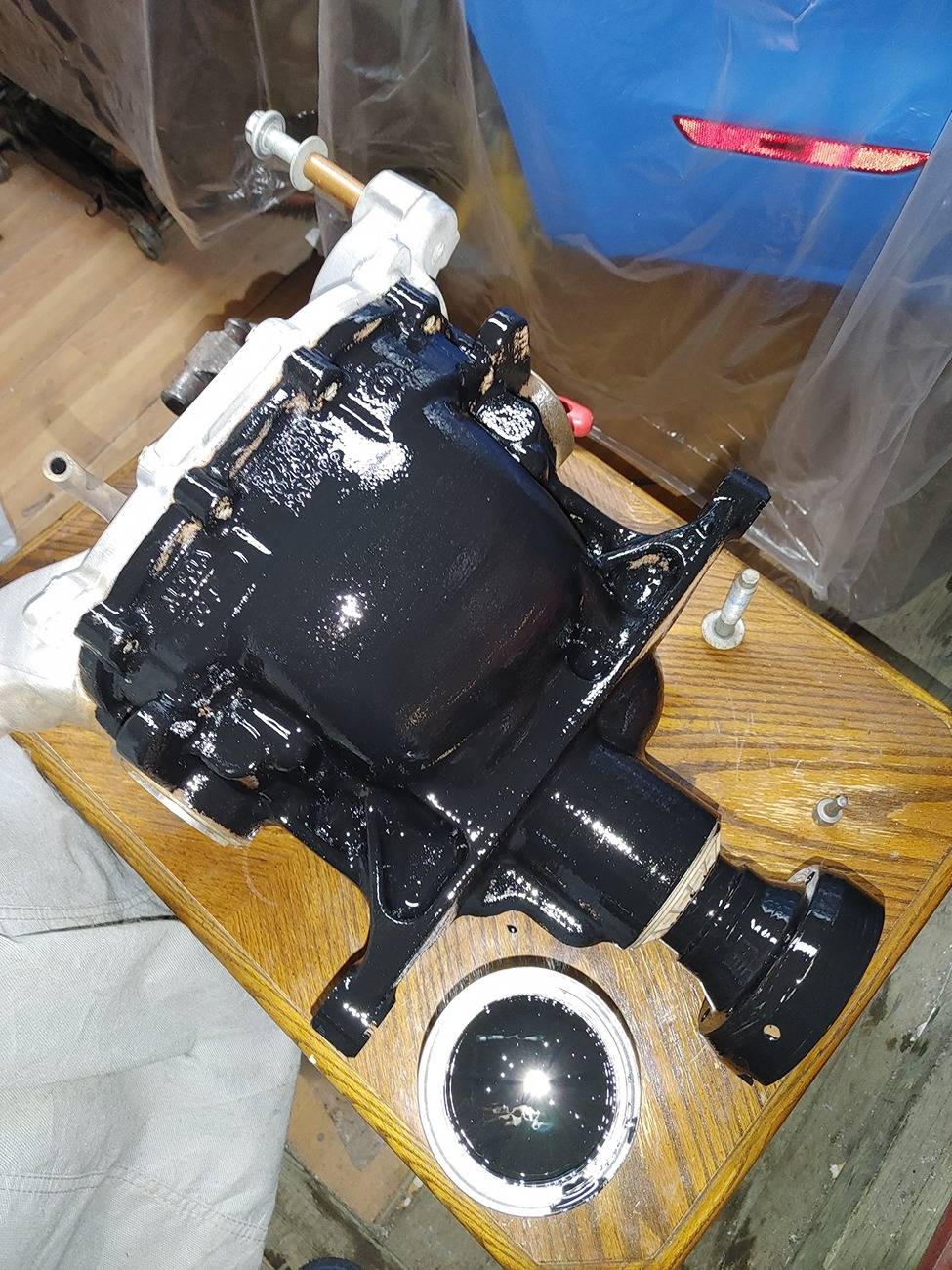

The major problem with torn diff bushing is that the capscrew that passes through the diff has a lot of play, up/down , side/side.
You need to remove that play. So I made my own inserts.
(see here upper right corner of diff.)

What your talking about & what I'm talking about are two separate things. Inserts your talking about sandwich between the diff & rubber bushing.
What I'm taking about is I added inserts to the diff itself.
Since your bushing is torn, my method won't work.
However I would replace the bushing, then use whatever method you want.
