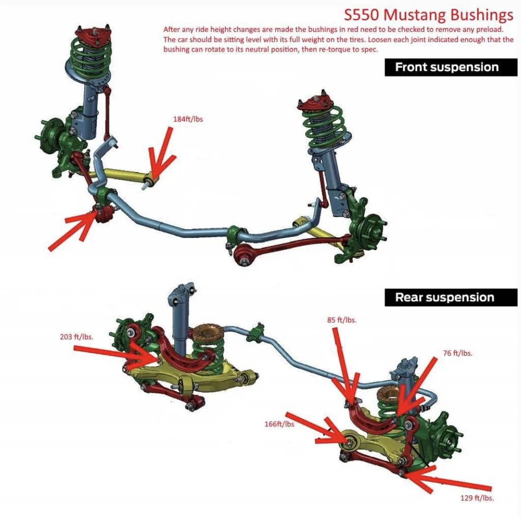

I dont think all the preload is in the sway bars as much as the other suspension components. See attached

As per recommendations from Steeda and the write up in red in your post... all bushings have been clocked and re-torqued......so these load points pointed out should be fine! Thanx for the feedback!!

It should be useful if lowering and keeping the stock PP front sway as i believe the bushings are bonded to the bar.

Yeah if your bushings are clocked properly, then the only preload is if you have a 'PP' front swaybar, which does have the bushing/mounts bonded to the bar at stock ride height. That and the factory front endlinks bend very easily (or at least the 2016 ones did). IMHO the rear factory endlinks are fine, unless you're trying to corner balance with swaybar preload or something.
