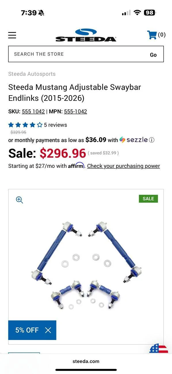

Recently installed Steeda pro active shocks and struts along with Steeda minimum drop lowering springs. Originally reused the OEM top hats as they only had 18,000 miles. Heard some noise going full lock and angling into entrances, so replaced those only to still hear noise. I’m suspecting the culprit at this point is the stock sway bar end links. My question is since they’re adjustable, what do I set them at so they’re correct for my setup?

Check bar angle or measurement with chassis ref point and replicate. If stock bar use stock link ref. I believe they are correct when fully retracted.

I decided to go with MOOG instead to not have adjustable issues.
