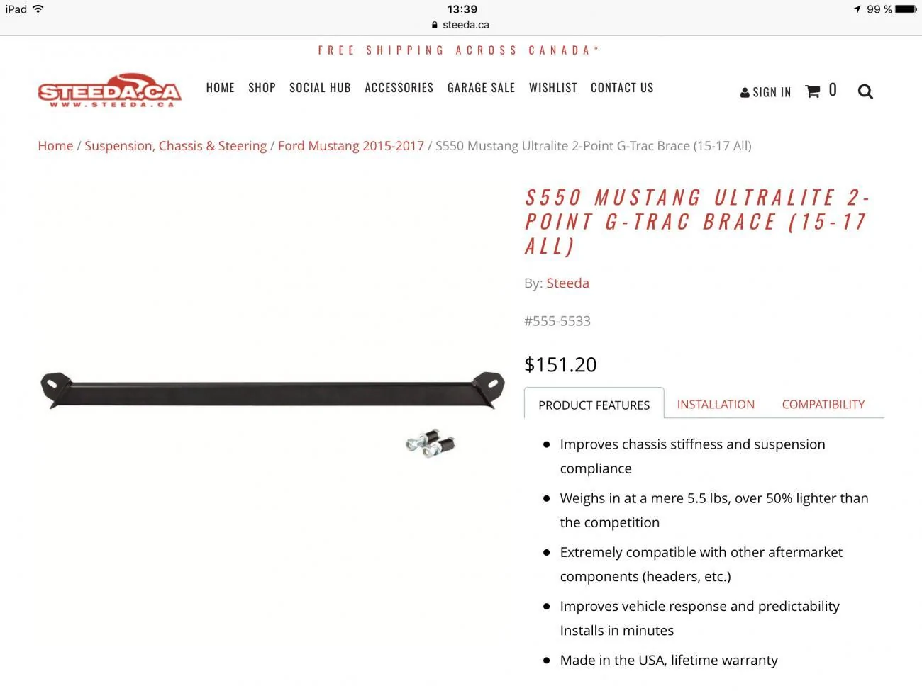

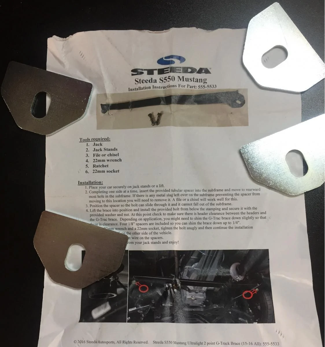

Yes, that's it. Hopefully, it was installed correctly. There is supposed to be a crush sleeve installed within the frame rail at each bolt location - some have had trouble with this - I'd take a close look to make sure they are there. If they are, I'd double check to torque - don't remember the value but it can be found at the Steeda site.
Steeda says 60ft/lbs.

Thanks - I'll check it out. I thought it was a factory brace.
I looked at it again and found a stiff wire poking out of the frame hole in front of the brace that I understand is tacked to the sleeve to allow positioning it - so appears to be installed correctly. I'll do some more checking.

Bolts were just barely snug so I torqued them to 50 lb-ft. Might be a bit light per the specs but much better than the 10 - 15 they were at.
