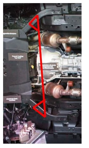

One though I had to improve the design was to triangulate the ends to cover the larger holes, thus improving stiffness further, with minimal weight impact.
Thank you for the feedback & diagram. I am putting this in an email for our manufacturing team - Many Thanks!
