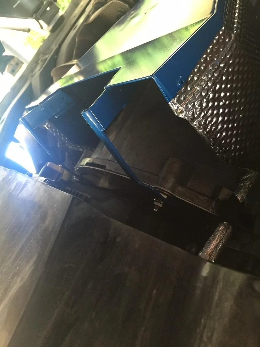

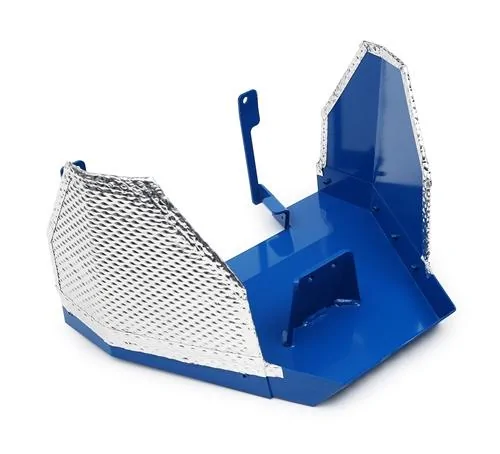

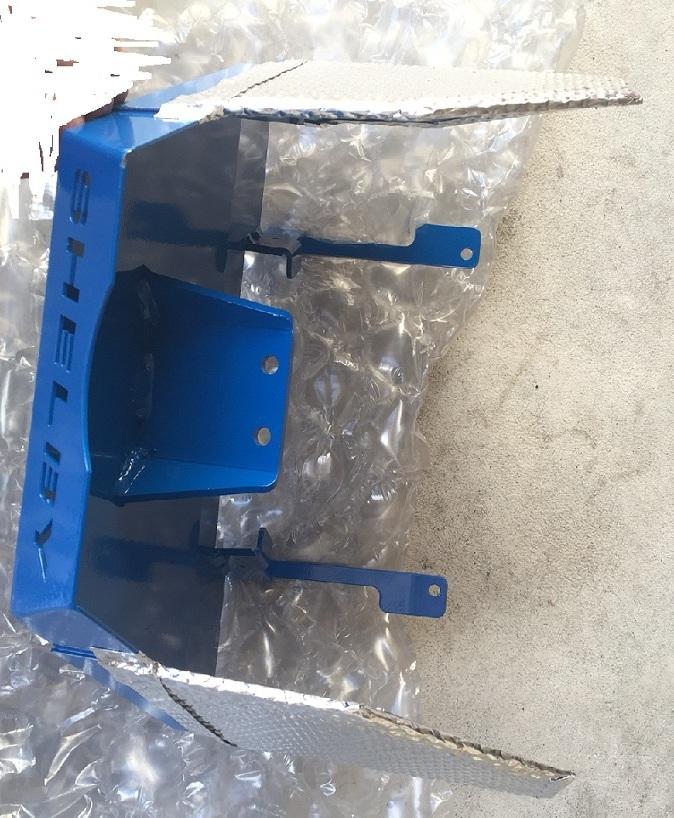

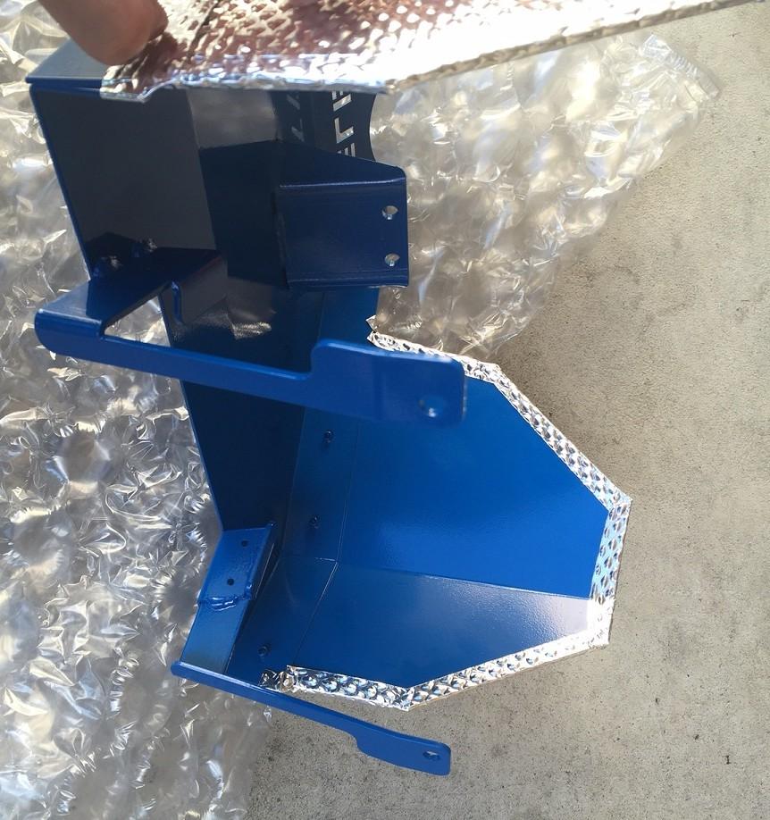

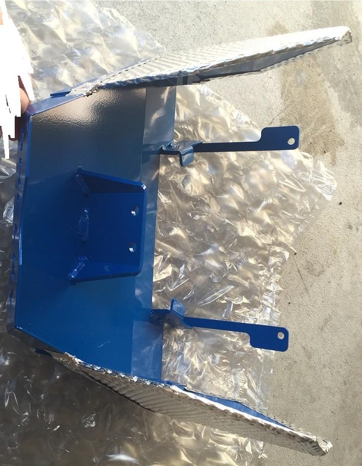

here are some pics of the version 2 of the cooler from Shelby
fit and finish appear to be pretty high, installed within 20mins and fitment is very good
will test it out on track this weekend and see how it goes.
here is a pic of version 1 in comparison, version 2 seems to be beefed up, with stronger T-brackets and stronger arms.
