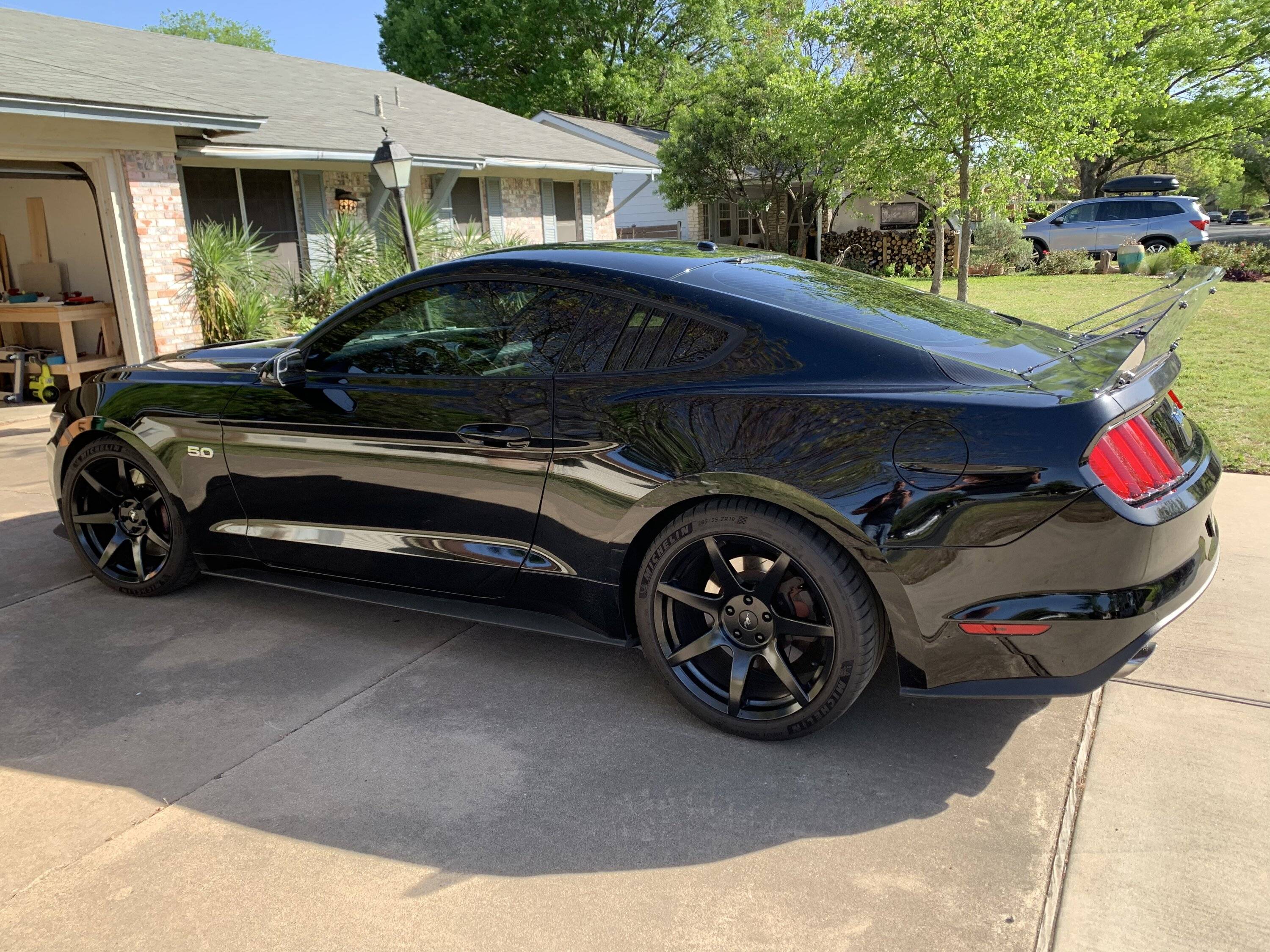

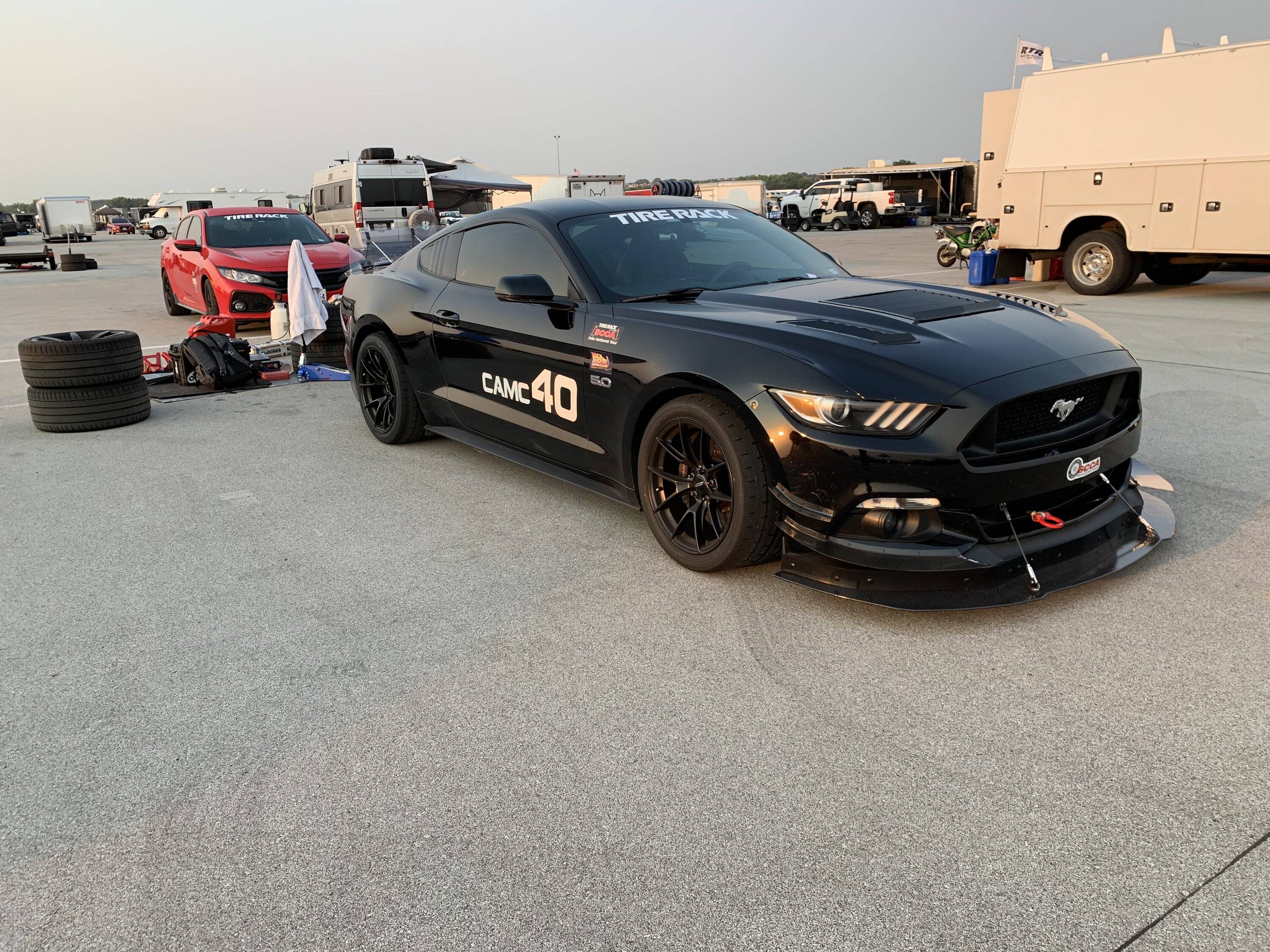

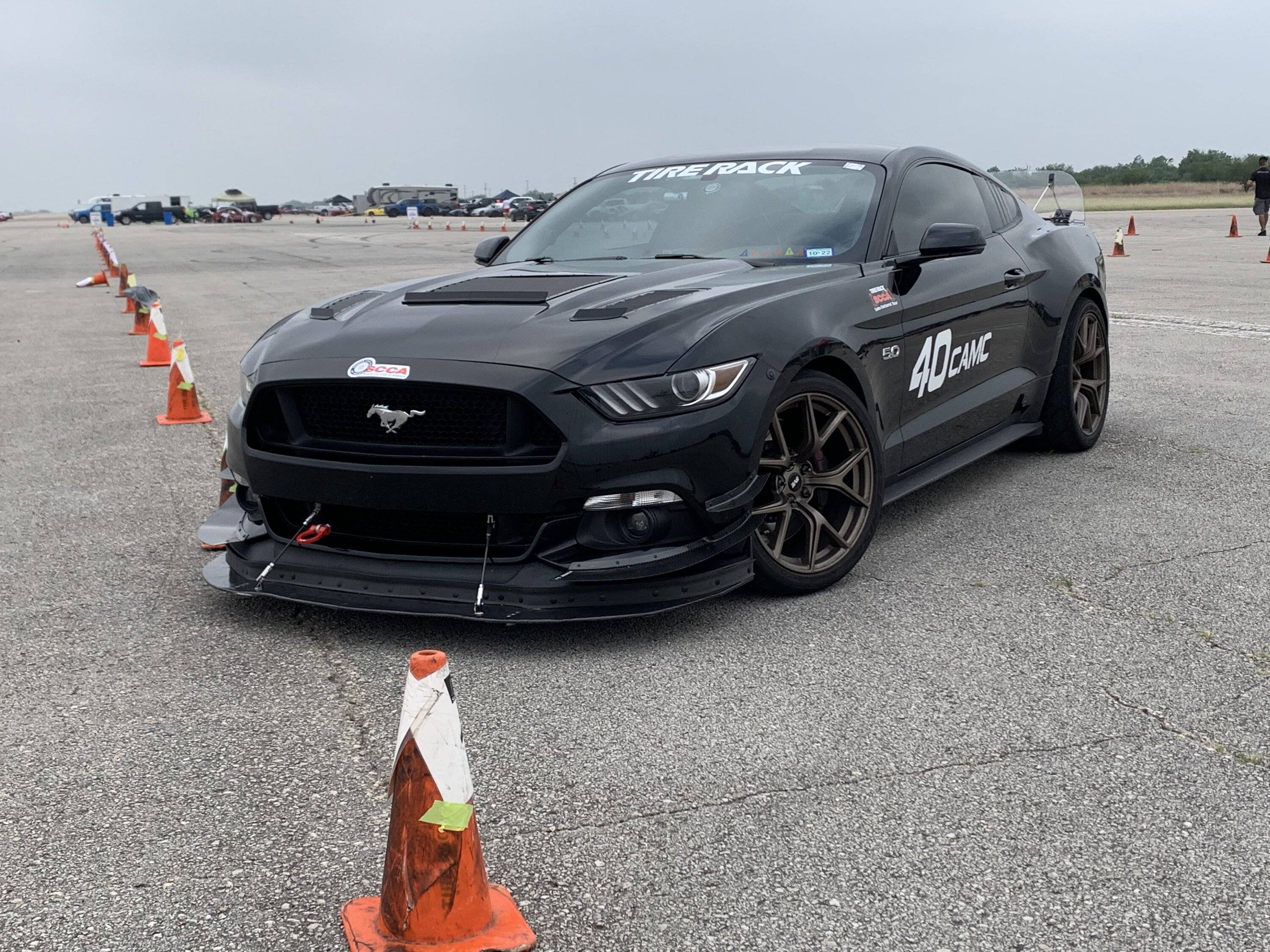

photos - 19x10 square with 285, 19x11 square with 315s, and 18x11/12 staggered with 315s
