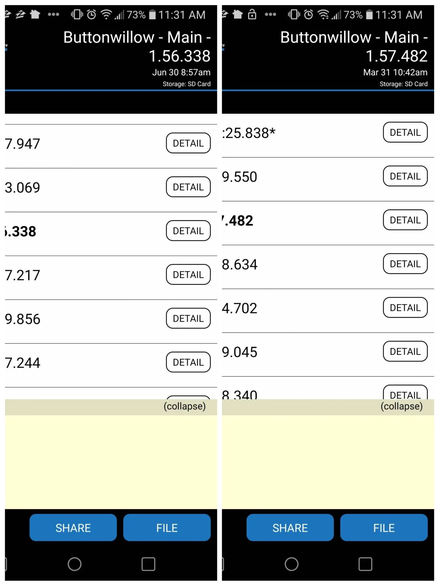

Medium seems to work fine. According also to cortex.
Body roll is huge issue in my 3789lbs car.
However
What i found out is a medium sway bar seems to work better with bigger tires (305)
While it is easier to overdrive and then understeer a 285mm tire. (I use the 285 for time trials due to class limit)
Next year i will move to a real coilovers system (probably JRi)
But I'm running like many shelbys now with FP and Bmr shicks/sway bar.
So i think is really a great combo.
Actually I used to run stock struts and Bmr springs and they were good too.
My point is :
a coilovers isn't always faster and 95% of us probably don't need them in the first 2 years of hard tracking.
