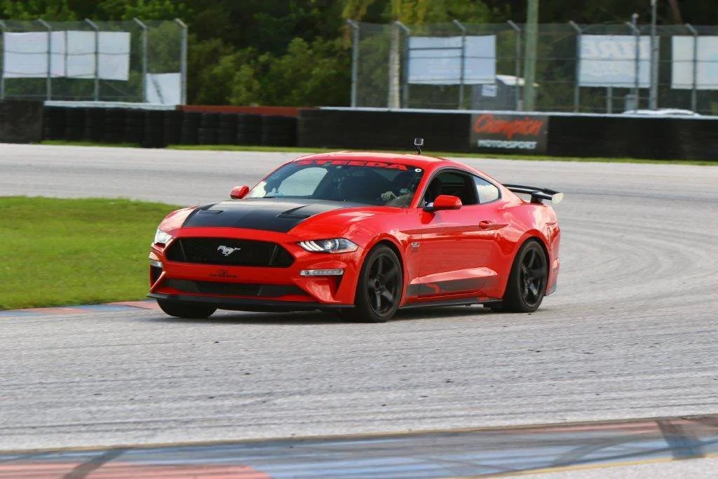

Will these springs pair well with the FP Track dampers? I already have these shocks/struts new in the box and am looking for spring options.
Yes,they will work just fine. You will be impressed on the ride quality as well on the street.

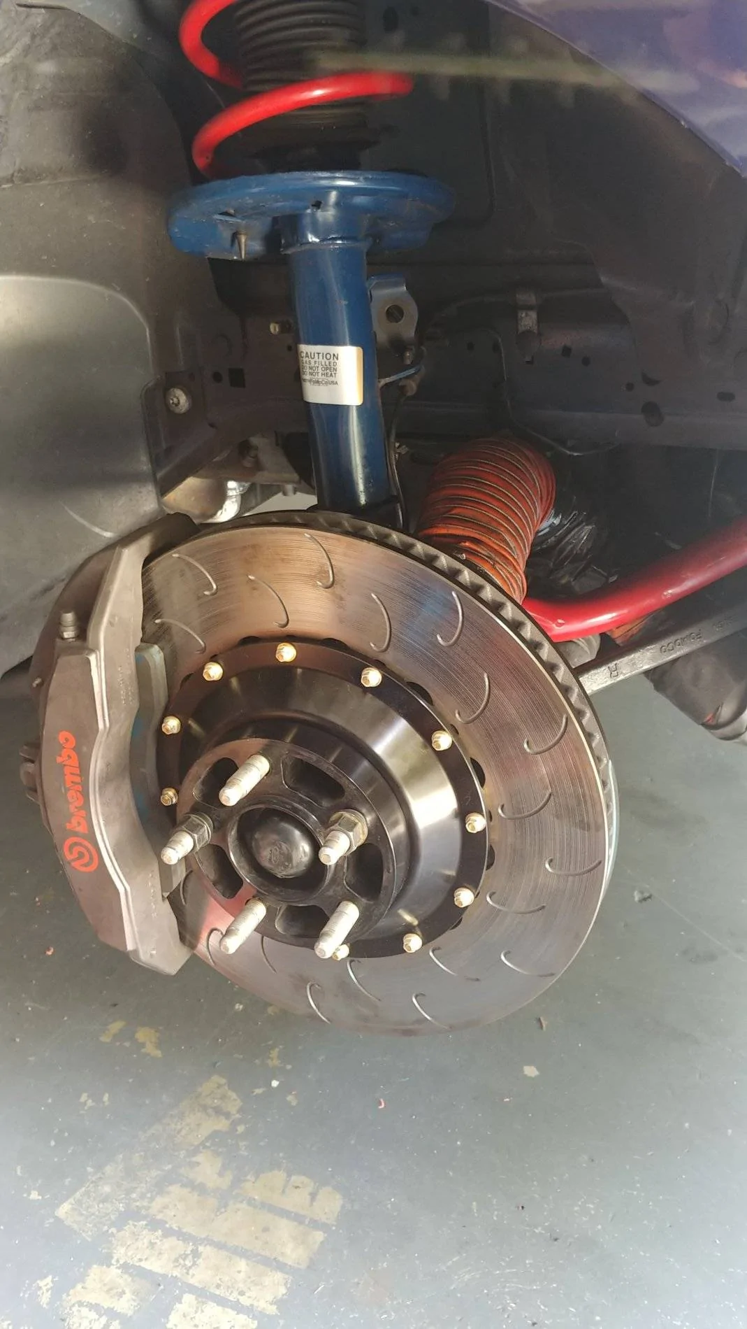

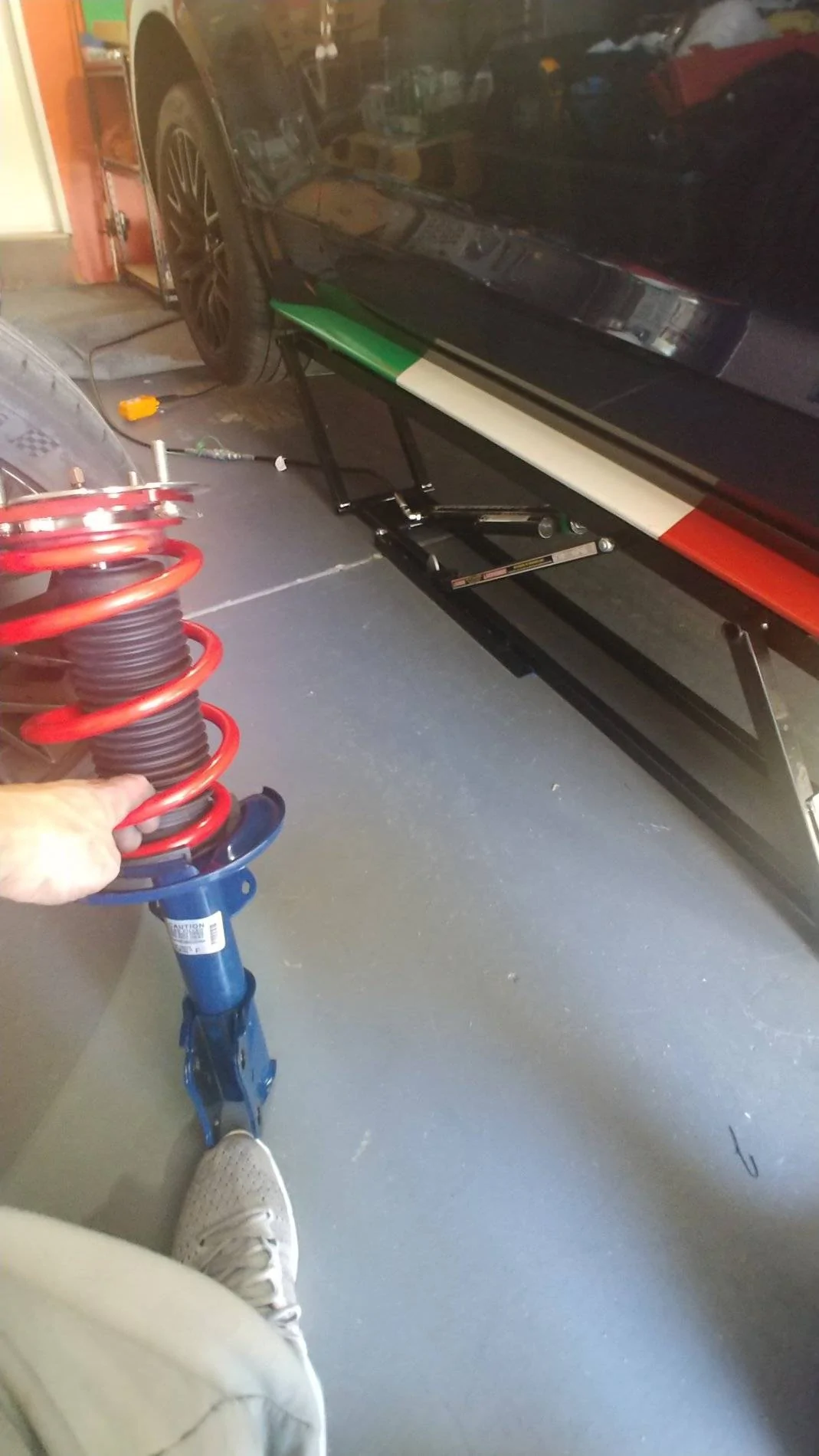

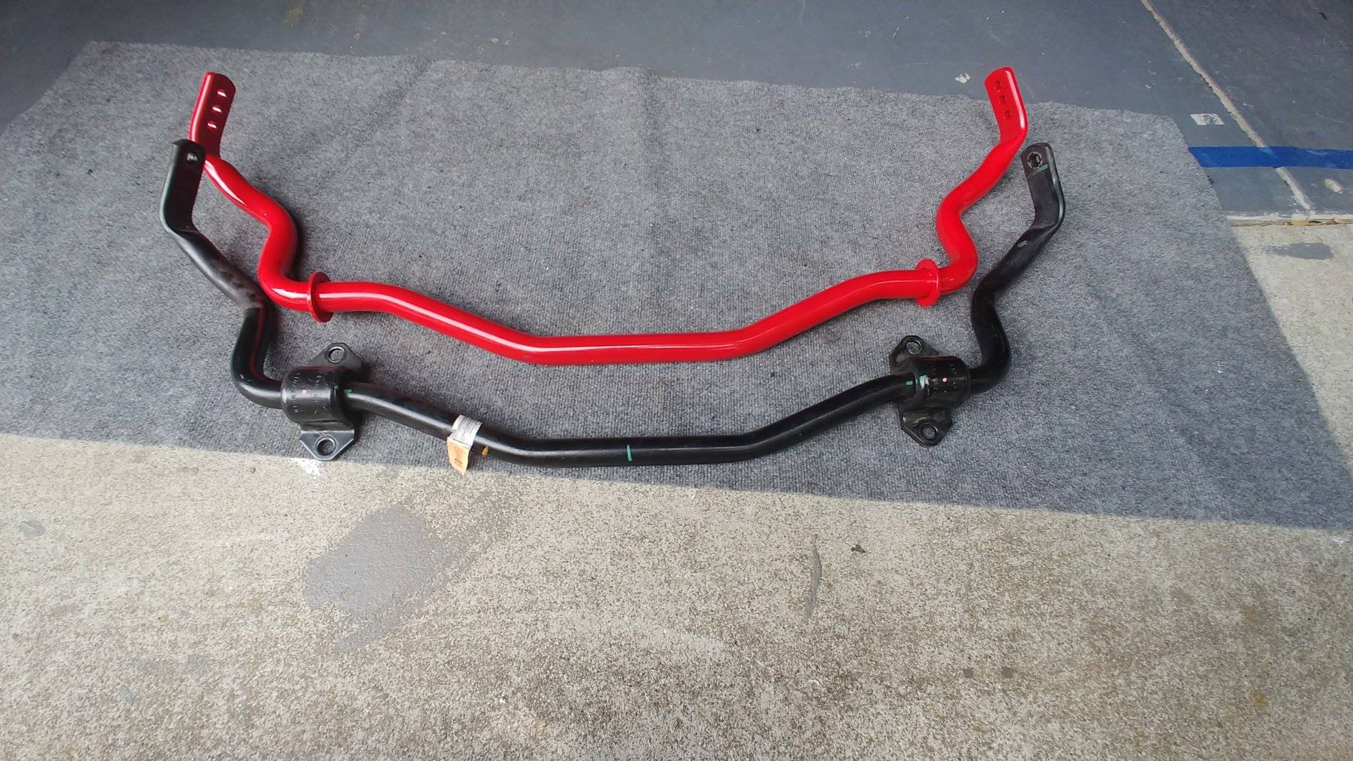

The FP with the bmr handling springs work awesome. I paired them after 3 months with Bmr front sway bar. Medium.
I went 1second faster at Buttonwillow,CA.
i personally believe that it must be a combo between spring rate and sway bar.
Of course all connected with a good amount of camber(-3 front)
My car is very precise in turn entry and with the bmr sway bar I do have a better stability also in heavy fast Change direction.
The 250/980.linear combo seems to perform great wkth FP struts.
