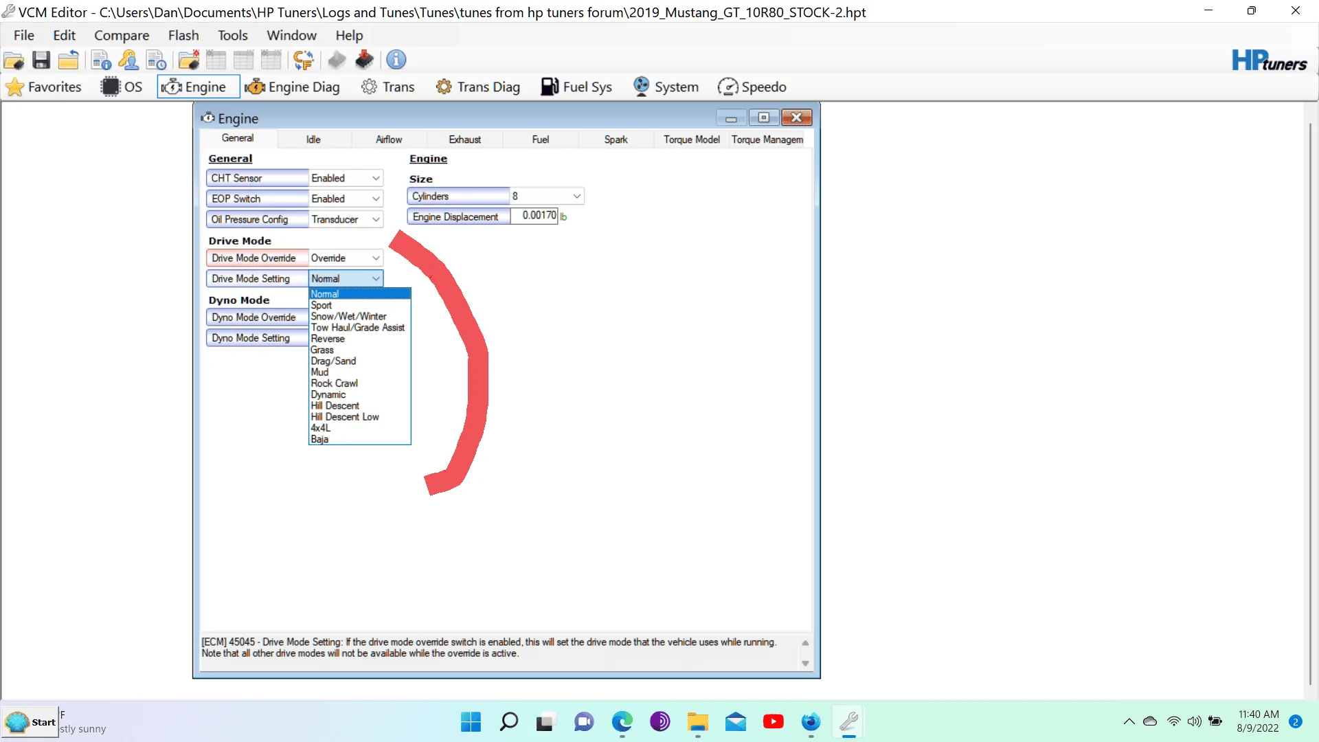

K4fxd is on the right track. This can absolutely be done in HPTuners. But the way it would work is that the shift character, shift point, torque management, and active exhaust settings could just be swapped from D to S+. Basically, it would still show up as D on the dashboard display and/or shift lever, but D would act exactly like S+ does now and vice versa. You can mix-match all sorts of stuff however you like. For instance, when my car is in "S", it uses Drag mode shift character but Drive mode torque management, and custom shift points.

Just a WAG because I don't have a 3rd gen and never tried it.
A tuner might be able to override the normal default to any of these drive modes.
Thanks K4fxd, I asked a local tuner who said he could not do. What you are suggesting makes sense. I will ask someone else who specializes in Mustangs.
