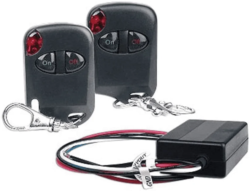

Basically what I did was hook up a remote control to the active exhaust fuse using the two items below and in essence created an on/off switch to enable/disable the active exhaust.

Fuse extender: https://www.amazon.com/gp/product/B07TWXMHRV/ref=ppx_yo_dt_b_asin_title_o05_s00?ie=UTF8&psc=1
15amp Remote kit: https://www.amazon.com/gp/product/B00EQB8O7K/ref=ppx_yo_dt_b_asin_title_o06_s00?ie=UTF8&psc=1

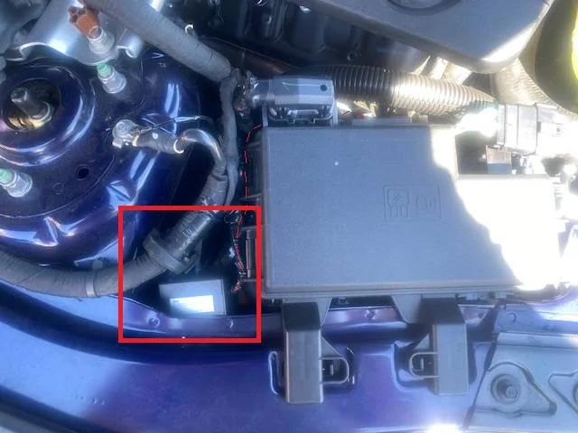

Module tucked away behind fuse box - Ran wire out side of fuse box where the main wires come in. Wire is run towards back of fuse box, going under the other wire harnesses to conceal. Module is tucked on the side and fits perfect. It could be tucked down behind the fuse panel to be completely hidden as well if necessary.

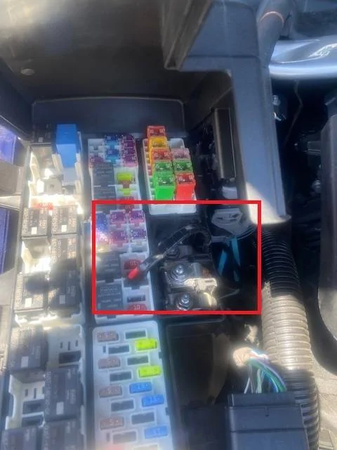

Fuse extender comes out towards side of fuse box, and then down and towards the back.

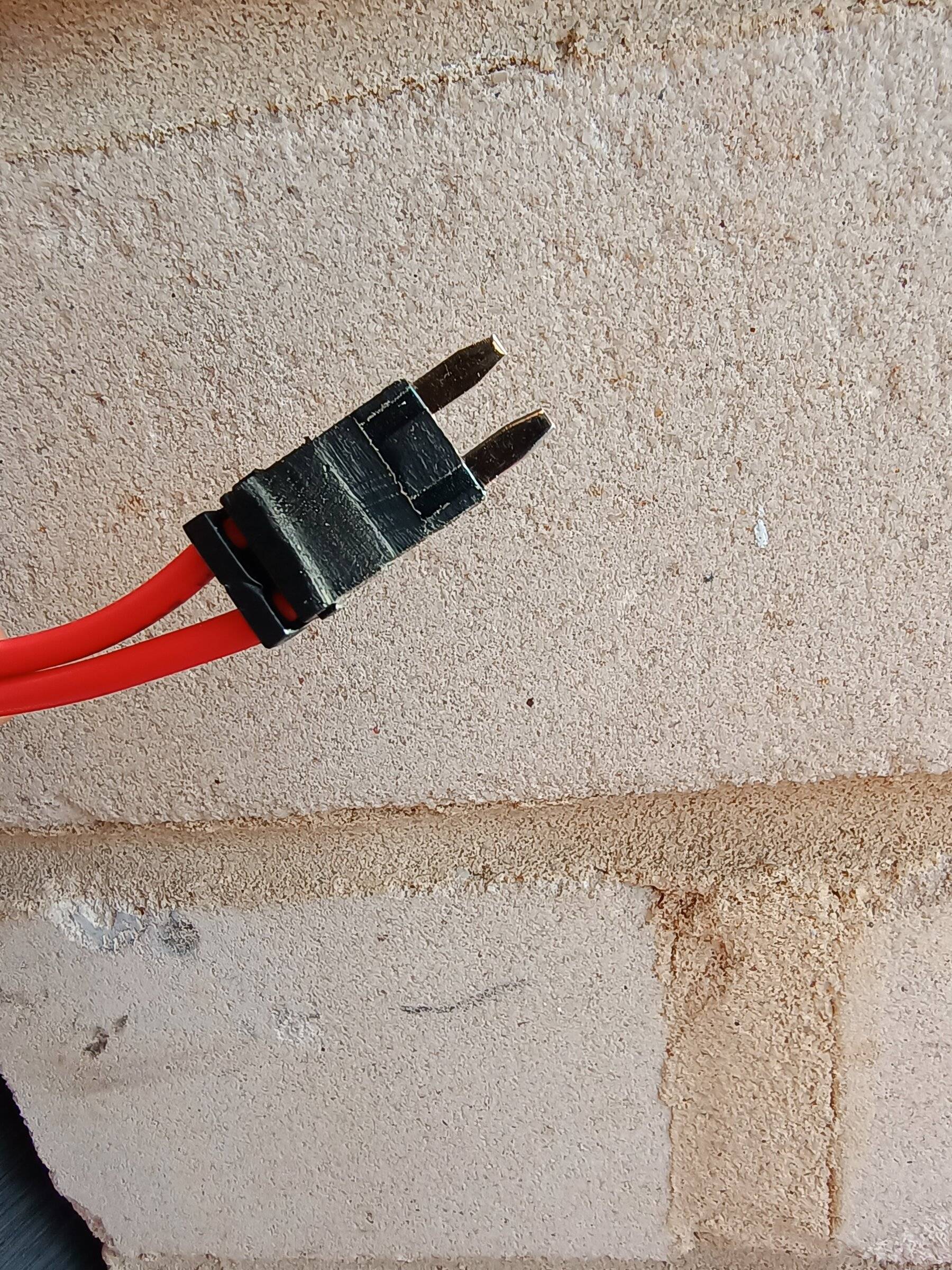

No luck from my end. I tried swapping around the fuse and also swapping the red and white wires and i could not get it to work.
I even tried connect the black to ground and disconnecting the black to ground.
Are you able to send me a photo of your wiring?
Also, i managed to get my fuse holder fit snug. All i did was slightly file black plastic around the fuse. See photo.
