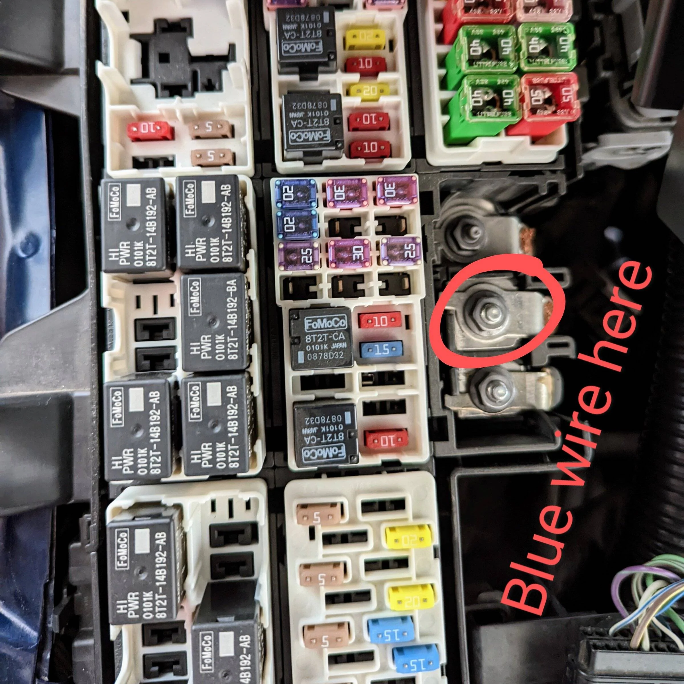

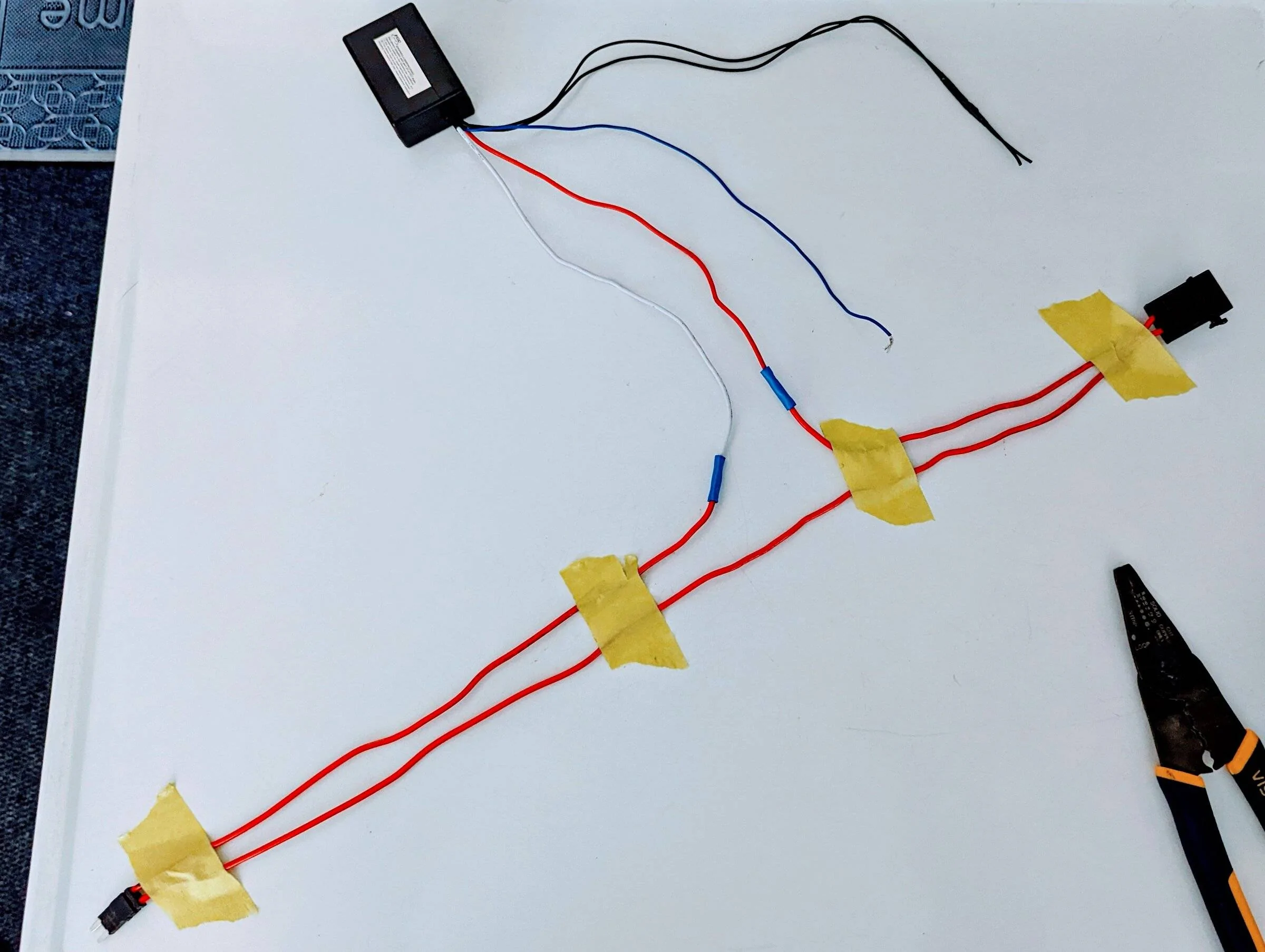

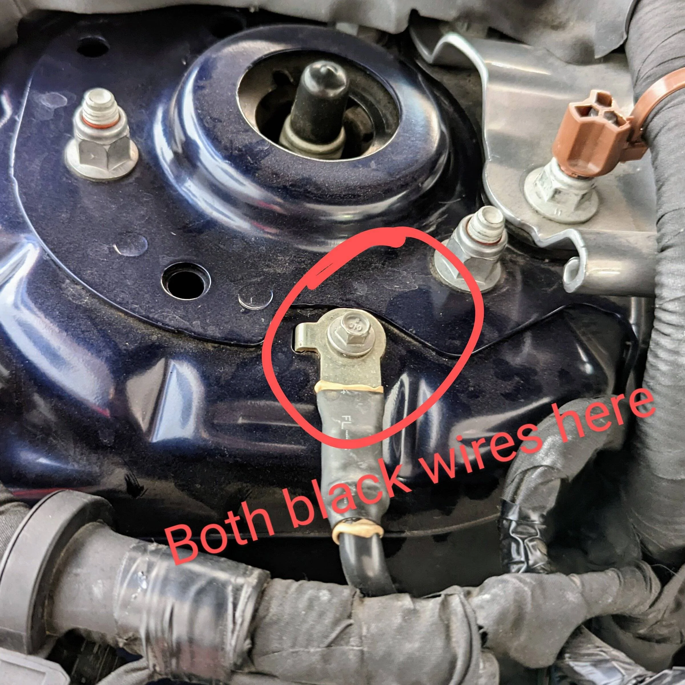

Yeah I'll take a couple pics for ya on Monday when I'm off work!No luck from my end. I tried swapping around the fuse and also swapping the red and white wires and i could not get it to work.
I even tried connect the black to ground and disconnecting the black to ground.
Are you able to send me a photo of your wiring?
