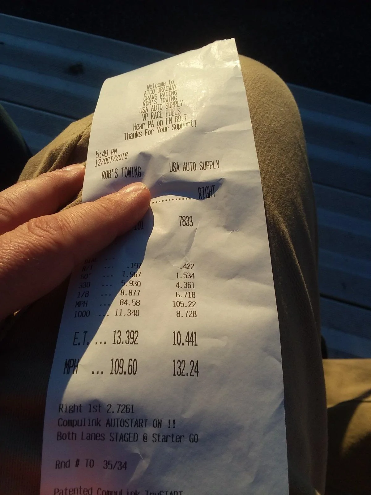

Spinning to a low 10. Hit atco tonight. As usual. Prep sucked. Best run of the night was a 10.33@135. Just got my 18 manifold installed. And was doing some data logs for Lund. The run pictured had a 10.1 written all over it. Til I blew the tires off on the 1-2 shift. Think im going to try cecil county. Before the season is over. Not having much luck with Atco this year. The car feels like a monster with the 18 mani.
I don't believe the car would have went 10.1 on that pass. Really hard to to say tho.
