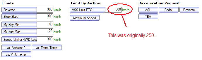

Vlad Soare
Jan 21, 2020

My GT was limited to 155 mph. And I almost reached that speed once. I got to 154 before having to slow down due to traffic.
I've since removed the limiter, but haven't yet had the opportunity to test it.

I'm thinking about taking out the limiter, should be possible with Forscan?
Did you do it by yourself?
Yes, I did it myself, but not with ForScan. The limit is in the PCM, and ForScan can't touch that.
You need a tuning device and software. I used the one from HPTuners.
This is what I see for mine:
