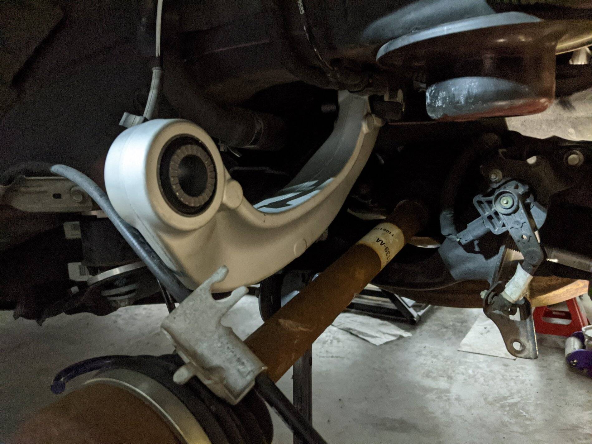

Pic with a lot of parts (lower control arm, knuckle, shock and spring) out of the way.
