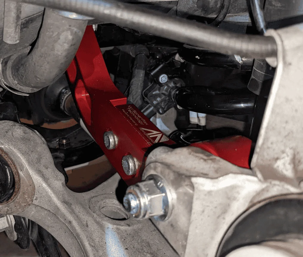

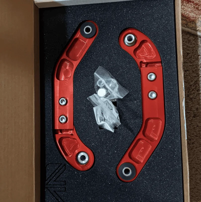

Two other things. AAD camber arms are machined beautifully, if that is something you appreciate. And their customer service is top notch. I was installing on a Friday night, and they gave me the main guy for the S550 cell phone number, and said to message him with any issues that night.
As for toe links, I would recommend a turnbuckle style. I had the AAD toe links, and my problem was I couldn't get it as precise as I wanted. Ended up with J&M toe links. With the turnbuckle style, you figure out how much one flat changes the toe, which makes the adjustment very repeatable if you are going track to street.
FYI - AAD will machine smaller increment tabs for you in order to get the precision you want.
