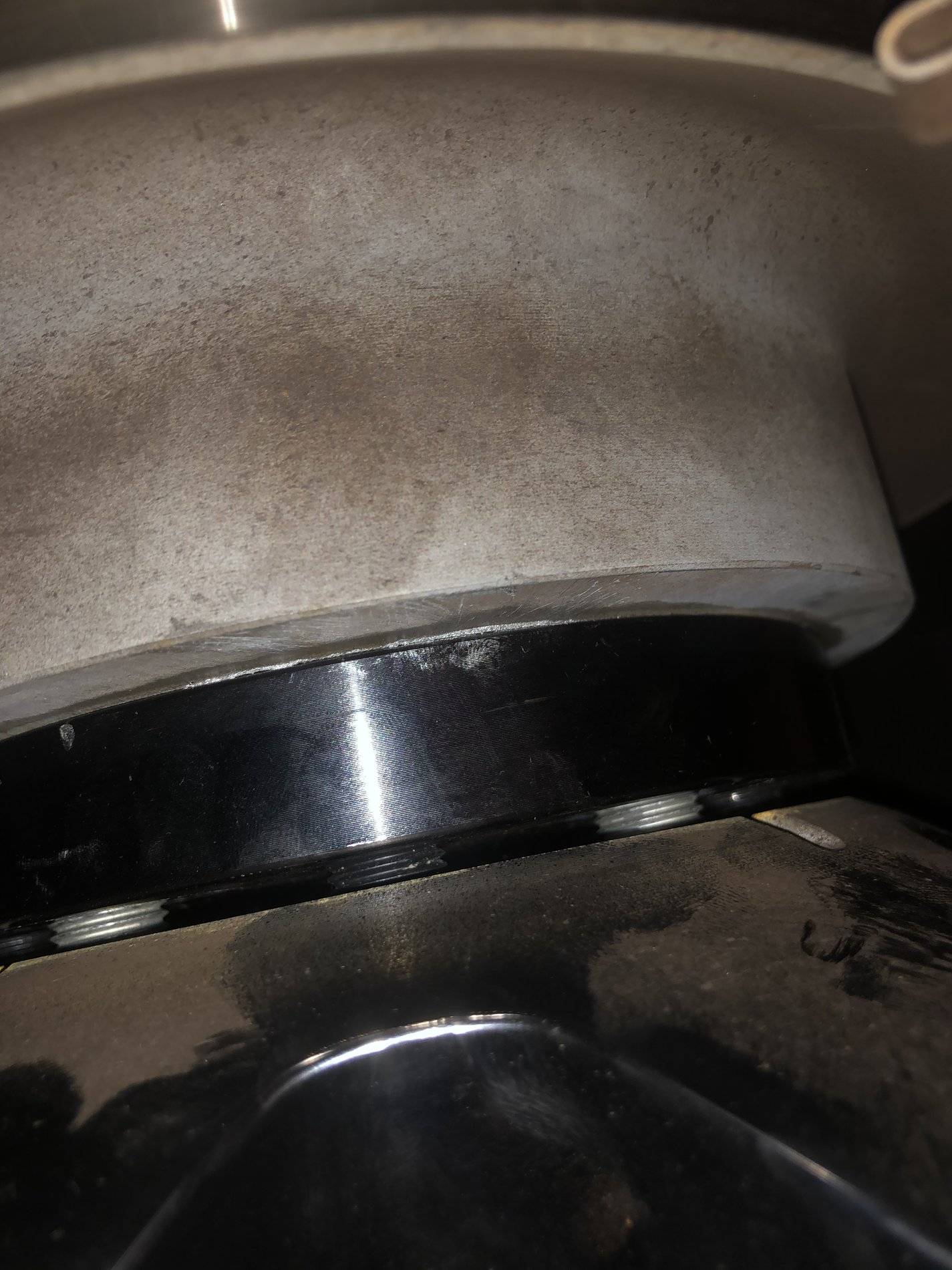

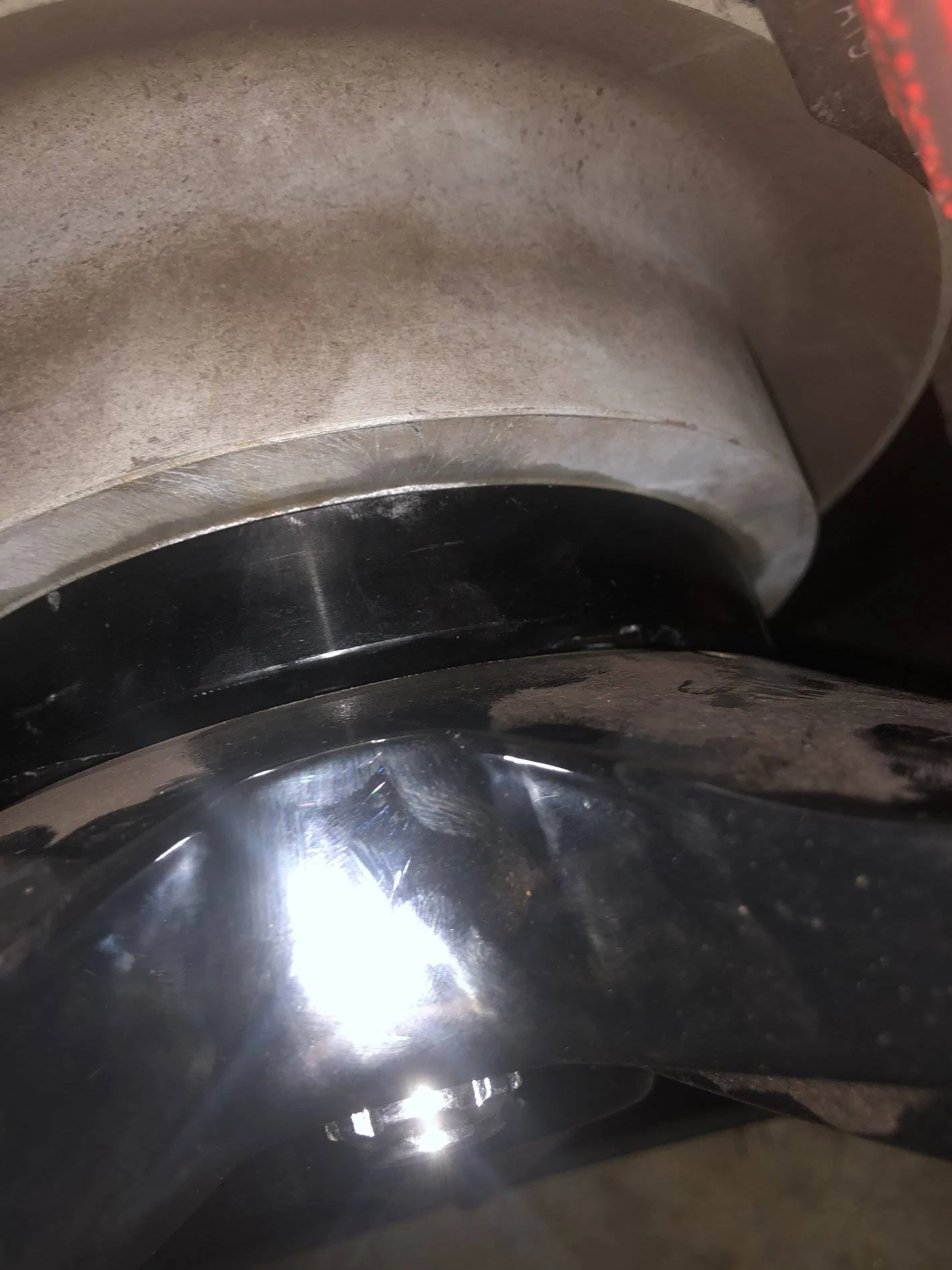

Hey I put the 20mm spacers on and I noticed that there’s a gap between the wheel and spacer. It looks like the stock studs are hitting the wheel. Did I do something wrong?
Do you have aftermarket wheels?
Stock wheels have a relief on the back of the flange that the stock studs will fit into, many aftermarket wheels do not have this
