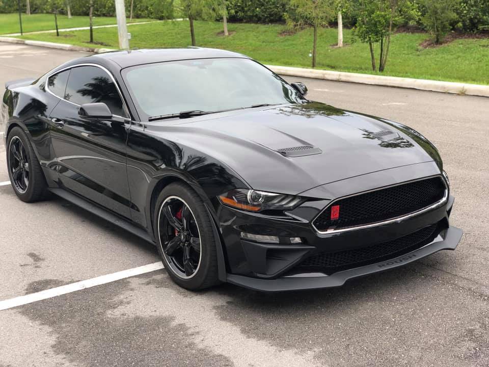

TLW1022
Mar 17, 2019
111
100
Coconut Creek FL
Terry
2019 Bullitt K3464
Steeda 1.00"/25mm Spacers front & rear
Completely changes looks of the car

Blownfx
May 7, 2020
Lehigh valley
John
2019 Bullit
Just as an FYI, 52mm is OVER 2 INCHES :D. 1 inch = 25.4 mm.
Really, I am not fluid with metric units.
But that is what I thought I remembered from when I bought them.(which was a while ago). They are definitely not 2" so I must have transposed the numbers in my head. I would have to change that to 25 mm. Then. Thanks for the heads up.

Blownfx
May 7, 2020
Lehigh valley
John
2019 Bullit
This is not functional at all and I really really don't want to be mean but this is gross and looks like a skateboard. Listen to aftermarket companies that make spacers for track purposes. Steeda recommends 1' front and 20mm rear. and this is what it looks like on my car. I didn't use locktite or whatever I just used my tq wrench and tightened them to 150 pounds.
I posted wrong size, mine are 25 mm.
So approx. 1" front and back. I just don't have the fronts on in the picture.
