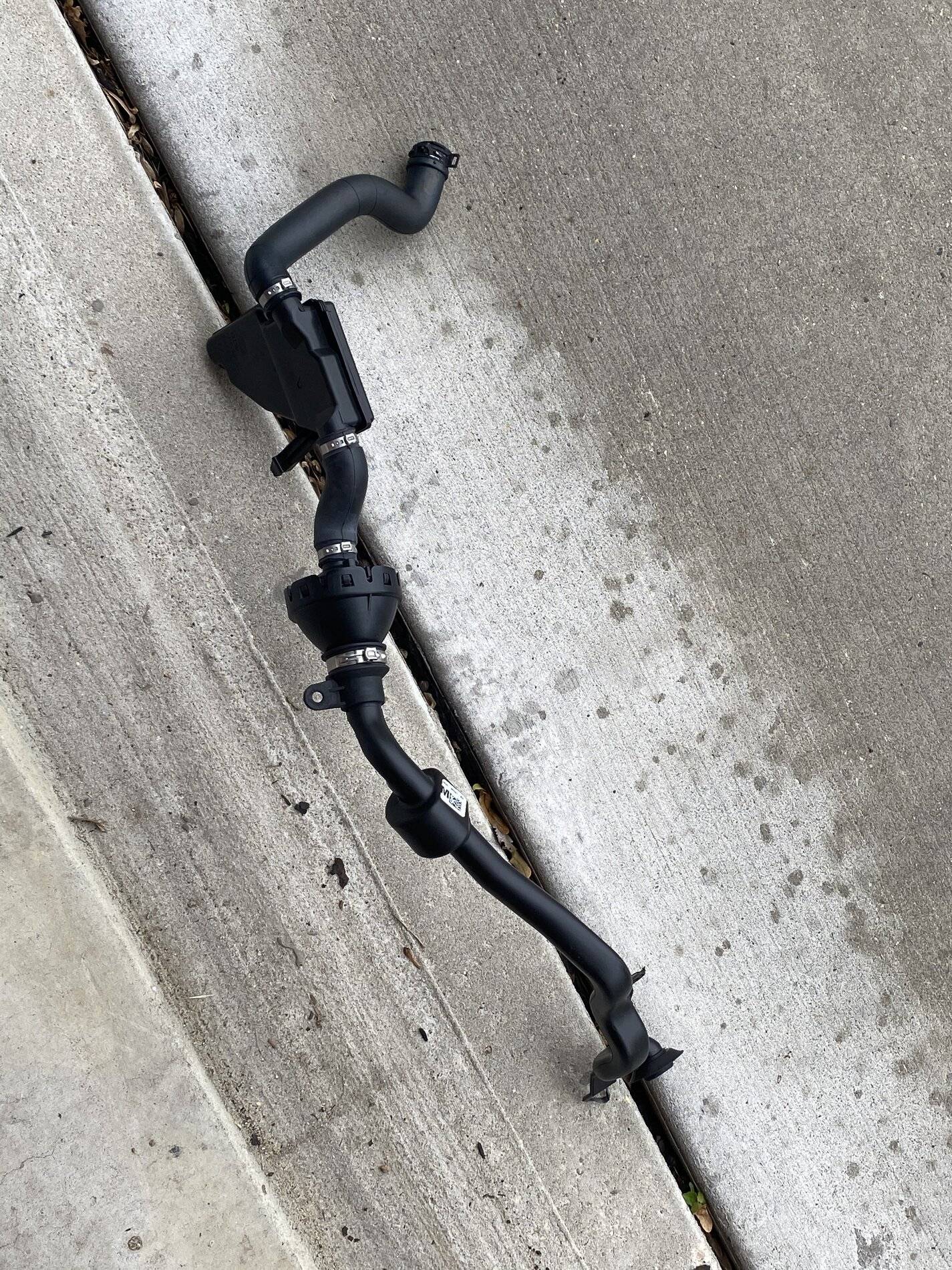

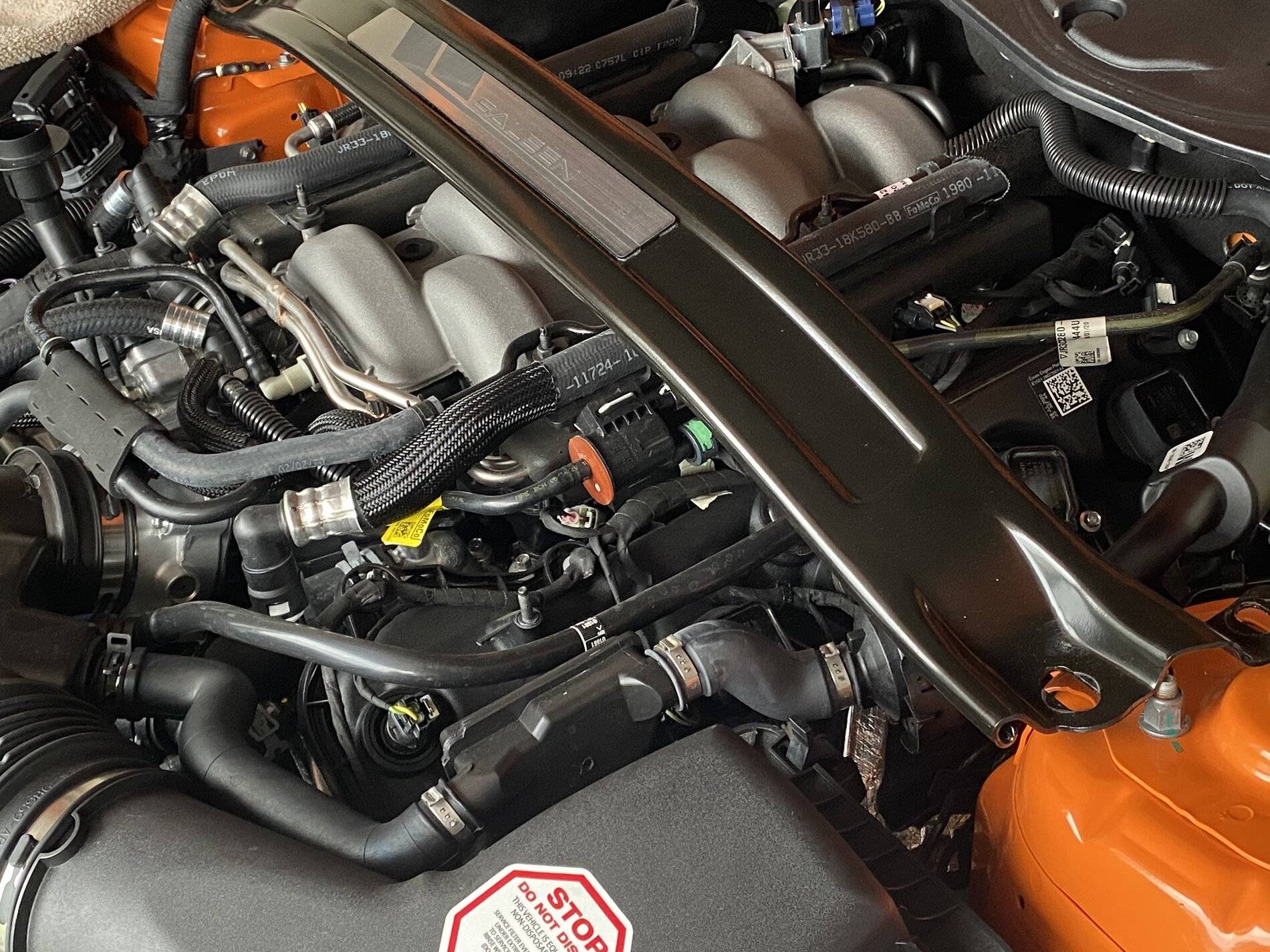

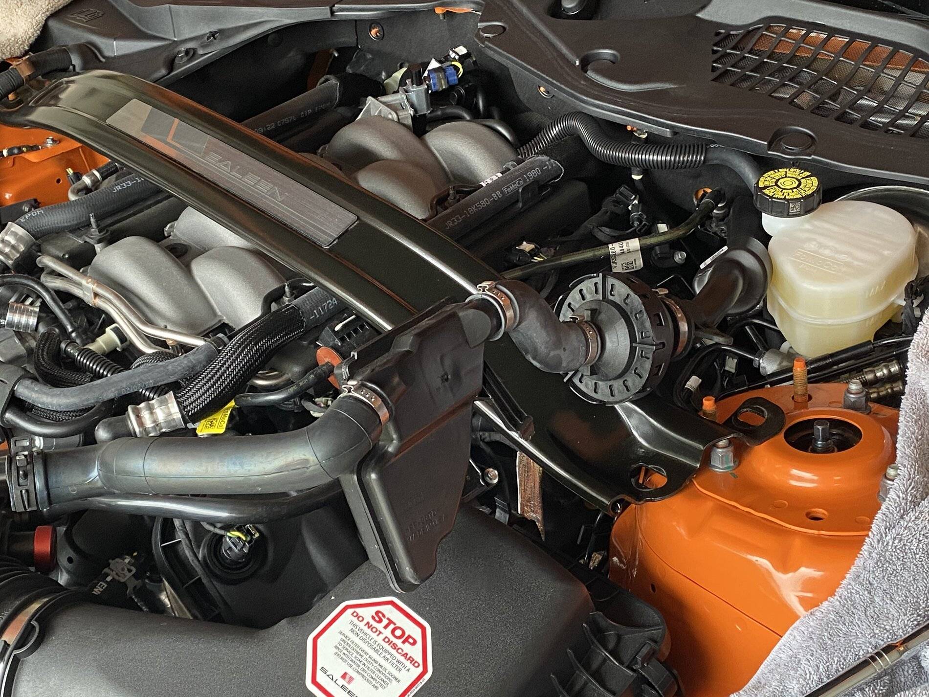

Completed the sound tube delete and installed the Boomba plugs from Boomba racing. After reading all the posts I thought it would be difficult for a desk jockey like me. Hardest part was removing the strut braces and engine cover. I never got to the 10mm nut. As I was reaching in past the sound tube a pulled on it slightly to move it, it came right off. Plugged with the caps provided and put it all back together.
