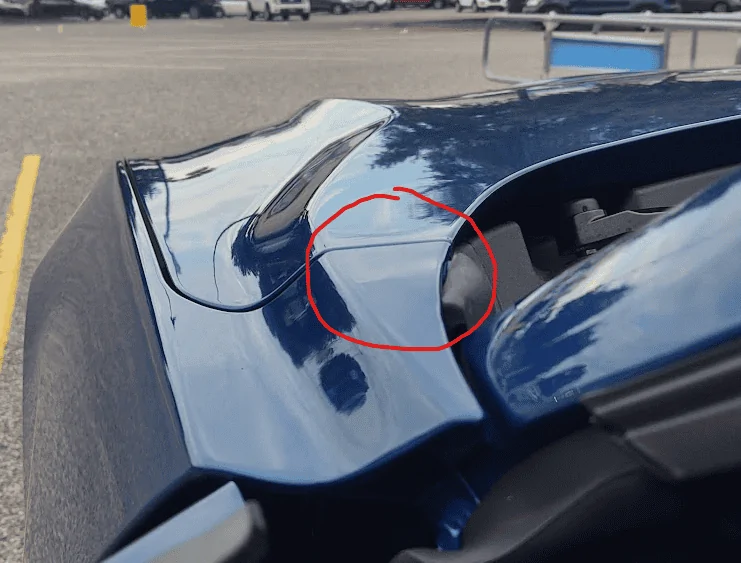

okay so today i noticed this high spot at the top of my fender. WTF you guys think caused this?

Hard to say, but looking at the panel gaps it looks like it may have been too close to the hood and been bent during opening / closing of the hood.

the gaps are perfect. you don't see the distortion in the metal?

No that panel gap is actually quite close to the fender. Ford is known to have some of the worst panel fitment in the industry. Its possible it bent it as some point, or its entirely possible that something fell and hit your car and dented it slightly.

instead of calling me a liar try another theory.
its not a dent, its a high spot, if you guys don't know what that means google it.
that's why its weird.

Do you have hydraulic lifts. I've had that happen on a car when closing the hood manually and hydraulic lift failed and I bent the hood​

yeah i've seen that too. this is inside the fender and all the gaps have plenty of space. plus no paint is damaged anywhere. its as if someone pushed up from the inside of the fender.

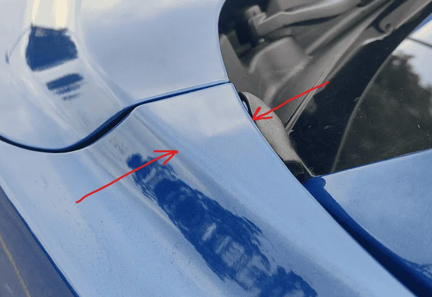

Here’s the problem. Directly under that spot is some bolt head or something like that. If any pressure is applied to the top of the fender, the aluminum bends from being pushed up by it from below.

that's kind of what i'm thinking. at this point I shouldn't be surprised other loud people on this forum can't see how an inverted dent with no metal to metal contact is weird but here we are :D

Have a good PDR guy look at it. Should be fixable.
