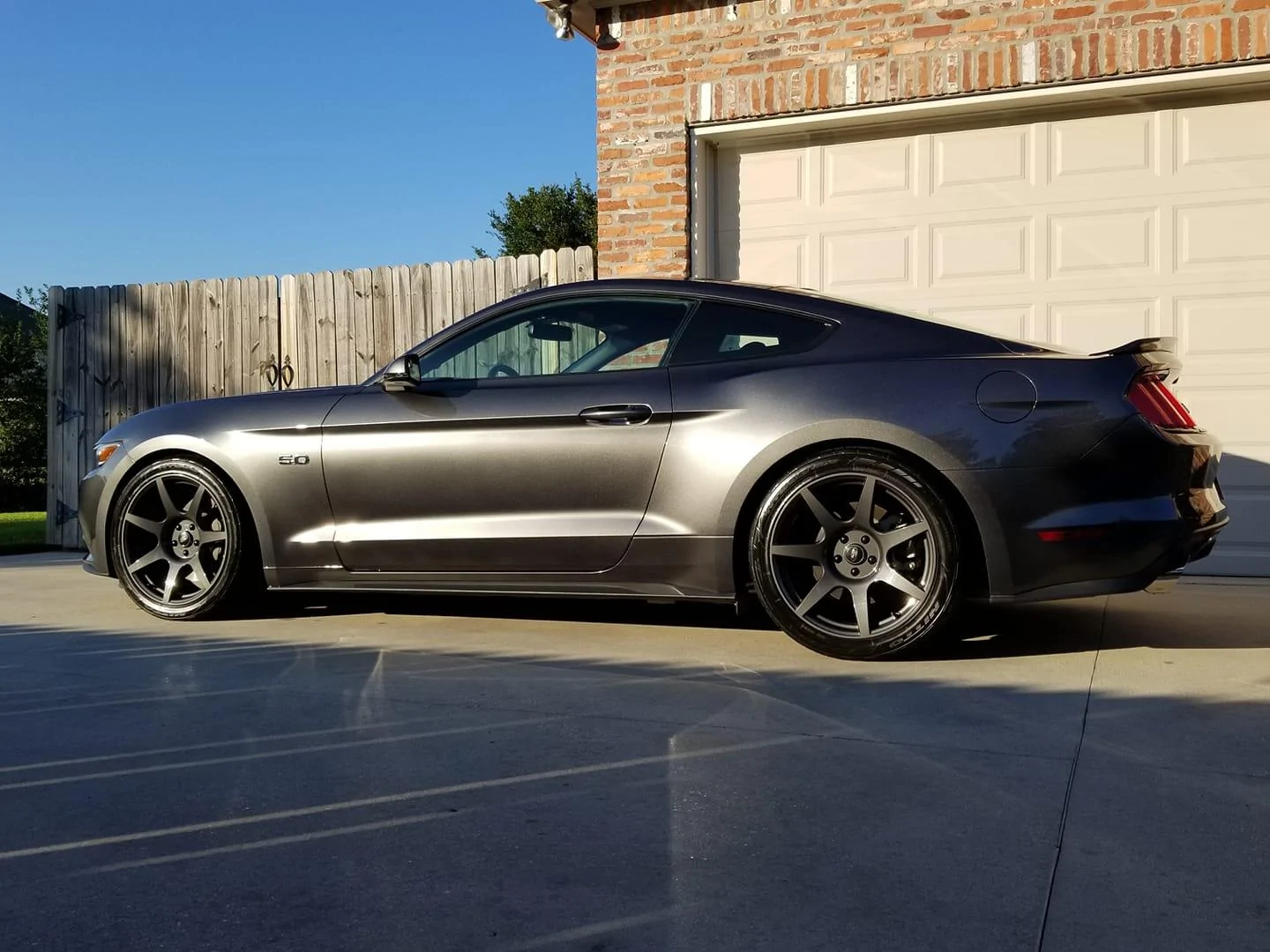

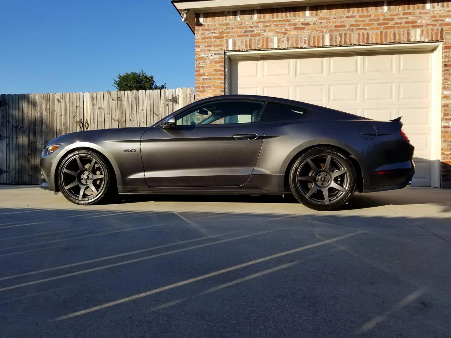

Thanks nuked. Yes we both should have approximate rear drops. Tires will affect overall distance top fender well to ground. What really made no sense was rear height increasing. I liked the stance before these guys touched it.

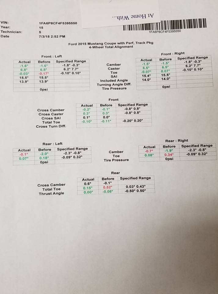

Spec sheet for the job. Any constructive input is appreciated.

Nowhere near enough rear camber. Possibly from the clocking error. Should be around -1.5 and symmetric. That could be a good chunk of your L/R inconsistency for sure. Rear toe is on the lower end of what you want, but ok. It'll probably increase a tad when the bushings get sorted back out. Front camber looks good, but I'd like to see that front toe be more symmetrical and positive rather than negative if it's not 0.00 each side.

Front camber and rear toe look great. Front toe is a touch out, my preference is a touch in (.06 to .12 each wheel). Credit to your shop for getting nearly flat zeros on rear camber, though having some is preferred on a daily driver.
In the end, I don’t see anything on this sheet that would cause uneven ride height in the rear.

Also that nearly positive camber would have a significant impact on tire to well measurement, as well as the 0.6 deg difference between the two giving a L/R offset difference.

So the shop that did the work wants to charge me $100 to re-index the bushings. Rambles on about my suspension not being stock. He cannot account for how the ride height increase after I showed him no camber change in front and ride height increased 1/8 inch. Also the front had already been re-indexed. He could not explain this discrepancy. I'm bringing it to another shop. A big thank you to Steeda Tech and Jamie Bell with Steeda. Also a shout out to Brian BmacIL. The information and guidance all of you gave me to figure this out was extremely helpful.

Everything was lined out by AMR automotive in Baton Rouge. My stance is back, tires are in the fenders, and ride is much better. BmacIL your alignment specs were very helpful. After they reindexed the bushings it dropped 2-3/16 inch. Adding negative camber tucked the tires. I thank all for their input. I'm a little wiser when it comes to suspensions now.
