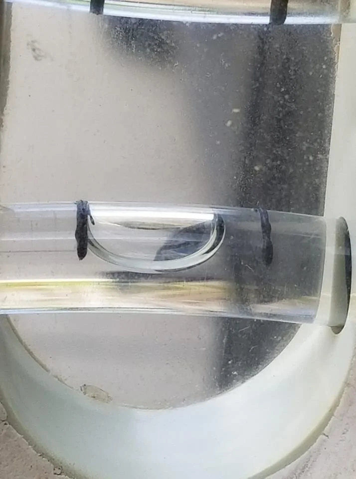

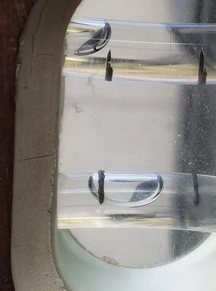

Fwiw, mine has settled over time a bit too. Per our conversation last night, the most effective way to fix the L/R is to shift the subframe. The only way it would be camber is if they were way off left to right (like 1 full degree difference or something of that magnitude).

Does this look possibly like a degree or more? Man I wish I had gotten the sheet. Top is passenger rear which looks right. Bottom is driver rear and sticks out 1/4 inch more than passenger.

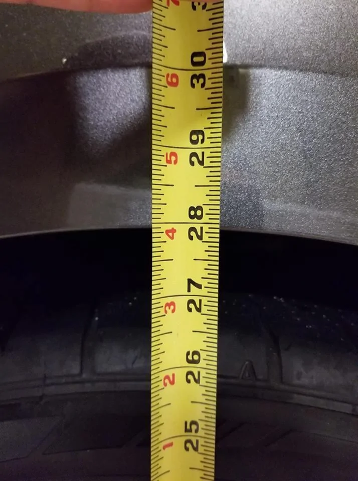

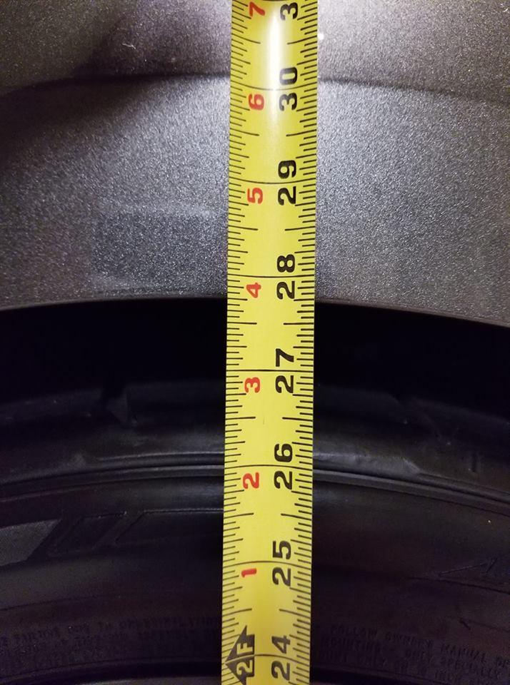

On another subject since reindexing the bushings wheel gap has increased. My spring drop is minimum 1/2 inch so any increase severely negates any gains. Top photo is driver rear prior to reindexing bushings/alignment. Bottom photo is driver rear after reindexing bushings/alignment. I understand camber can make a difference in wheel gap. But both sides increased. driver rear around 3/16 inch and passenger 1/8 inch. I greatly appreciate the input.

Steeda makes subframe alignment pins which will handle aligning your subframe. Everyone who has posted above surely knows about them, but curiously failed to mention them. Figures. Additionally, I would ensure your bushings were clocked (indexed) with the full weight of the car on the wheels. This is only feasible to do on a drive-on alignment rack-style lift or by placing the car on very high wheel stands.
Finally, every single Mustang - surprisingly so - seems to react differently to lowering springs. My car, regardless of who's made the springs that have been installed, tends to settle more in the rear than I'd prefer and that I expect. A friend who had the exact same springs as me at the time had the exact "stance" I expected on my car.

I am limited knowledge on suspensions. But if bushings are properly reindexed I find it hard to believe the fender gap increases 3/16 inch. Hell my rear drop was only 1/2 inch. That's almost half of the drop. My thoughts are they did it wheels dangling. Not on ramps. That's the only thing that makes sense.
