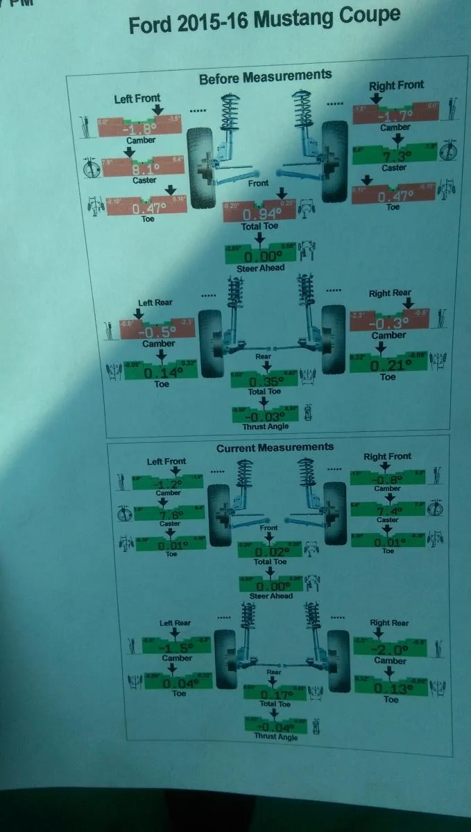

Alignment is back in spec.

Maximum motorsports caster camber plates with eibach sportlines. Alignment tech hates me but LOL. This is my tape measure vs the alignment machine.
Going to have to go back and see if they will do custom specs instead of factory.

Looking this over again and taking another look at my suspension geometry. I'm going to have to go back and explain to them why factory specs are not ideal when you lower the car 1.5". It works on an arc and if your resting point is on a diffrent part of that arc the tires will not move the same way. Damn I should have left when I had to explain how caster camber plates worked.
