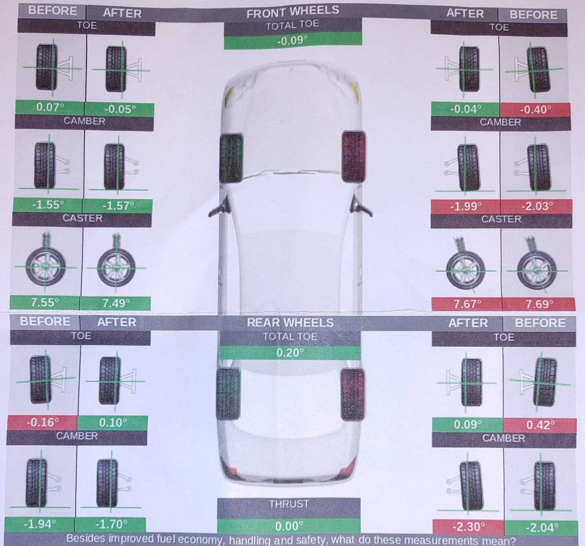

Just got an alignment done on my GT and want to make sure these numbers are ok. Seems odd to me since I've never seen such a discrepancy between each side. Tech said there isn't a way to adjust rear oem camber but I thought I read somewhere it's possible? I'm told the tech is very experienced and works on a variety of different sports cars etc.
Front camber: left -1.57 right -1.99
Rear camber...left -1.7 right -2.3
Suspension mods:
BMR performance springs, drop 1.2" F 0.5"R

Experienced or not, it looks like all the tech did was adjust toe. Rear alignment on these (and many other cars with any sort of multilink arrangement) can become a matter of chasing one's own tail going back and forth between toe and camber adjustments.
On the rear suspension, adjusting toe will change the camber readings, and the toe adjustments there indicated by the toe numbers (including sign where + = in and - =out) do make the before to after camber readings look reasonable. I don't trust the graphic for RR toe using standard toe conventions.

Yeah, you can absolutely adjust the rear camber (but not the front without additional parts). The bolt is not marked like a normal alignment adjustment but its in a slotted hole and it can be adjusted.
As Norm says there is crosstalk between toe and camber adjustments in the rear so its a little annoying to fiddle with.

I think there was some laziness going on. Rear camber is a major pain to do! Theres info in the alignment program that tells you what to adjust for camber and toe

Per the Ford shop manual, the upper hole in the strut can be elongated to allow for front camber adjustment. I wouldn't expect that to be included in the regular cost of alignment. The easier method would be aftermarket camber adjustment bolts, a the best method would be adjustable camber plates. He definitely got lazy on the rear camber, but I'm also not sure that's within the scope of the basic alignment cost.
It's really not such a pain. It acts like damned near every other suspension on every other street car. Work back and forth adjusting camber and toe while keeping some sort of chicken scratches for notes. 3 or 4 iterations is all it should take. If rear camber is taking 1/2 a day to set, then your problem is the mechanic, not the car.
