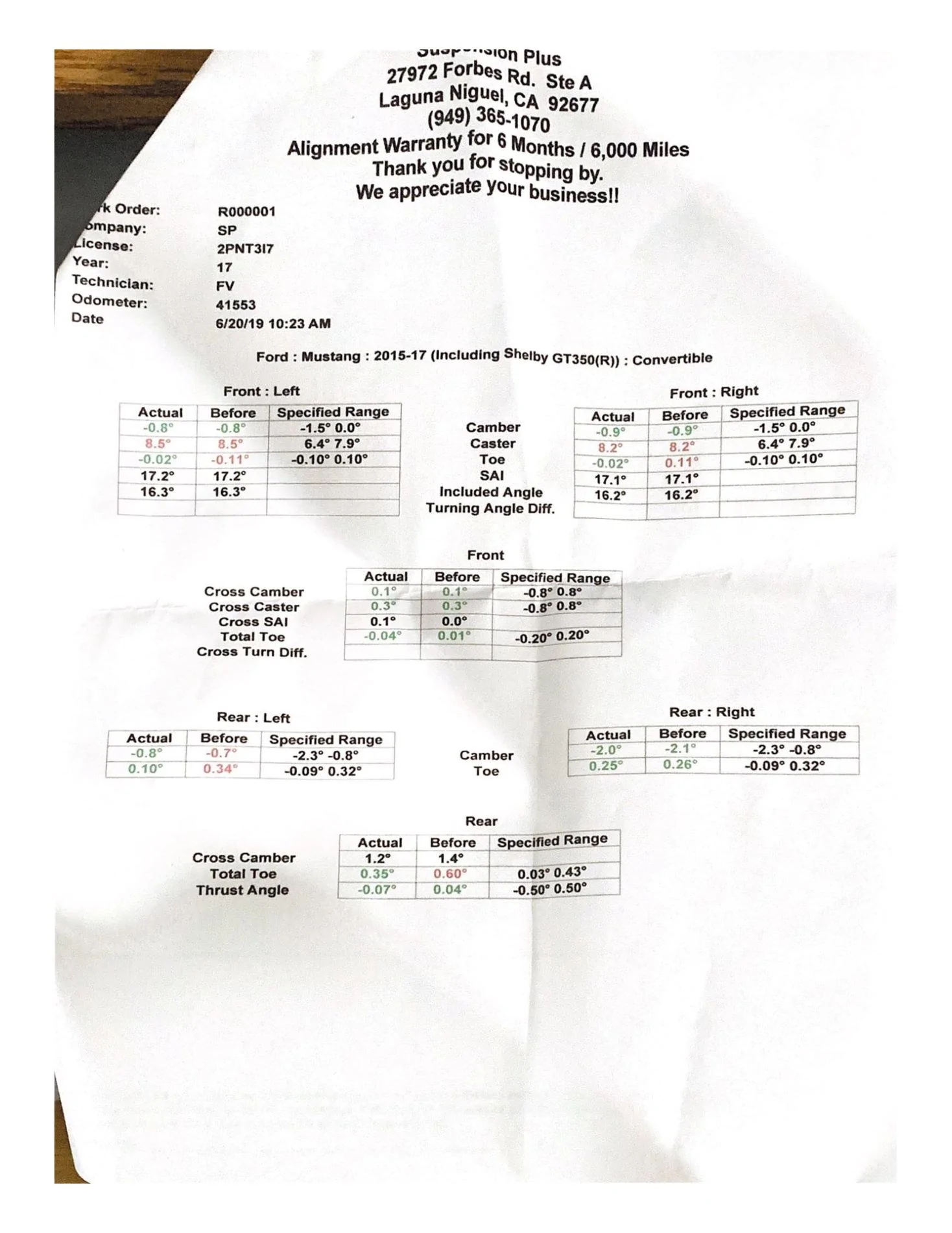

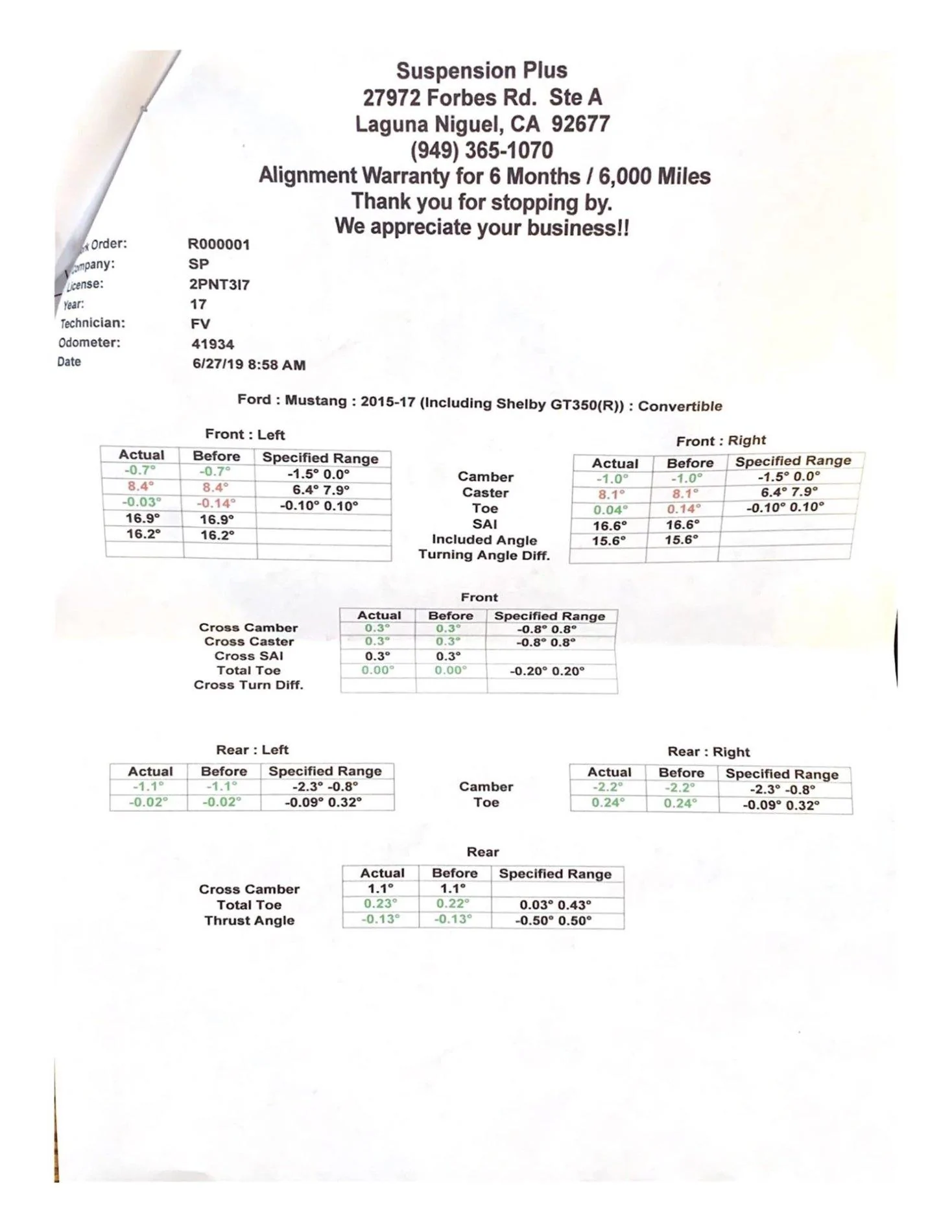

Alignment sheets:

And this is why I say 'in the green' is completely meaningless.

@Roadway 5.0 appreciate the input!
Is the cross camber value high as well? I have seen less than .5 on our vehicles with similar setups?
Your front isn’t bad, and of course you’ll need plates to have perfect symmetry anyhow. The rears are pretty off — good thing is that a skilled alignment tech can adjust these to be more/perfectly symmetrical. I’d shoot to match the -1.1 in each considering your front camber is so mild.
Make sure they fix your rear camber, not just the toe. A lot of alignment techs don't know where the rear camber adjustment is on our cars and think its fixed. It is not, they just need to get an education. That much rear camber discrepancy between left and right will cause your car to always step out to one side when you break traction with the rear tires, even if your toe is symmetrical and good.
