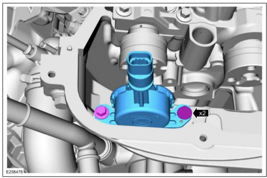

The only thing I can think of that could be making racket is the intake VCT oil control solenoid.
Maybe some of the old RTV I removed found its way into the oil pan and is clogging this thing up? Although I’d think it would be throwing a code and running rough if that were the case. Just spitballing here but where it’s located sounds exactly like where the noise is coming from.

I pulled off the LH valve cover and noticed the VCT Solenoid’s (pictured in post #8) electrical connector had a ton of play and thought that maybe it got broken while we were moving around the front engine cover. Fast forward a week later and a replacement comes in the mail that has zero play. Excited I rush and throw in on the car tidy everything back up and to my disappointment find the car still makes the noise.
